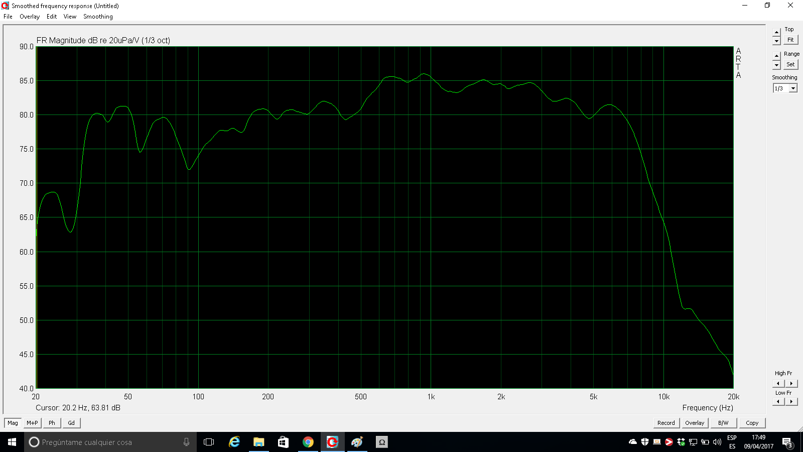

SEAS measurements without filter in box.
Near field
50 cm
Near field
50 cm
*pir files
SEAS 50 cm

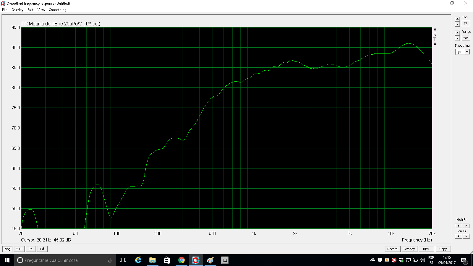

As commented, by manufacturer data it seems hard to believe that the SS is about 5dbs more sensitive as the seas...🙄

How many dBs do you want the SEAS?
SEAS 85dBS @ 2kHz up, please tell me if ok to upload *.pir & *.txt files?
But what's happenning with these levels? 😕
I do not want anything special, you are simply expected to measure each driver from the same distance and at the same level, ie, without changing the level...
I'm avoiding to clip the soundcard and protect the tweeter.
I was expecting something similar...😡
So make all 3 measurements at the level you have performed the tweeter's one. If you don't you will never be able to adjust channel levels at the xover. You need a fixed refrence to do that in the CAD tool.
And forget about the nearfield one: no sirve pa' nada, nothing!
I really don't understand what you're doing that for... The result will be flawn by these unnecessary changes...🙁
Wrong data: Missing phase!
