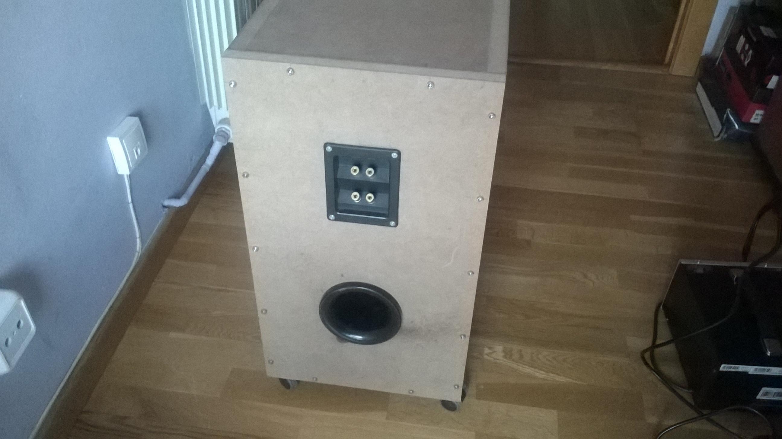

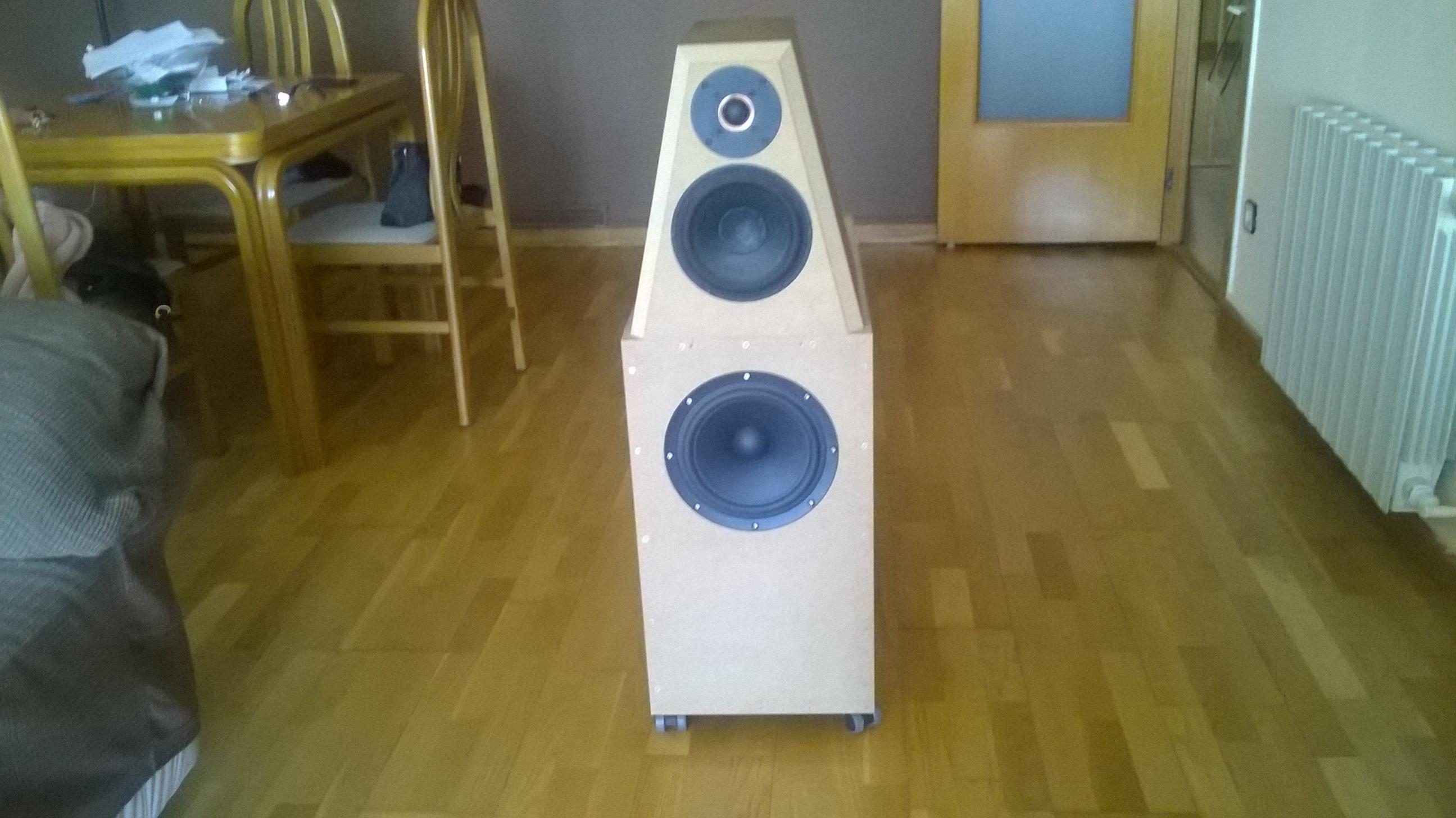

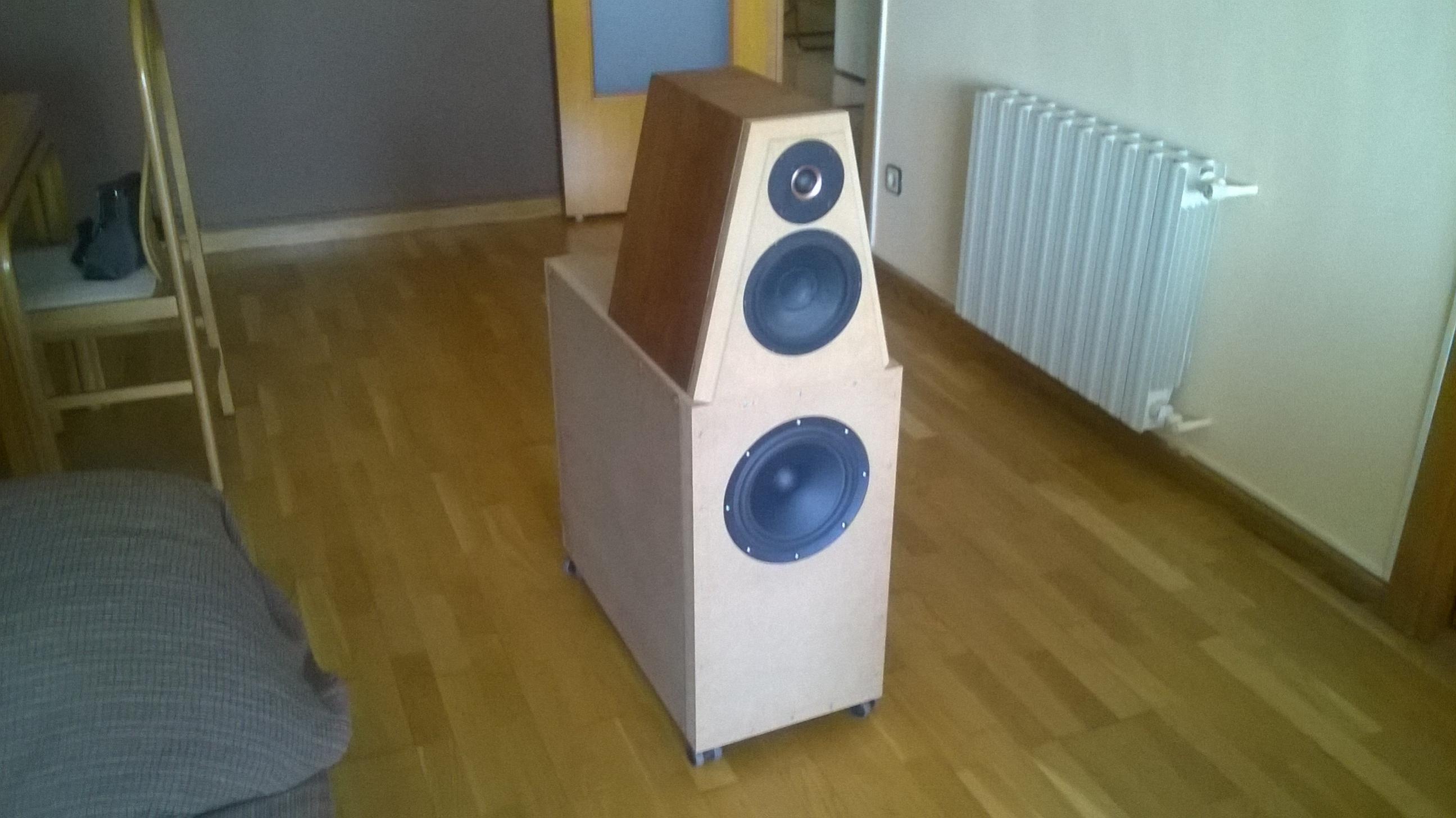

Joined 2009
I got a quad of the 12-ohm version when they were on sale. Two of these wil fit very nicely in a 45-50 litre closed enclosure.
I'm skipping on some of the design work, and shamlessly steal the 49 litre enclosure from the David/Jericho watt/puppy clone, and just omit the bass reflex tube...
For bass reflex, this cabinet should do nicely with one of these woofers...

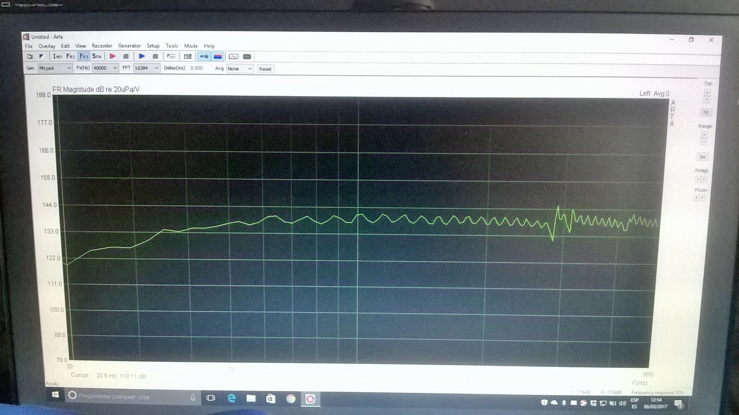

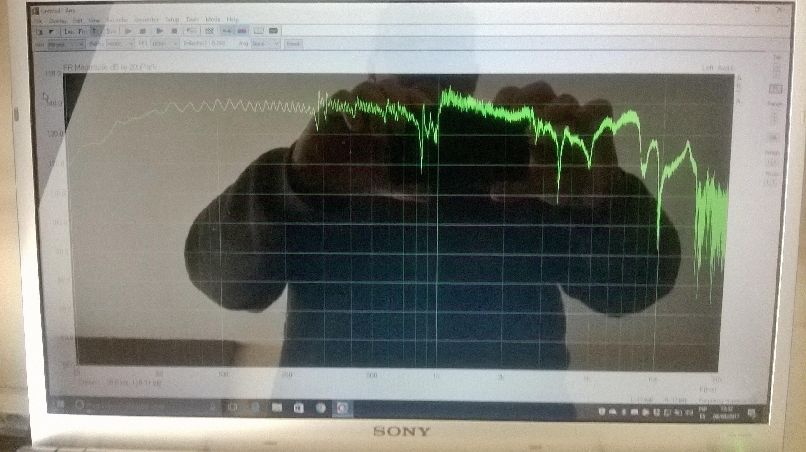

Finally decided the xover point to 250Hz. The two ways to be married with the woofer are midwoofer Scan Speak 18W8545-00 + Seas Millenium T25CF002 tweeter both filtered.
Two way filter Seas Millenium T25CF002 + Scan Speak 18W-8545-00
file.php
FR near field with filter connected tweeter & mid woofer
FR near field only mid woofer Scan Speak 18W-8545-00 with filter connected, n.b. phase inverted.
