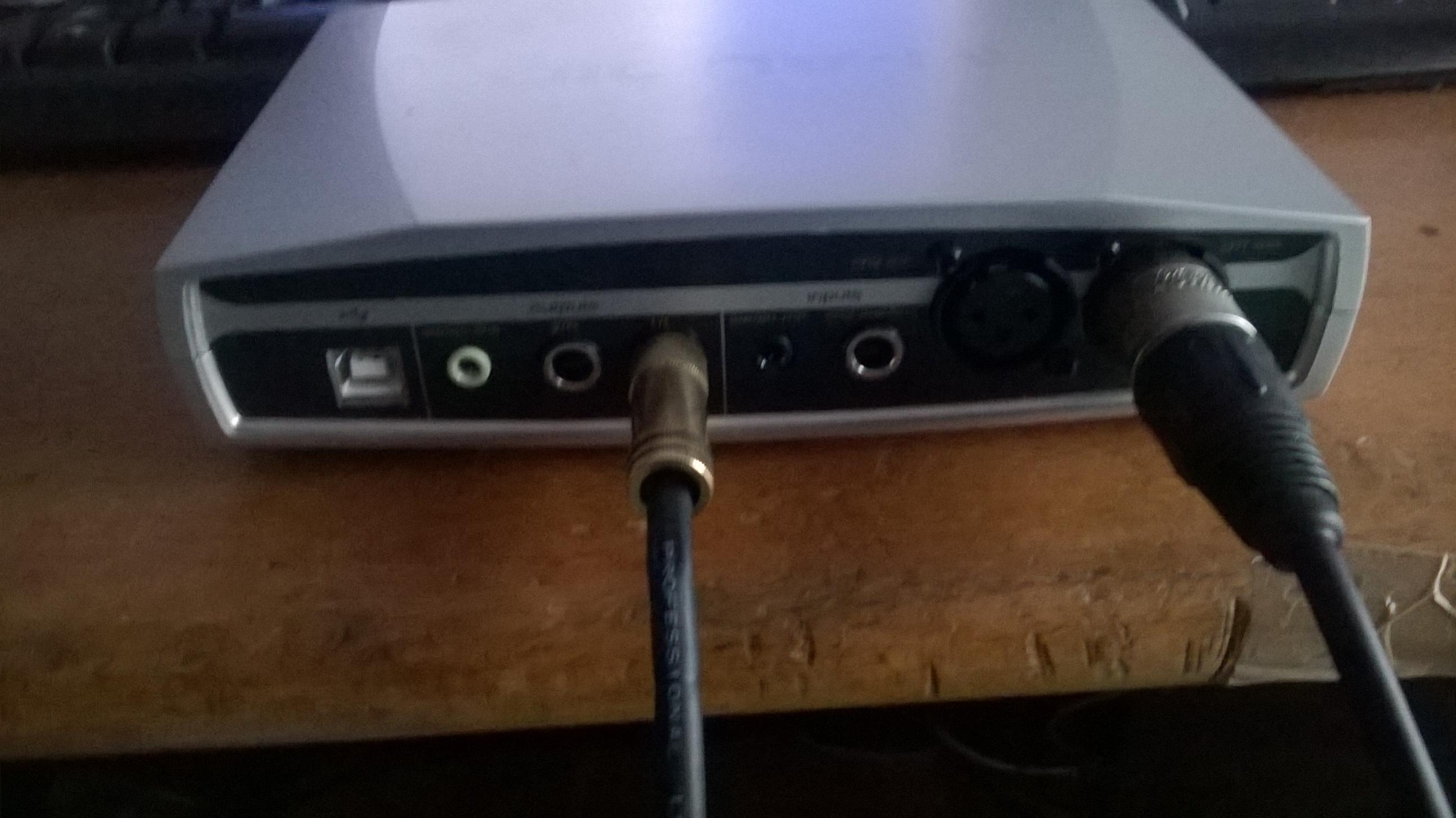

No no, mic inputs with Limp: NOOO!
The XLR connectors are MIC inputs, while the Line/Inst inputs are jack connectors.
I don't think you can use a Mic Input for one channel and a Line Input for the other one. Maybe it's what makes the calibration derail. You must use the 2 Line/Inst Inputs. Check the manual!
Btw you have only measured one channel, and you need to check both.

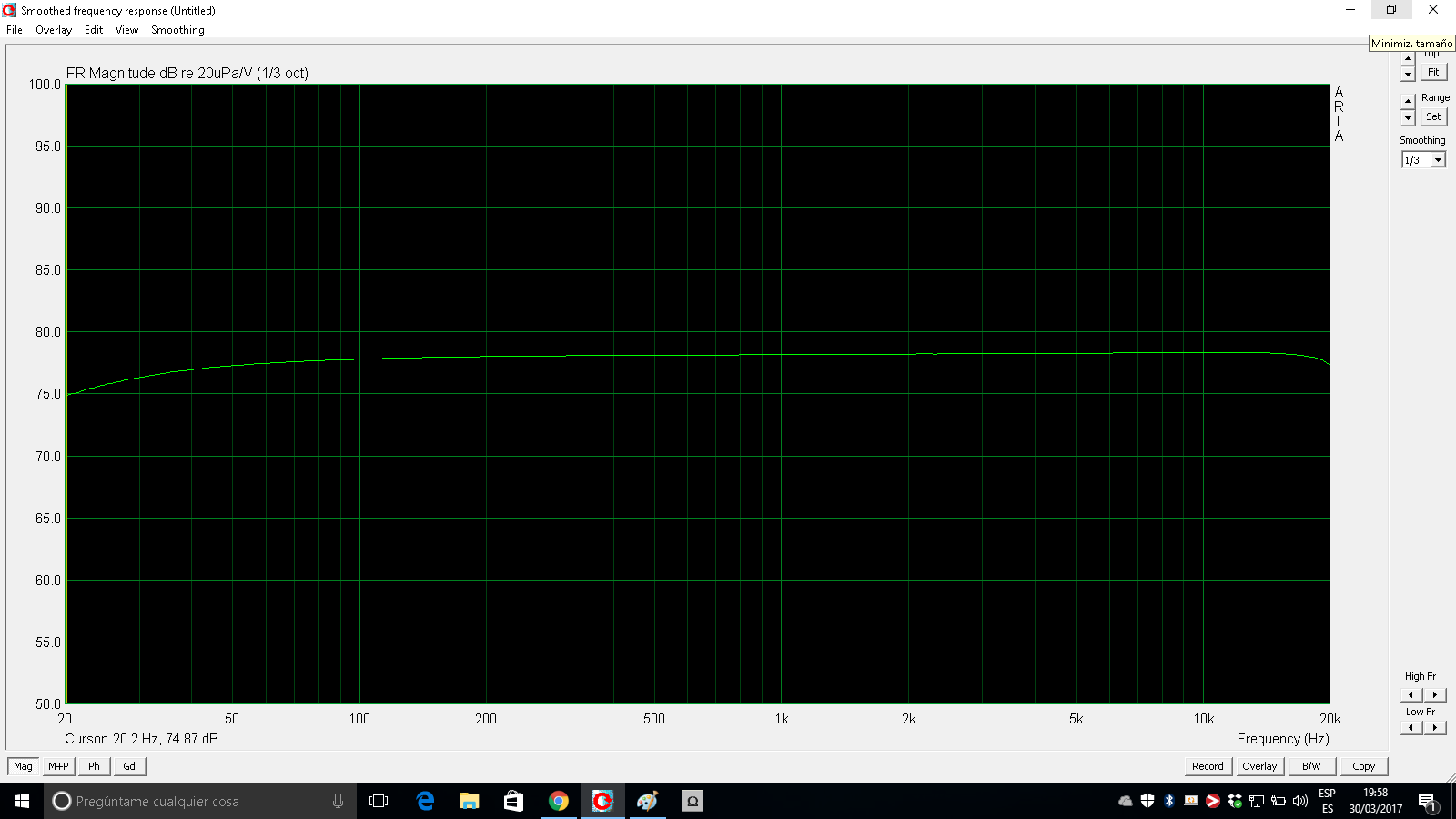

Yes i know it's with Arta: we are checking with Arta the FR of the inputs that we suspect are causing problems with Limp...
Question is Mic input cannot be used with Limp: too low impedance.
Did you use a mic input with Limp?
Merlin keep ghost busting if you like, but why not try to calibrate with Limp again and let's see what's going wrong?

No need to use a power amp with Limp, unless you wish to perform T/S param measurments at high excitation levels. For standard measurements at 100mv or alike the phone outputs of the uca202 are enough, and for measurements at 1V or similar i use the more powerful RME fireface uc from its headphones output.
No power amp needed for any small signal measurements and above.

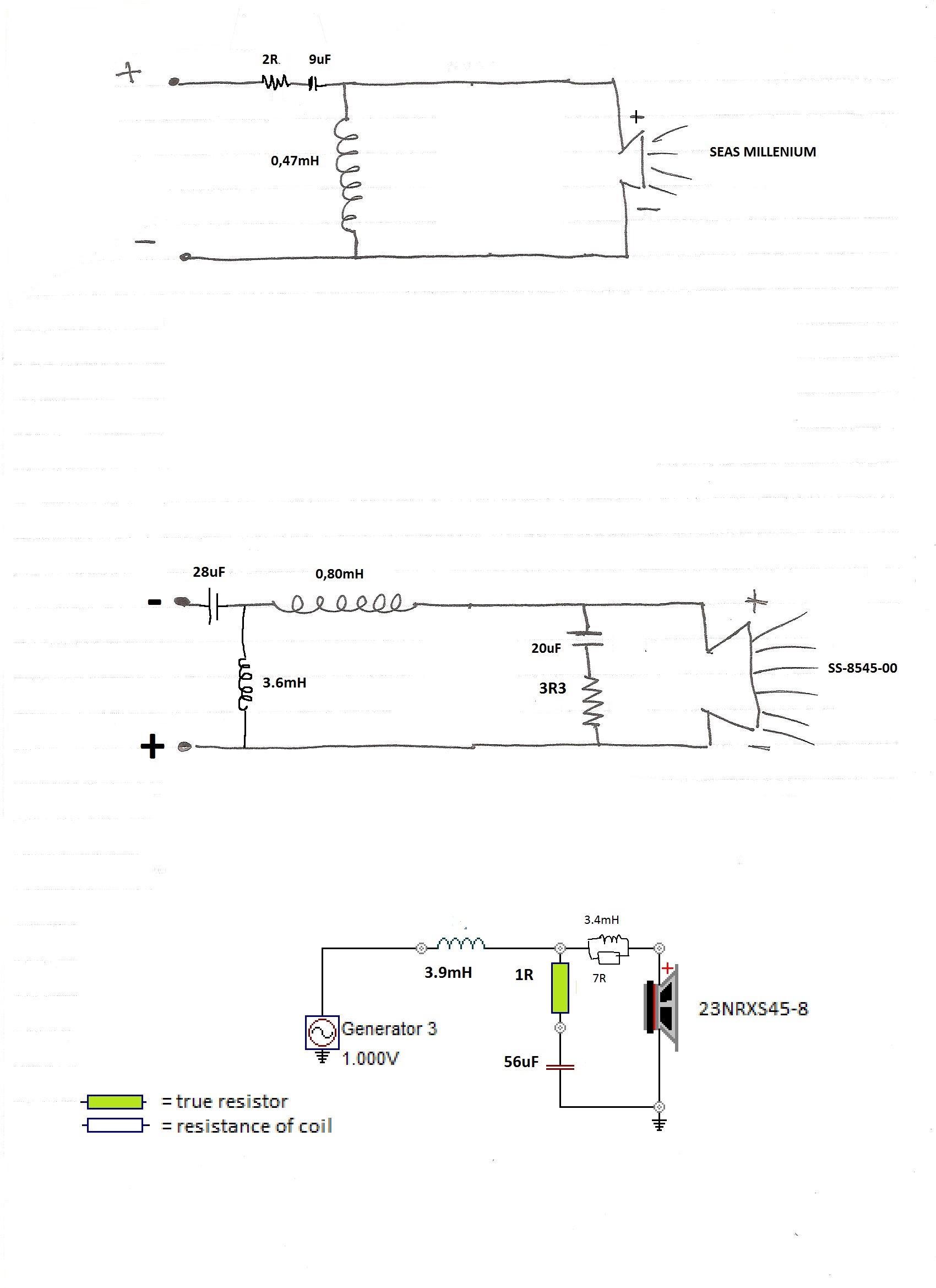

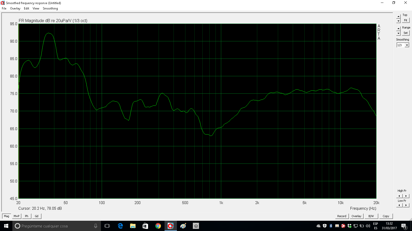

FR all loudspeaker mic 1 meter + high pass filter 500Hz for SS8545 in green without high pass filter 500Hz for SS8545in yellow mic situated in th middle of all drivers.
Any suggestions to improve the xover?
mic same position yellow SS8545 green SBA
Doesn't look bad at all...
Now consider that under 1khz measurements made in room at 1 m, with drivers close to the floor, back wall and side wall need to be interpreted rather than taken as the holy bible...😀
The big bump around 1khz is probably due to wall reflections, but what you see is extremely dependant from the position from which measurements are done, so that i personnally would not care too much about those things.
I would rather now move the mike to your prefered listenning position, 2m or 3m, or whatever and make the same measurements to see what your room curve looks like, as if you were measuring for DRC.
Or do you prefer sterile discussions about measurments and CAD...😀
Mic listening position 3.5 meter far from loudspeaker. This loudspeaker is in the corner, the other one is not in the corner.
ok but what xover is this? The high passed SS or the other one?
Anyway it is clear that it will be tough to get a balanced sound whatever good or bad the xover.
May be try to play some music and comment...
Also try to change SS polarity to check what happens to the deep at 500-1000hz...
And the other one?
It also seems the low pass on the SBA has changed too, and not fpr good...

I'm sorry forget to tell you used a baffle step network attenuation 10dBs 570Hz with 3.4mH and 7 ohms between the LPF and the SBA.

- Xover to filter woofer SB 23NRSX45-8
