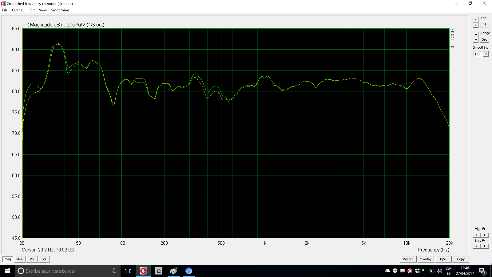

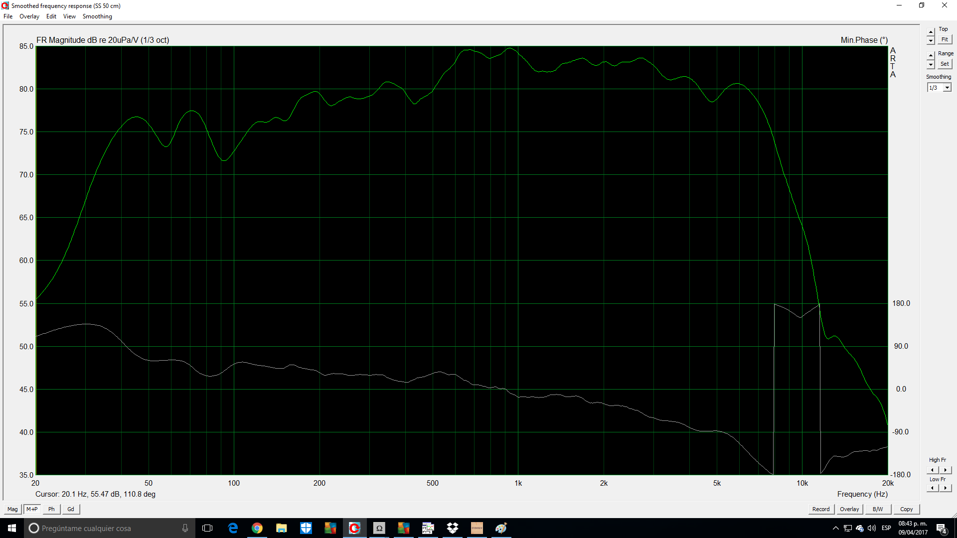

That's the ARTA image prior to convert the SS to *.txt file
I get pretty much the same with your pir.
The only thing with the pirs you loaded this morning is about drivers respective levels, and as i told you i had to raise the tweeter 5dbs to get something i might believe.
Imo the only problem is self distraction and lack of double checking each step you make...🙄
A ver si no centramos...😉
You are right, I do fast without double checking, thanks for your patient with me.

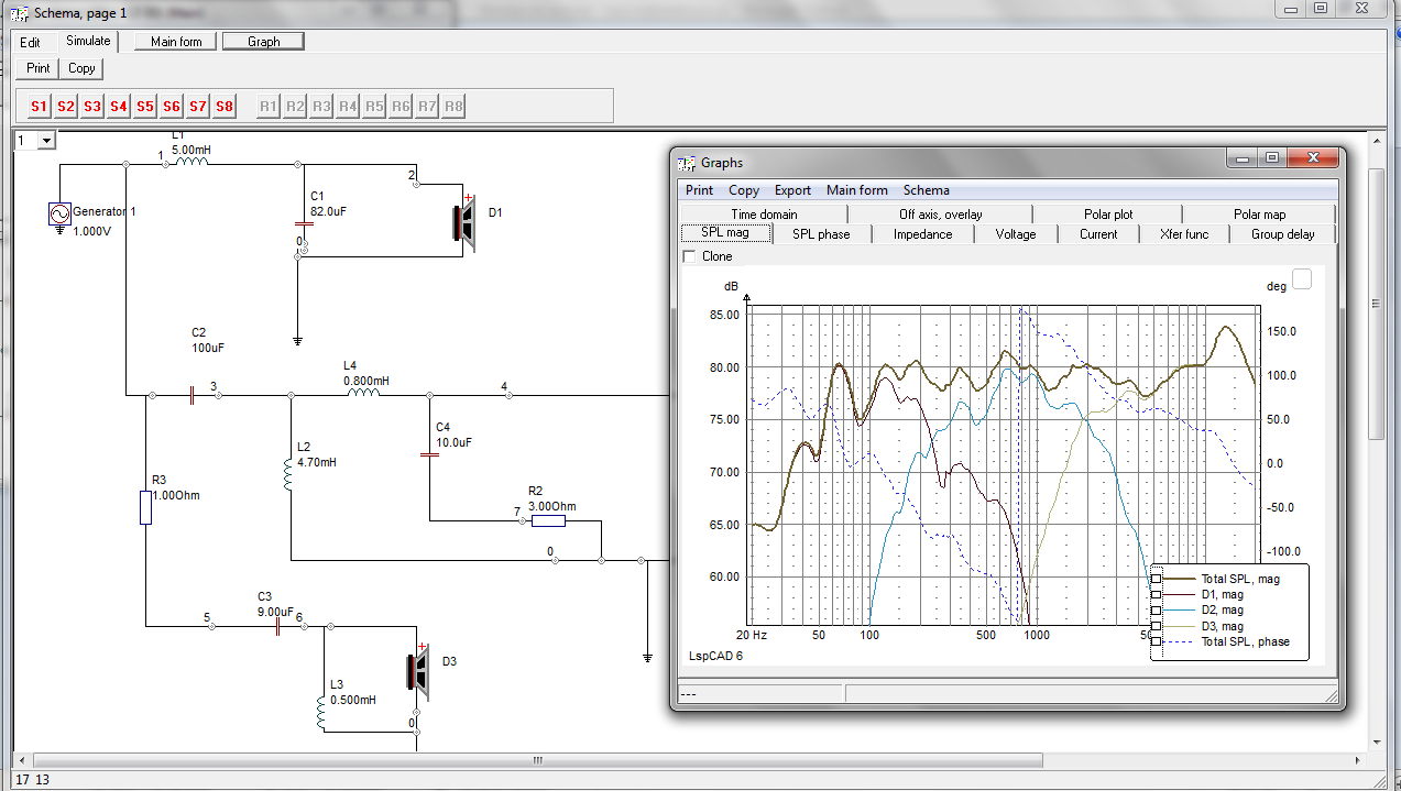

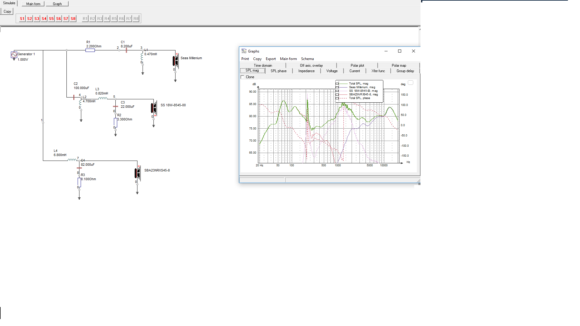

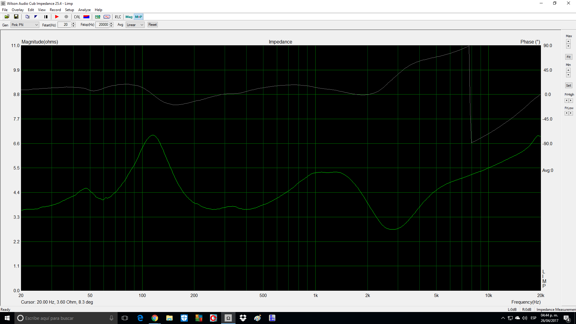

Bueno he ido variando algunos valores viendo como afectan realmente en el punto de escucha que estas situado a casi 4 metros de la caja, finalmente he conseguido esta gráfica en punto de escucha. El Seas lo he atenuado solo 1R5, el SS y el SBA no llevan atenuación. Mañana lo escucharé para hacer la evaluación subjetiva.
Well I changed some values seeing how affects really the sound in the listening position near 4 meters far from loudspeakers, finally I get the attached graph. The Seas has been attenuate only 1R5, the SS & SBA without attenuation. Tomorrow I will listen to make the subjective evaluation.
Looks clearly better...🙂
Maybe the attenuation on the weeter is somthing to experiment with...

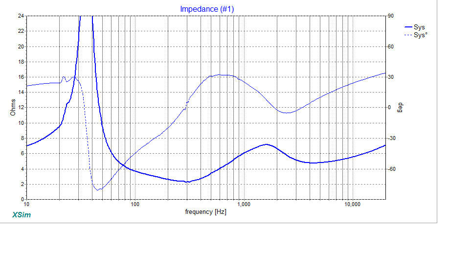

Did you check the resulting impedance? Depending on your amp it does matter, or it just doesn't matter at all...🙄
Yes the final attenuation on the tweeter will be subjective by ear.

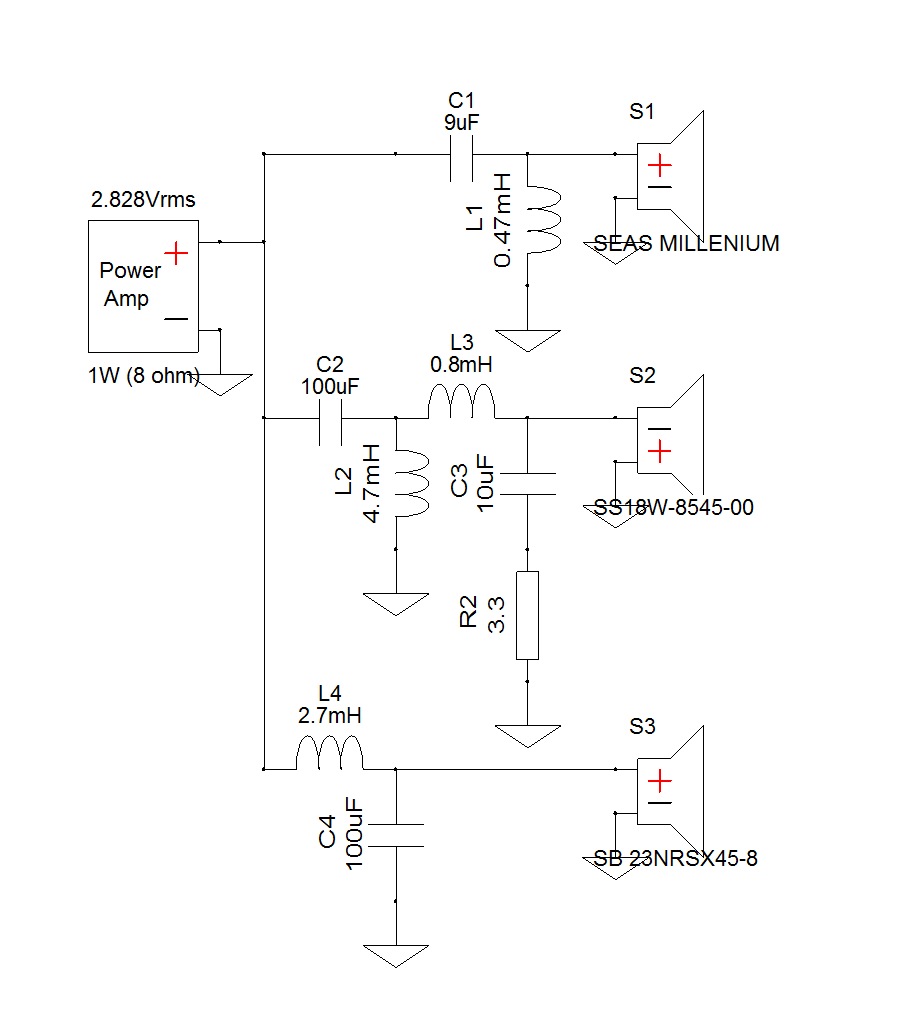

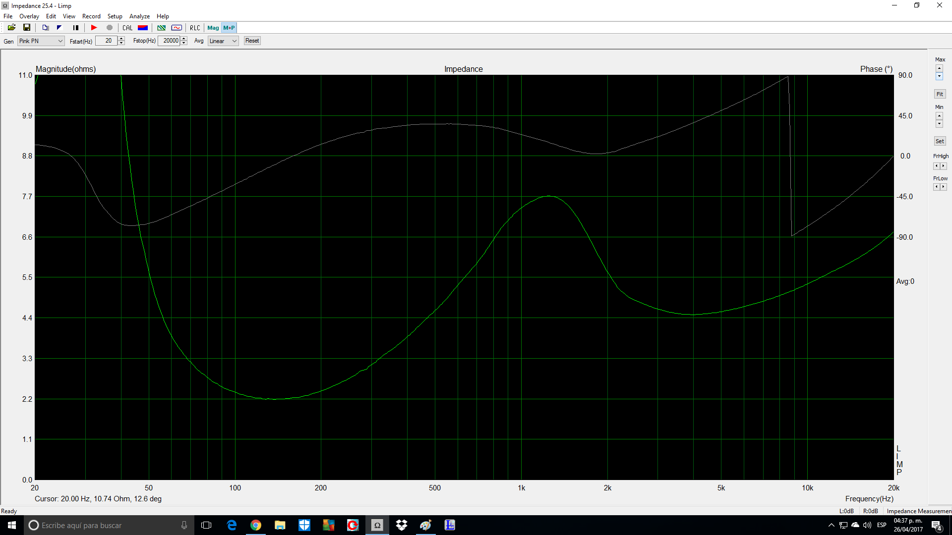

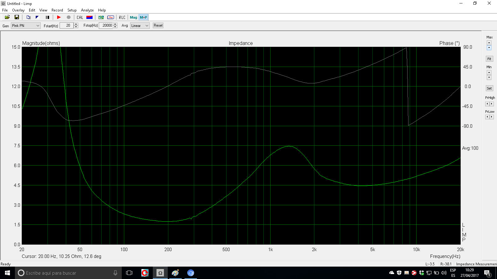

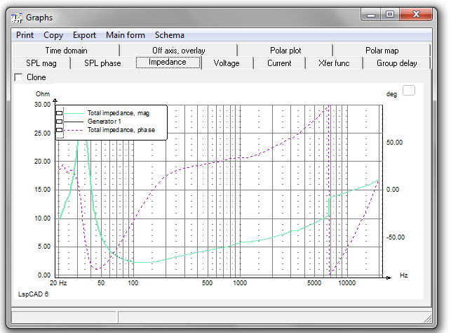

Impedance.
No free lunch: If you use a passive filter to boost a frequency area, you will get a deep in the impedance curve.😛

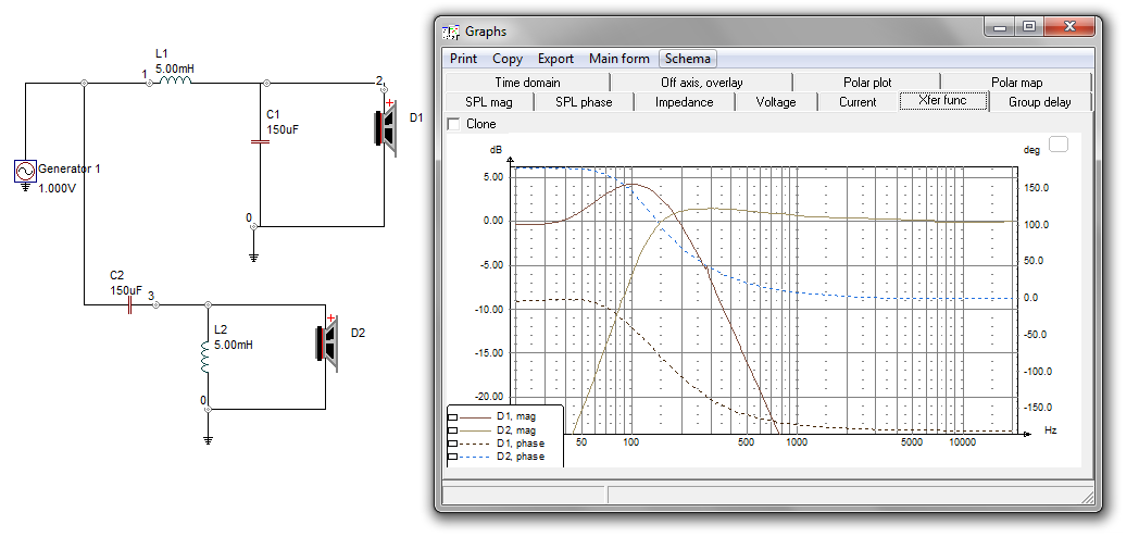

If i put L4=2.7mH in some post, yes i was mistaken... It was 4.7mh
Btw, 100uF instead of 150uF makes things easier.
- Xover to filter woofer SB 23NRSX45-8
