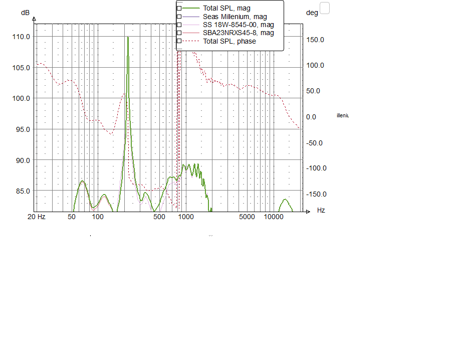

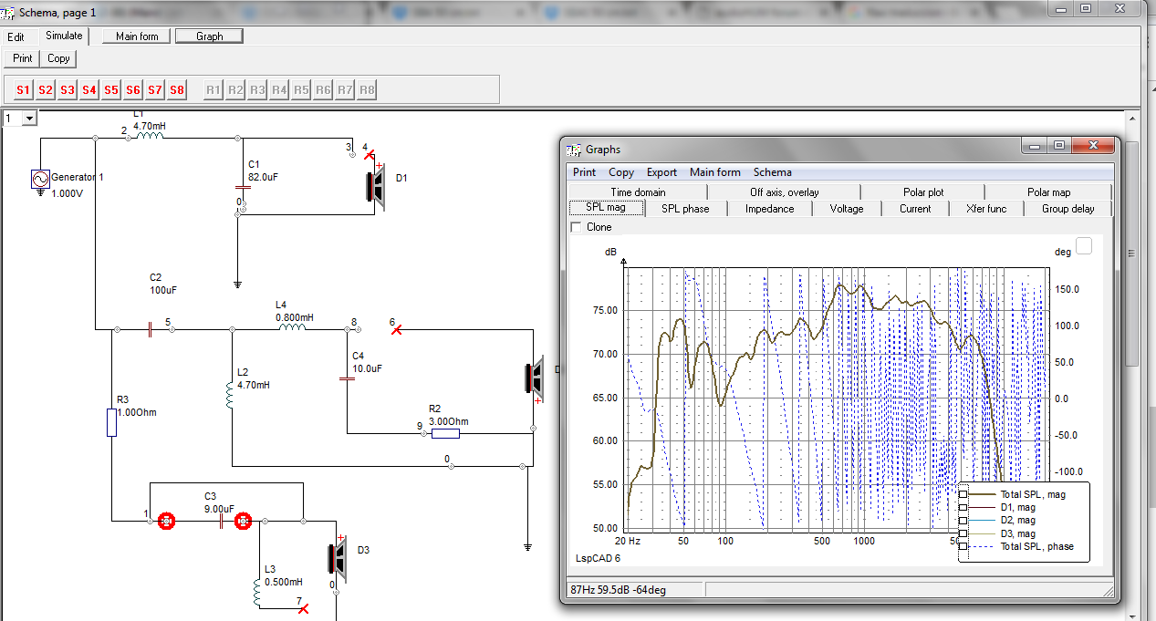

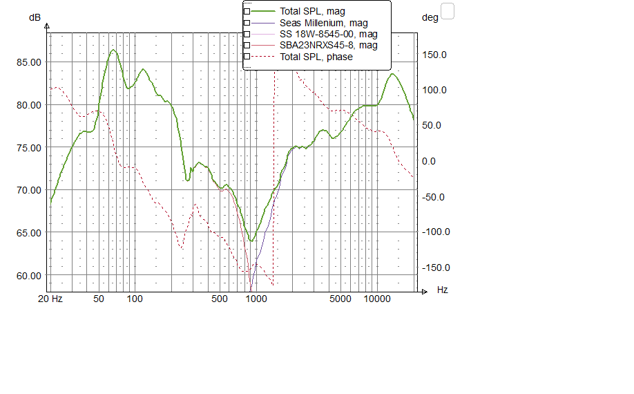

Better use minimum phase with Arta, so as to avoid to embed wrong offset/excess phase in the data.
There will always be time to add those delays/offsets when simulating with LSPCAD.

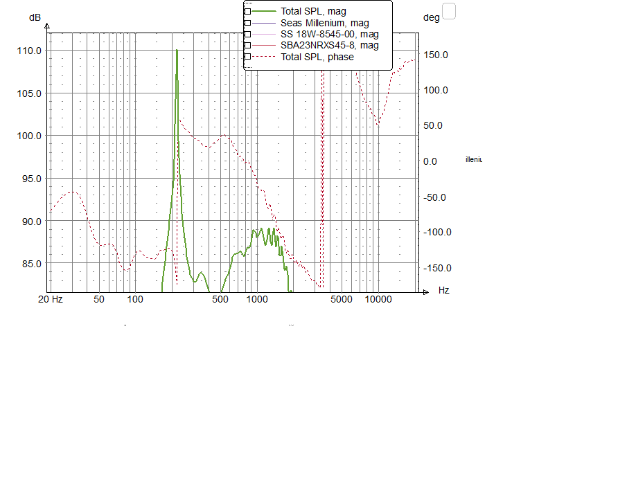

As advised your phase data are junk...
Use minimum phase instead, by checking menu View/Minimumphase before creating your data file.

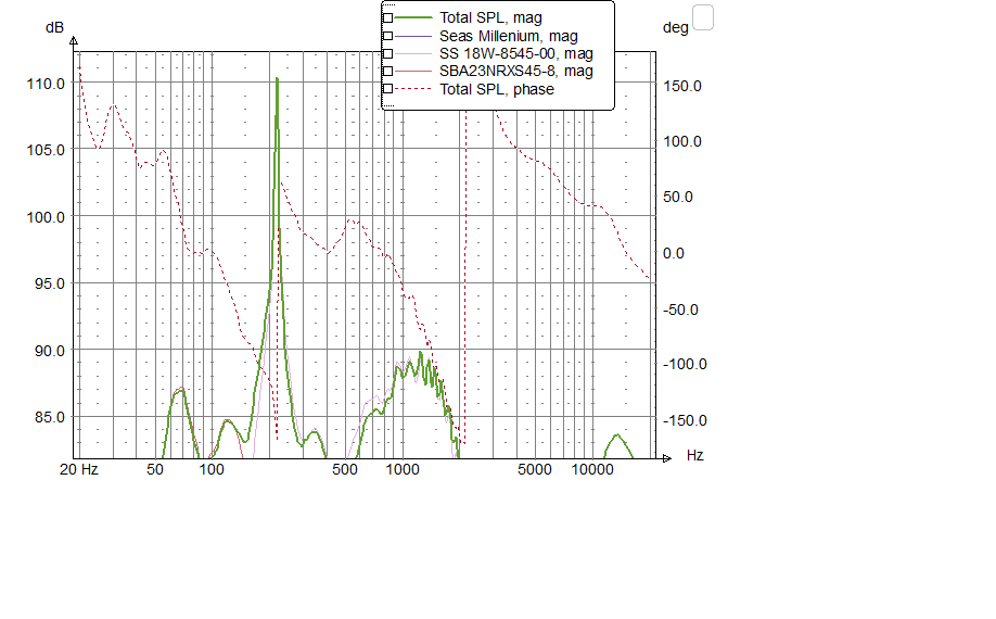

The 2nd simulation using minimum phase with ARTA shows worse results.
Your Seas file is plain wrong...😱
Before upload to dropbox I changed all ARTA files to minimum phase.
It does not matter, mine is similar.

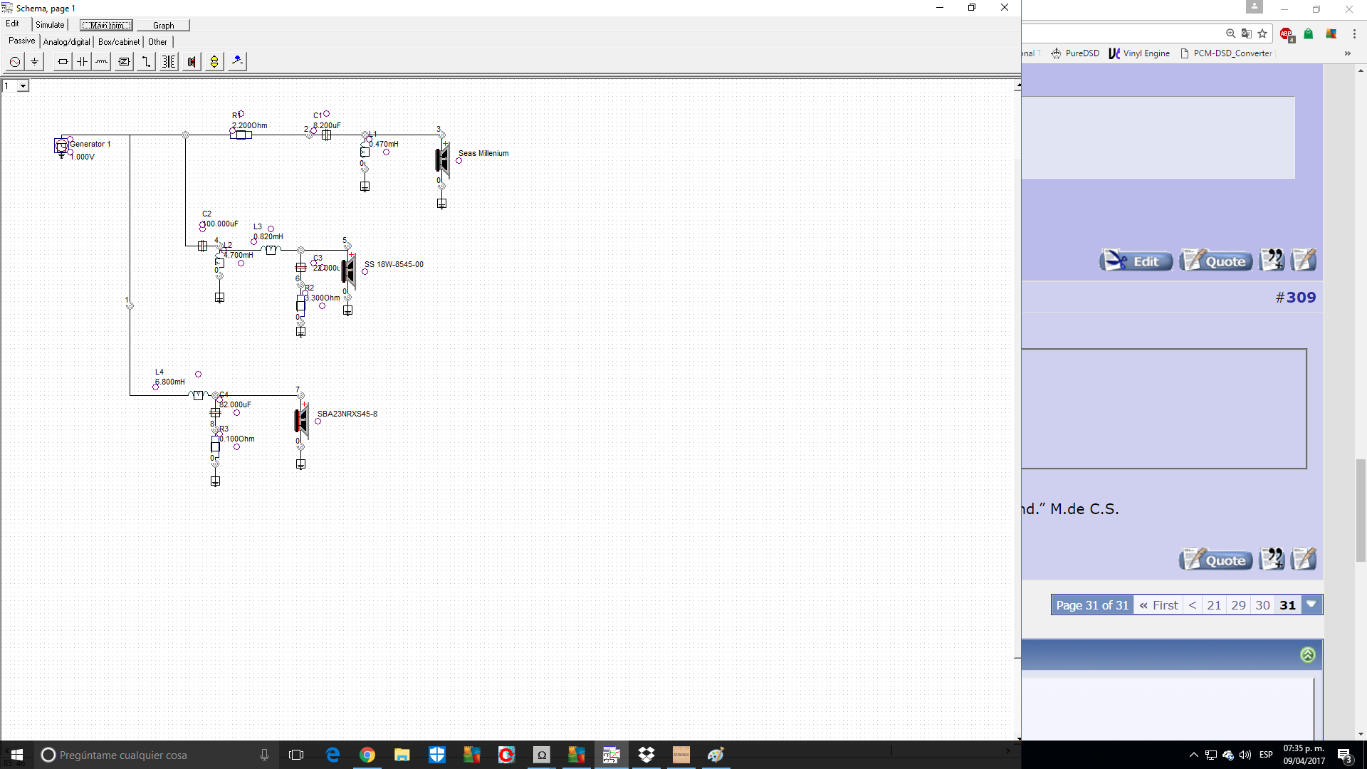

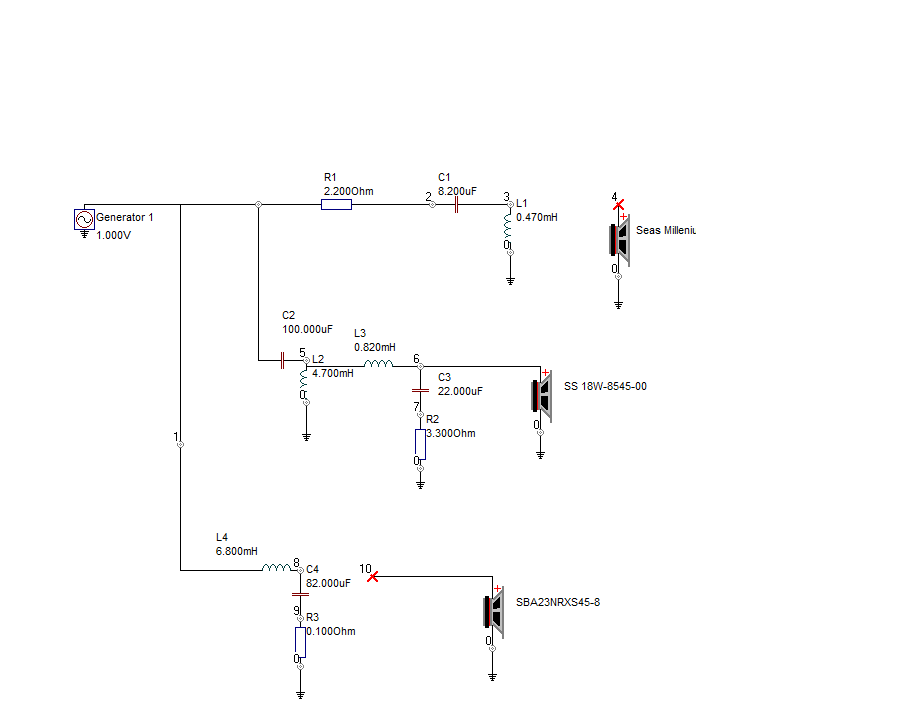

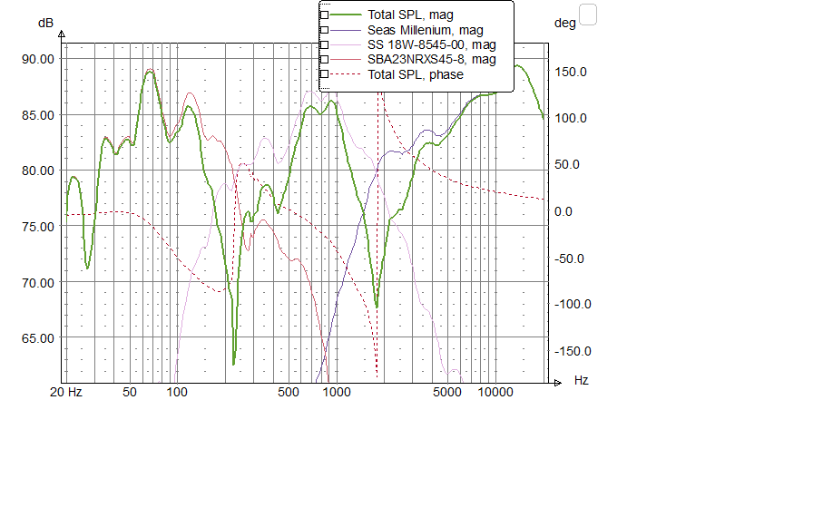

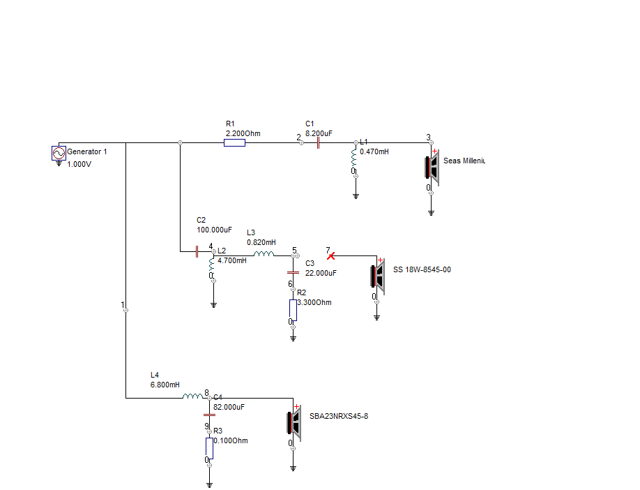

I have just disconnected the SBA and the SS to check the tweeter and it looks like you have loaded the SS data for the Seas too...
Merlin's law? 😀
Merlin's law? 😀
I'm working with two computers and sharing the information between them so can be a mistake. I'm sorry for the trouble.
Jolines Merlin, le cambias la polaridad al puto SS, lo conectas, y Felices Santas Pascuas!😀

- Xover to filter woofer SB 23NRSX45-8
