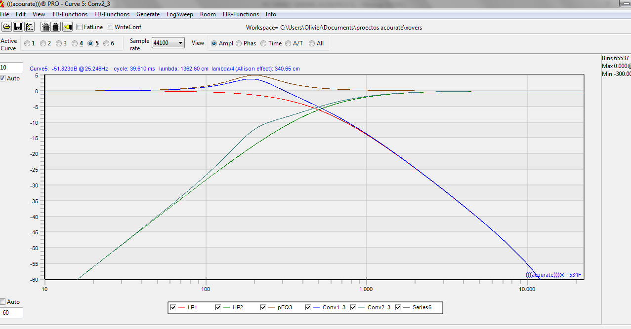

The process we are trying to follow is modifiying a standard LR12 around 400 adding the necessary Eq(s) so as to match a target room curve at the listening position.
It does no longer matter at all if the resulting filter matches or not a text book LR xover, nor gives a flat anechoic response, what matters is matching a room target. Hence measurements are done at listening position instead of the classic proceeding.
Of course the classic proceeding is still valid, though might drive you to the further purchase of DSP hardware and software to get the proper final transfer function, but hopefully we will get faster done...

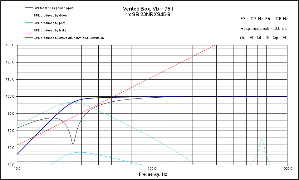

No, i mean cabinet volume and tuning frequency if BR.
Sorry first time I dont understand you, yes the BR is frequency tuned with cabinet volume.
For 1 SB 23NRSX45-8:
Vb = 75L
Fb = 26Hz
F3 = 27Hz
F10 = 20Hz
Port inside diameter = 7.65cm (3")
Port Length = 26.86cm
Stuffing = walls covered
xmax is not exceeded until 100dB 1W/1M at about 23Hz.
Port size and Vb can be slightly adjusted if desired. Actually, there any number of different ways to tune this - this is just one.
Port Volume (L) = (pi*r^2*l)/1000, where r = 1/2 the outside port diameter (cm), and l = the length inside the cabinet (cm) (divide by 1000 because 1L = 1000cm^3)
Be sure that Vb of 75L excludes the volumes of the port, driver, bracing, xo's, etc.
Here's what the response looks like:

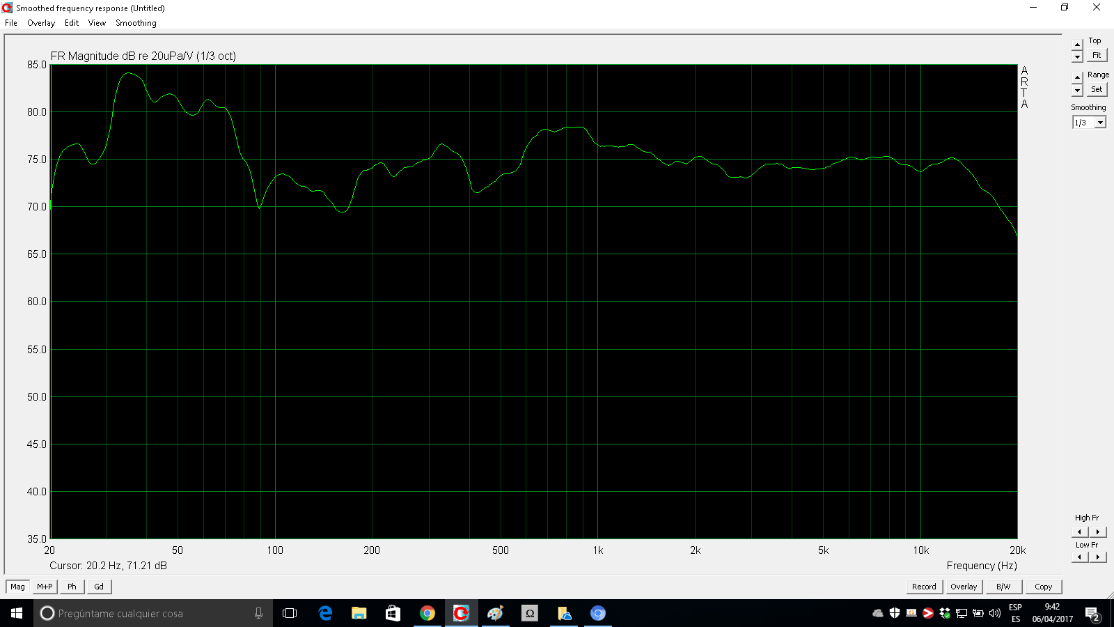

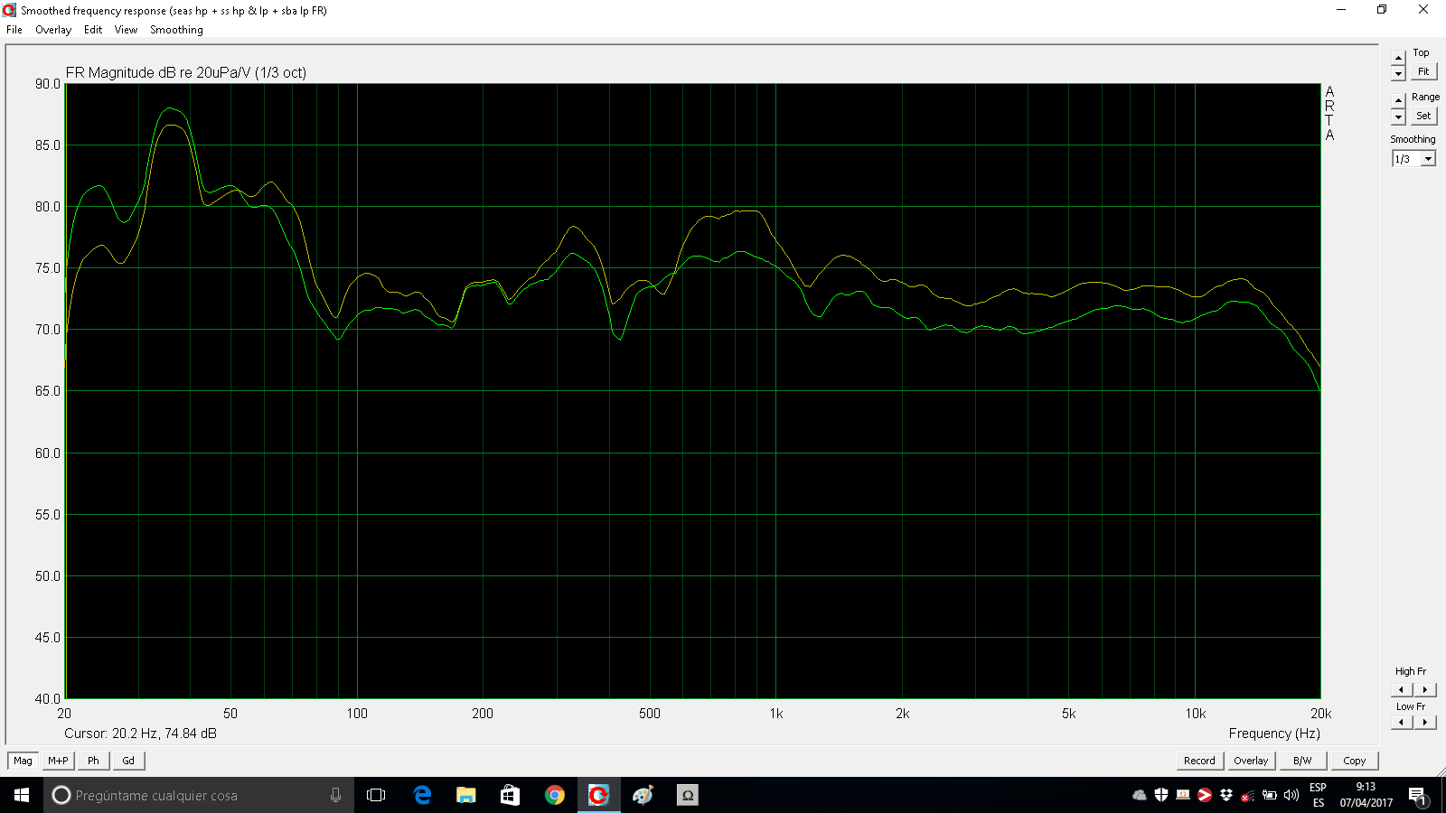

Measurements done SS monitor with BR closed but have BR, do you want that I will open?
BR only when SS + Seas monitor used only as two way.
Yellow SS with BR & green SS without BR, SBA phase inverted.
Without filter measurements SBA in box.
Nearfield
50 cm
SBA 50 cm

Merlin, see that you want to check your xover is ok... or what's wrong with it...
These FR at 50cm will help, but don't expect any serious sim without valid impedance file, not the half guesses i have been using to get by...😎
Without filter measurements SS in box.
Nearfield
50 cm
SS 50 cm *pir
https://www.dropbox.com/s/m2c8afyv9kfjlks/SS%2050%20cm.pir?dl=0

- Xover to filter woofer SB 23NRSX45-8
