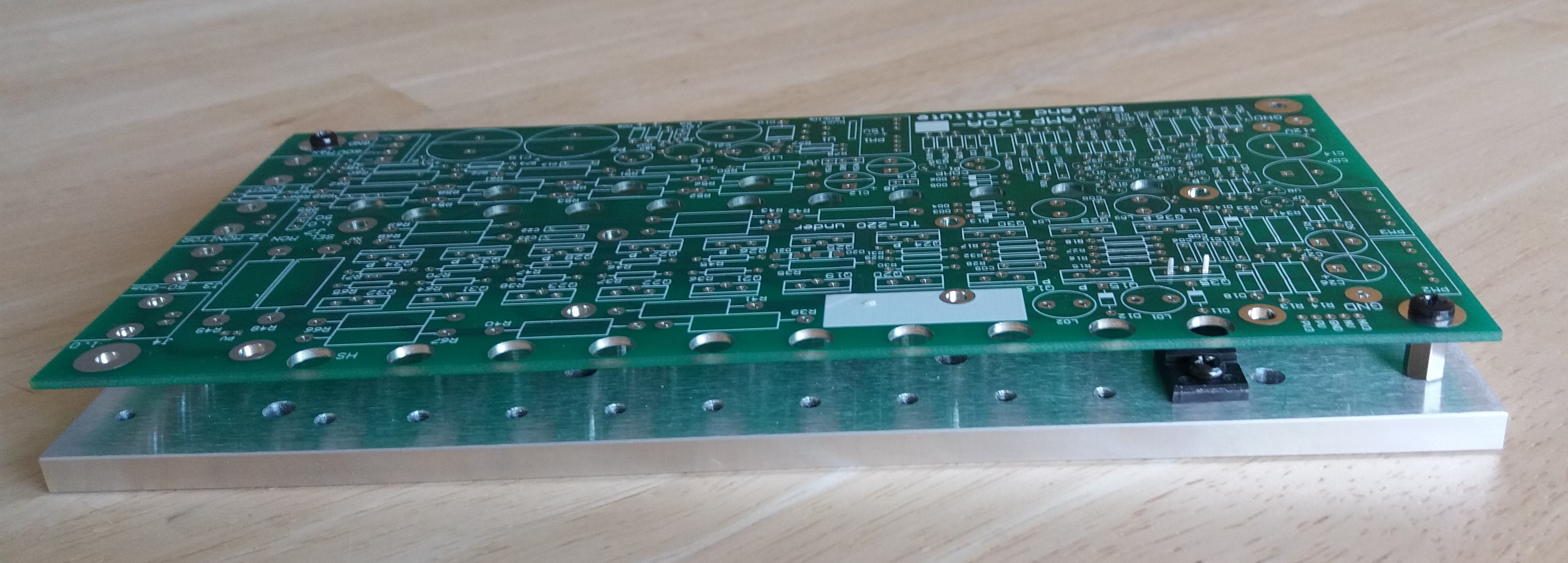

By bolting everything in place before soldering the TO-220 leads, they're in a stress-free position. If the tabs are unscrewed and the board removed, and later replaced, everything still lines up, without stress. The leads are bent 0.70 inches from the tab hole, which is 0.2 inches = 5 mm from the body. As described, grab in this 5mm region with your long-nose pliers, and bend beyond that point w/o stressing the package.

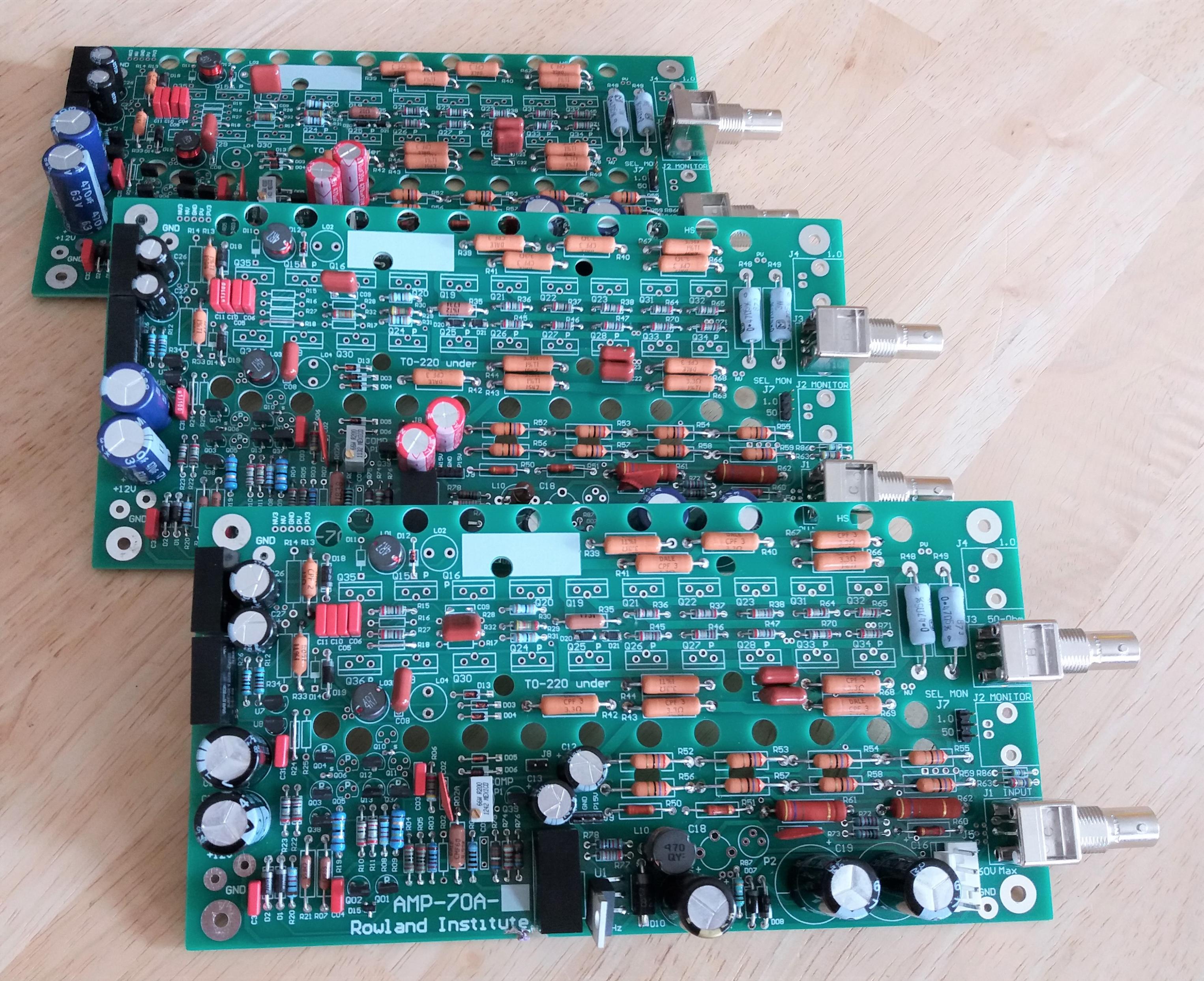

Boards, mounting plates and DC-DC converters available
This Monday the 3rd of June I will get sets of DC-DC converters for Winfields AMP-70, courtesy Mr. Hill.
I had the PCBs and the mounting plates delivered earlier, so now there are complete sets of the stuff that's not easily sourced.
Several people have reserved sets but I still have some available.
Complete set of PCB, mounting plate and 3 DC-DC converters, euro 25 plus shipping at cost. A pair is euro 45 + shipping.
Send me your shipping address via PM and I will calculate shipping, will be tracked lowest cost.
I will start putting the power supply system together next week and will report any issues here and on my website Winfield Hill's AMP-70 - Under Construction | Linear Audio NL
A fun project that will result in an absolutely unique amplifier!
Jan

Drew first blood today. Slowly turned up the supply to +/-30V, that's max with my lab supply. No load. Current draw about +/-300mA + 350mA for the DC/DC converter, which gets fairly hot. Everything else seems normal, no magic smoke.
Unloaded output (1 output pair) looks OK, undistorted 1kHz. Gain about 10x.
And, as is customary at first switch-on ;-), low level oscillations, about 200mV pk-pk, about 6MHz.
My +/-50V/10A supply sits in the basement and weights about 100 kilos. Looking forward to lug it up 😡
Jan
