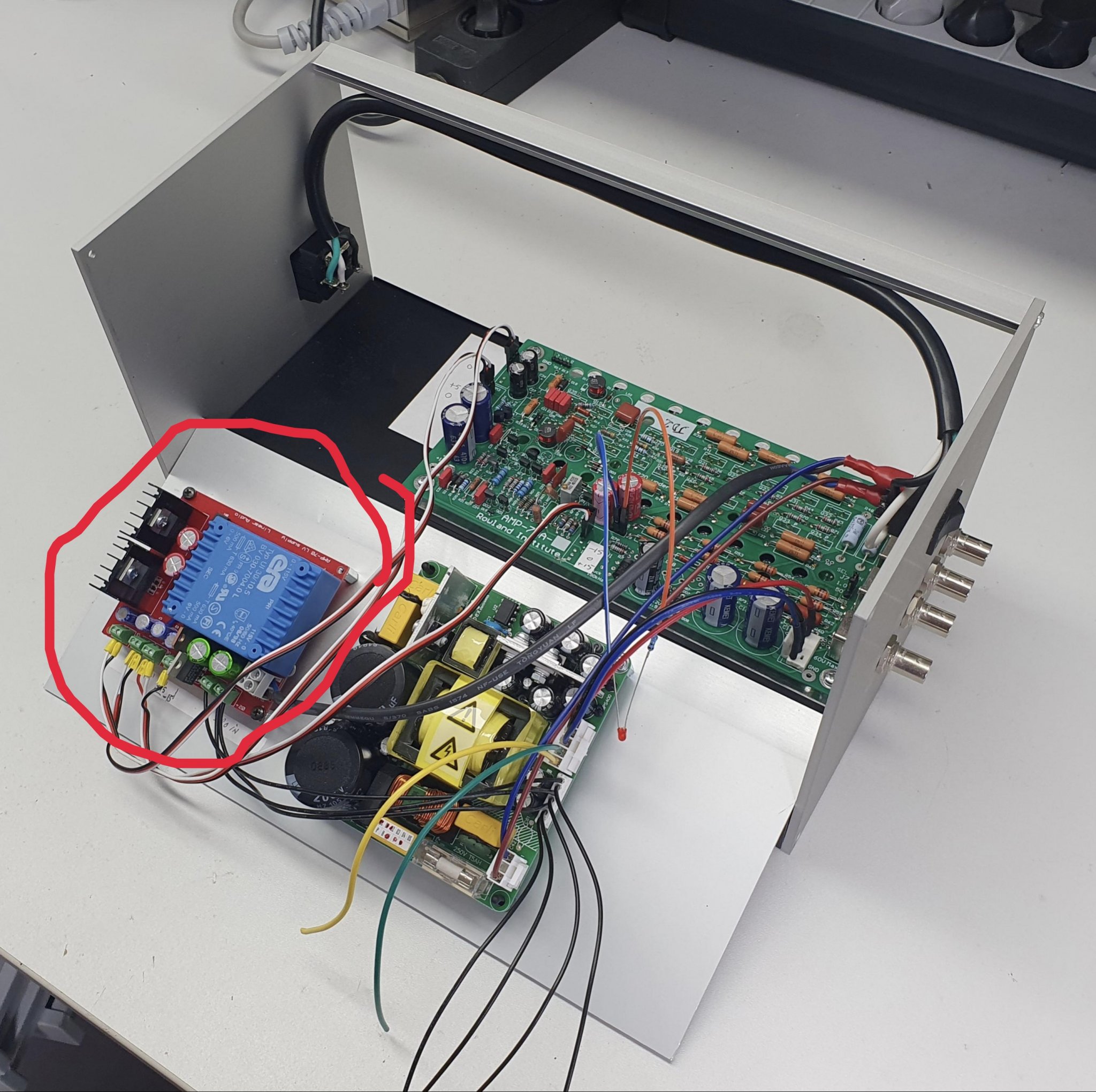

How to find notes?This is not distortion, this is interference from switcher, please read Jan's notes
Thanks for the advice。I designed that power supply.
But the DC-DC converter is not 'weak', if it burned out you have a problem in the amp.
Replacing it with something else will not fix the problem.

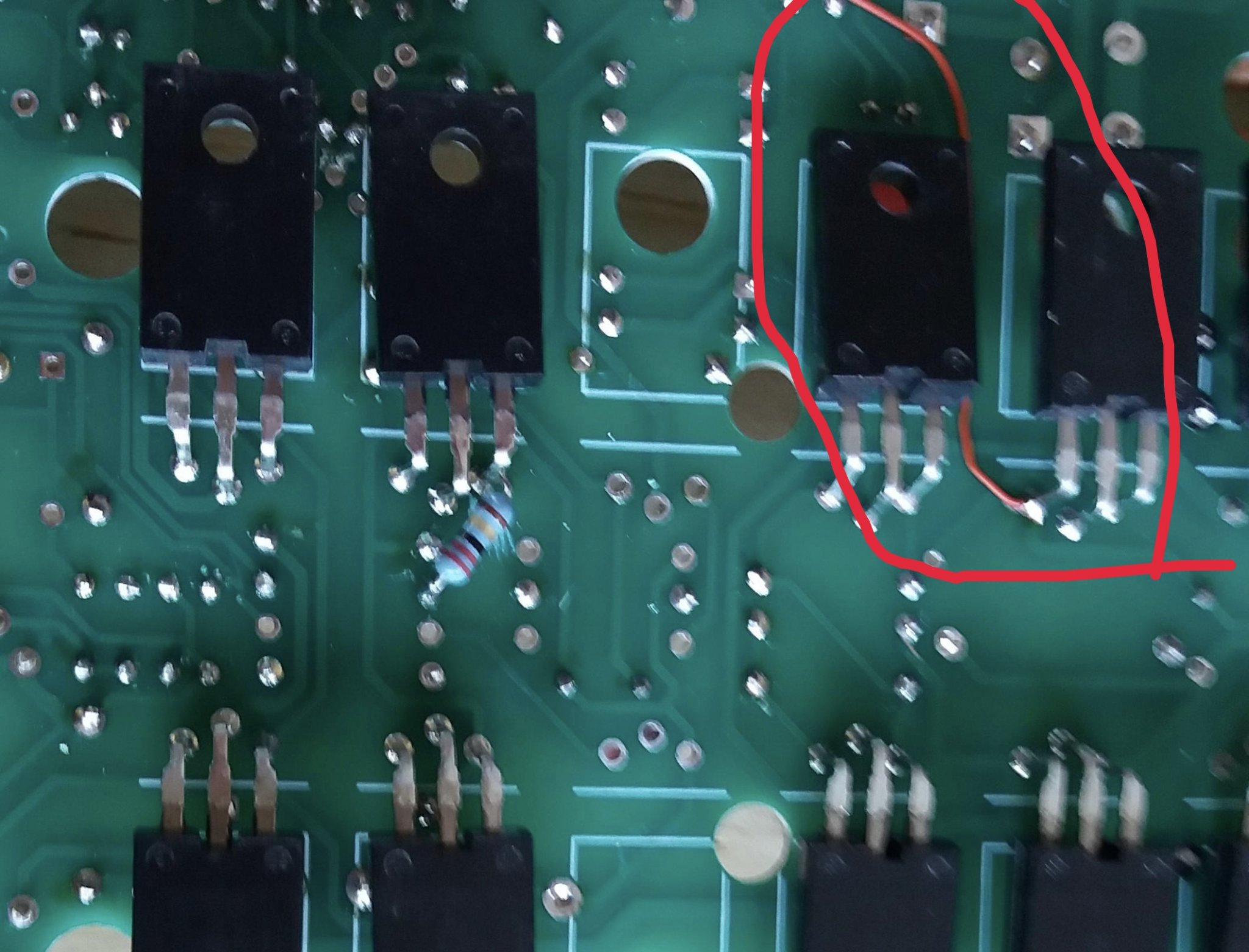

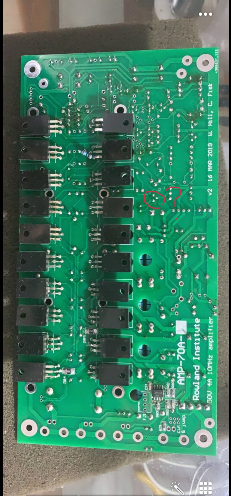

I found a patch missing on the reverse side of the board? Must the patch in the red circle be made?
Yes, do all of the changes mentioned here: https://docs.google.com/document/d/1Msi3JuRKVNsGa9yKPpHD9AH9sX4urQjUuti1efcf5AM/edit

Sorry, can't see the other point of this wire there?Thanks for the advice。
hi jan Can you tell me where the other end of the wire is?Yes, do all of the changes mentioned here: https://docs.google.com/document/d/1Msi3JuRKVNsGa9yKPpHD9AH9sX4urQjUuti1efcf5AM/edit

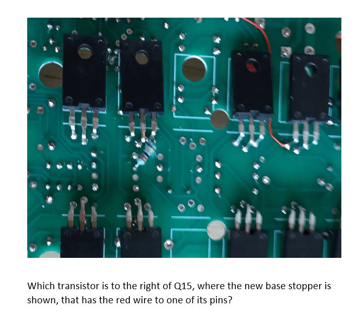

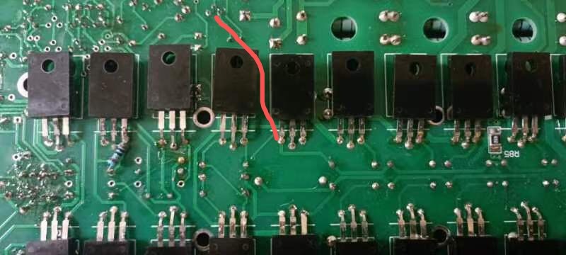

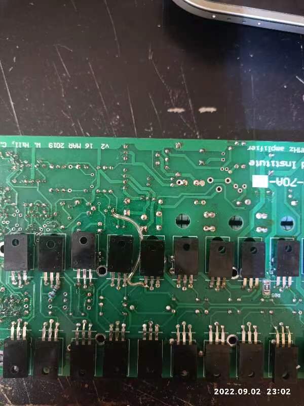

Yes, the solder joint in the upper left corner of this red line is there?I don't see anything inside that circle. Are you referring to the mod in the attached pic?
Jan
Is this correct?I don't see anything inside that circle. Are you referring to the mod in the attached pic?
