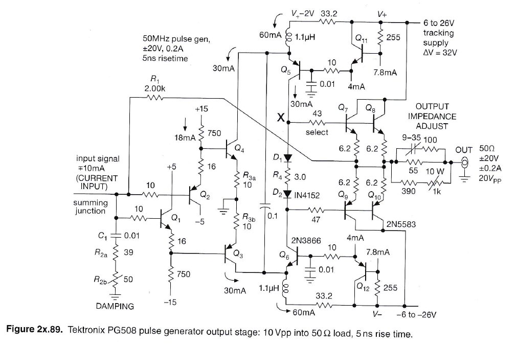

Why is the open-loop gain gm*Xc, and not gm times the input impedance of Q7-Q10? (Refering to PG508 schematic.)
AoE x-Chapters 2x.14, PG508 output-stage gain
In section 2x.14 and Figure 2x.88 we're primarily concerned with having enough gain to make a good amplifier at 50MHz. The estimated 20pF of node capacitance presents about 800 ohms of reactance at 10MHz, and drops to only 160 ohms at 50MHz. By comparison, the input impedance of the output emitter-follower transistors would be about 10k (for a 50-ohm load and beta = 100).** Below about 800kHz that would become the main limit to loop gain.

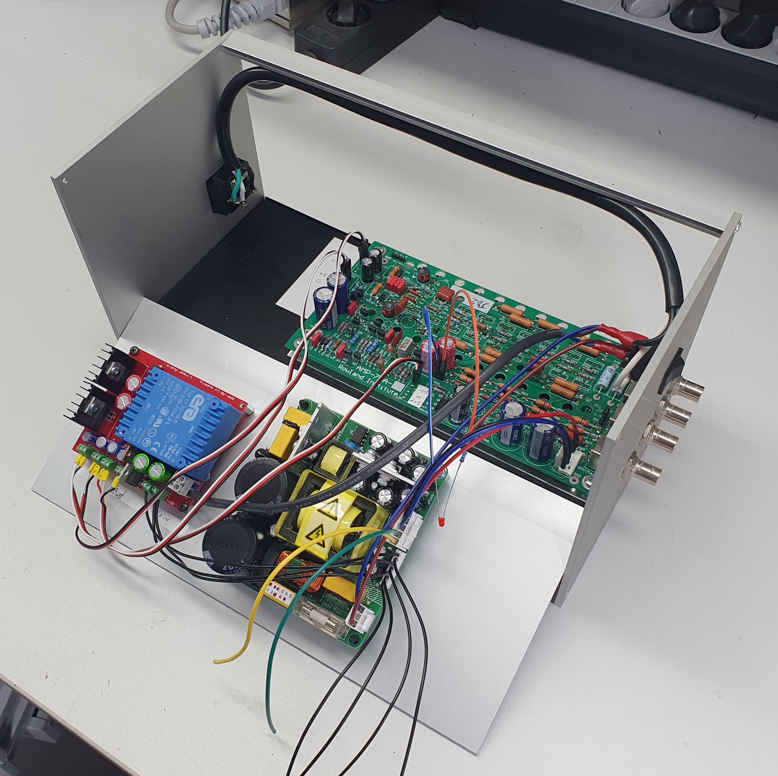

Finally got time to resurrect this project and finalize my two units I build up.
Getting into the process of testing both (I did functional test a year ago so knew they worked OK).
I already found that both have a substantial DC offset, one unit 0.4V, the other 1.2V. As far as I can see there's no offset nulling foreseen.
So my question is, anyone here has seen this too, and what would be the best way to null it?

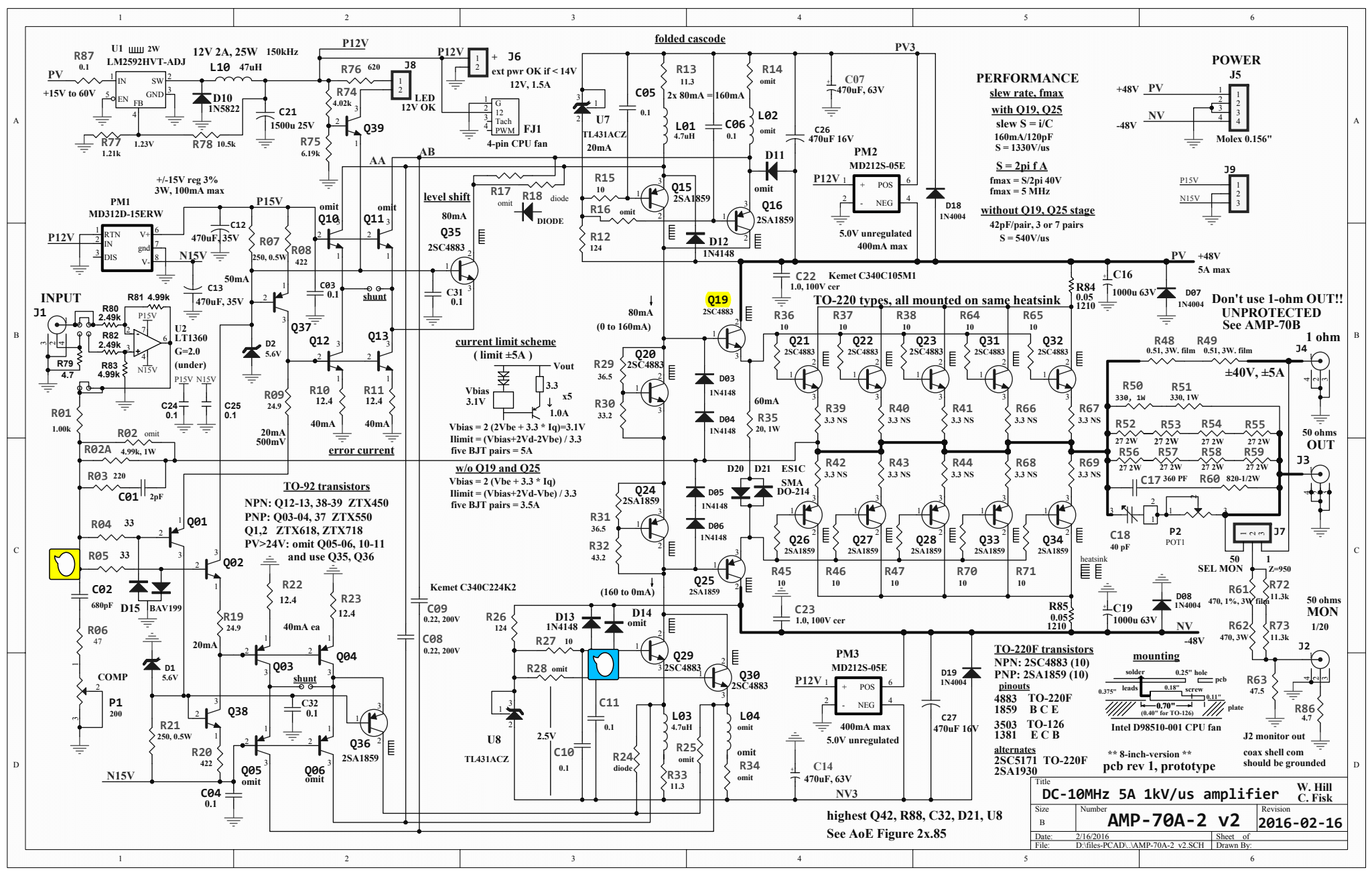

No easy way to balance offset. If it is stable I would
inject some corrective dc at U2 input as a quick fix.

Not an unusual symptom for an almost classic inverting CFA + folded cascode. They are not famous for small offsets.
Jan, leaving the TL431 without decoupling (10u or more electrolytic, not a 0.1u ceramic, that would guarantee oscillations!) is a bad idea. C02 must be 680uF not pF.
Hmmm, those TL431's are indeed not decoupled. Need to check what is actually on the boards, it's been a while.
I was to believe that the R06/C02 do not set the gain but were intended to set for best stability, and that I do remember: I had to adjust them for stability with load.

O, looking at the inspirator for this amp, the Tek PG508, you see the same stability circuit. This is not to set the gain; that is set by the ratio of the source impedance and the feedback resistance.
Attached from The Art of Electronics, The X-Chapters, Paul Horowitz and Winfield Hill. Get that book!

You are right, I stand corrected. That’s a phase correction at HF.
Just by inspection, this amp doesn’t seem excel in stability. In particular the lead-lag with a 2pF capacitor is concerning, in general I cringe when I see anything under 10pF, for audio purposes, but also this lead lag within 680pF which raises the loop gain around 10MHz, in order to correct the phase, is not in particular appealing to me.
But I am sure it works fine if properly tuned. I would expect a strong implementation (layout, wiring, power supply decoupling) dependent tuning process.

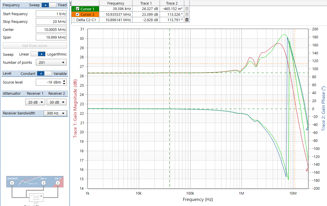

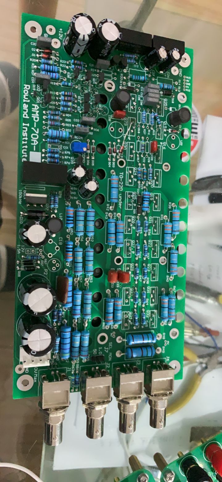

Yes, you are right. With optimal tuning there is still a 3dB hump at a few MHz, down 3dB at around 10MHz.
And, with all due respect for whoever laid out the PCB, it's suboptimal to say it nice.

The following mod decreases the output DC offset from 1.2V to less than 50mV.
Connect a resistor of 180k from the +15 supply to the input summing point (junction R01-R02A-R03 etc.).
After about 10 mins of warmup it's almost zero, but it wavers a bit with temperature etc. Anything better would require a small DC servo add-on; I might still do that.

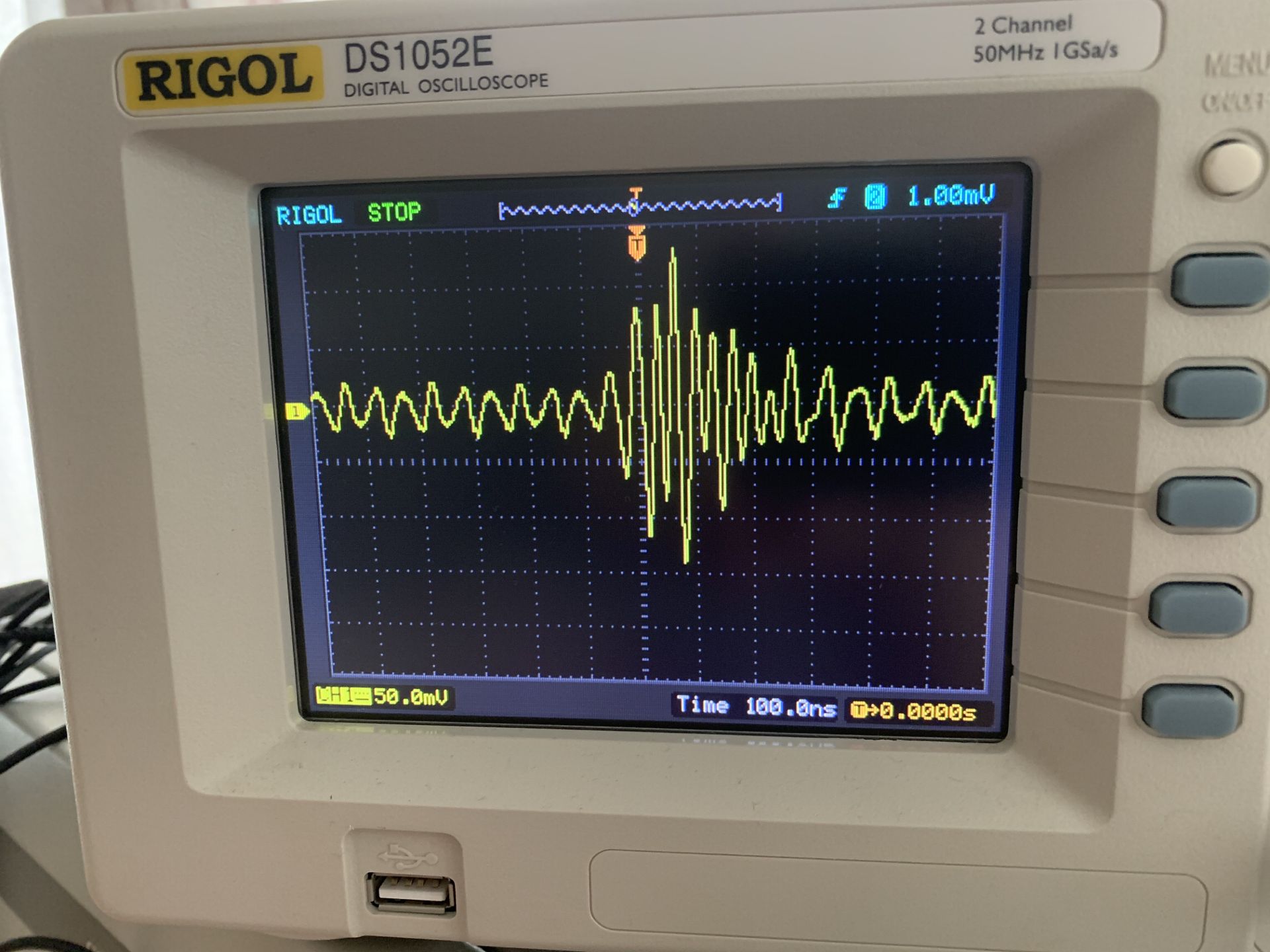

I copied an amplifier and the power-on test was terrible.
The output distortion is very bad.
I have done all the patching.
What should I do next to debug?

It is the output signal distortionI have no idea what the scope picture shows.
Jan
How do I debug it?
