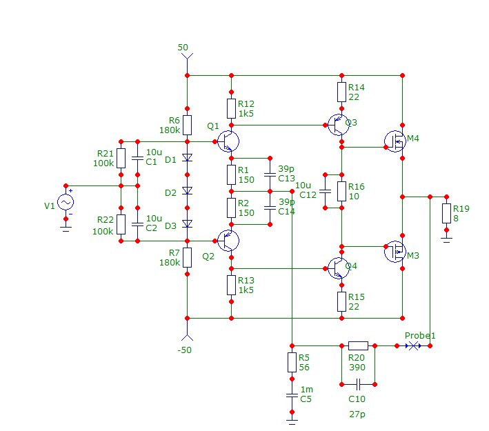

I'm wondering if I could take an sx-Amp and hot rod it to deliver similar performance figures.

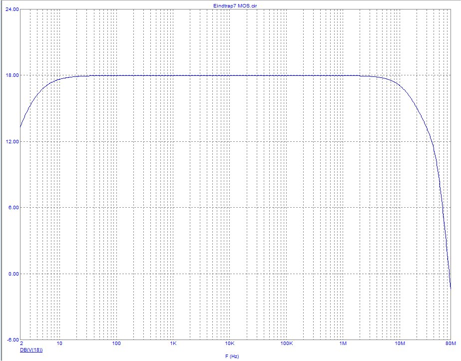

Could you get it to do 5MHz -3dB?

It's this simple: the example amp has the -3 dB point at 20 MHz - see pics.

Can you do a loop gain plot? Looks very simple - hopefully you solved Jan’s request for him.

The circuit in post-45 has no device types listed. Doesn't the compensation depend on the use of specific types?

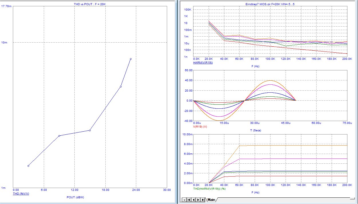

Probably not, because I also designed an amp with THD (100 W 8 ohm 20 KHz) below 30 ppb (no mistake). IMD is lowered similarly, likely even audibly so and the only extra part is a dual opamp, LM49860 plus a few RC's.

We are all talking ppb. Does it matter ?
Or over 200v/uS ? Audio only requires a paltry <20v/uS.
The only reason I go with a 200V/uS CFA is the "fat" gain margin
at 20K , so I can get my (realistic) <20ppm THD 20K.
Not for the slewrate.
Edit - I have ported "greenamp CFA " to a BJT 40W class A. 1-5ppm all the way.
