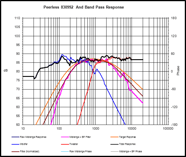

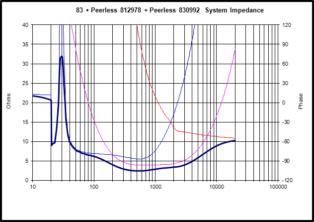

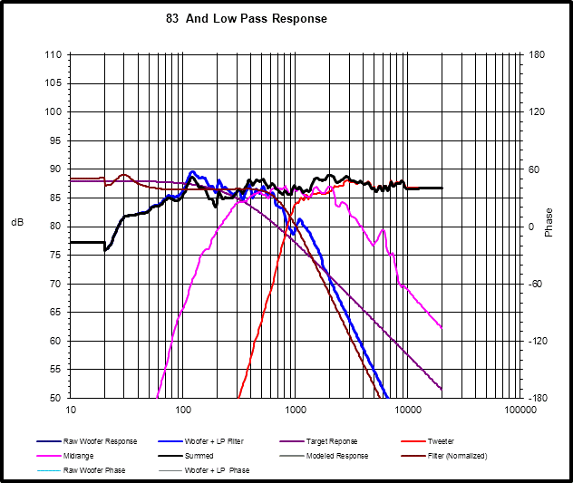

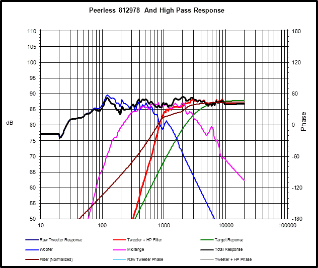

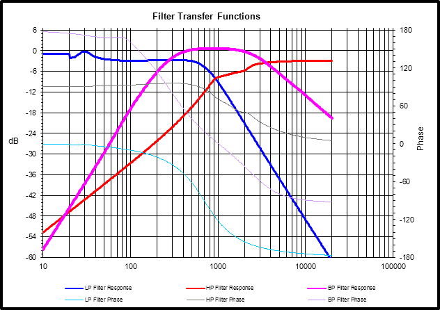

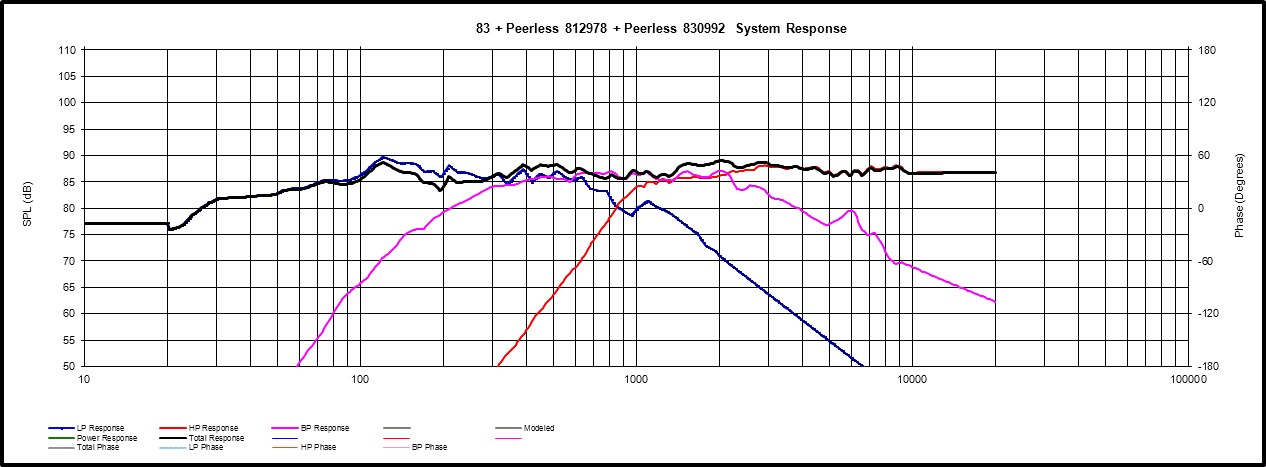

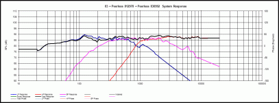

Gents
Attached are graphs of my working of PCD crossover. XO 300Hz and 3000Hz
Woofer has Zobel and parallel contour filter.
Tweeter has Zobel, parallel resistor and series RLC
Mid has Zobel and parallel resistor.
I had great difficulty getting a smoooth flat response, the drivers I have are not that compatible, unfortunately.
I am a bit concerned as cost of components and drivers is getting up there with price of good pair of proven speakers, and that is before I have butchered everything with a soldering iron.
All comments welcome... 🙂
Wintermute,
Try this and I think that you will be happy in the end and will achieve the results that you are after. Remove the crossover from you bass mid. Check the impedance curve with the speaker in the box. Build yourself a conjugate network, an LCR network that goes across the terminals of the speaker as close as you can get. What you are trying to do is make an inverse relationship to the impedance reactance curve of the driver. The resistor value will be a total of the resistance of the capacitor and the inductor and whatever you have to add to be the total. None of the components need to be very large as you are only trying to match the properties of the voicecoils impedance values. The coil can be very small gauge wire. First is the capacitor and Inductor values and finally the resistor to match the level of the voicecoil. When you get this right the impedance curve will be flat, you will have a perfectly resistive load on both the crossover and the amplifier when you are done. My friend who is expert at this does it quickly with a set of inductance and capacitor switchable boxes so he can change values very quickly. Your polar response of the device will be something you will not see any other way. He would kick my *** if he knew I was posting this information. Try it, you will get somewhere you will never get with your speakers any other way. You can do this on the tweeter also, just be careful and do the testing at very low power as you will not have a crossover to cut the low frequencies going to the tweeter. When you get them both to have flat impedance curves then do your crossovers, you will be pleasantly surprise in the results. Best polar response you will ever get and the amplifier will function with the lowest distortion levels as the feedback circuit does not have to fight the external pole of the speaker that it has no way of correcting.
Thanks yr replies.
Kindhornman - You have not said why this is necessary. There are Zobel ciricuits for all 3 drivers. What is it specifically in graphs I posted that you are concerned about?
Wintermute - I already have mid and tweeters. A Peerless 8" 831868 doesn't have the peak in SPL response like SB 23 but is more than double the cost.
Cheers
Cheers
Stevenn,
A Zobel is not a conjugate network, It does not have an inverse relationship to the moving coil in a gap. Yes it does flatten the impedance curve but it does not do the same thing as the conjugate network that eliminate both impedance, phase shift and the back emf wave in the same manner. Ignore what I said, it doesn't matter, but I was trying to tell you something that you will not get from the simplicity of the Zobel network.
Also Stevenn as the XO on the woofer is in an area where the impedance is probably already equal to the DCR there is probably no need for a Zobel network on it. A Zobel on the tweeter would be there to flatten the impedance for the amplifiers sake too, so if cost is becoming an issue that part of the network could be eliminated as well

Kindhornman.
Thank you for your detailed post, which I just about understand.
The conjugate network would seem to be a great tool for use in advanced design and is worthy of a thread all of its own. Surely top brand speakers should incorporate this as a matter of routine?
However I have neither tools or instruments (switchbox?)to measure the parameters suggested, nor the where withall to determine sizes of the particular components involved.
I started this thread with a view to getting members' help as newbie in renovating a pair of speakers by using some freely available recognised software WinIsd and PCD and whilst I feel my understanding of Physics involved has improved, I am no closer to starting this and in particular have no confidence in my results which I have posted for critique.
A quality speaker kit is starting to look like a good option!
