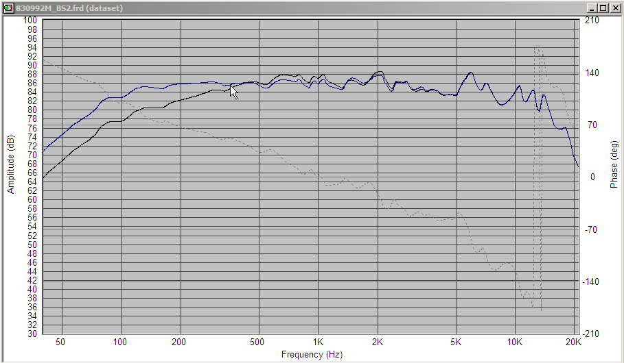

Hi Steve, I've done a bit more playing. I've now also put baffle step data into each drivers frd's using response modeller, and put everything back into pcd including offsets.
The vertical and horizontal offsets make a little difference but not much, SW models came accross well. Z offset data is a different matter. it has a small but not bad effect for the lower crossover point, enough to be ignored, however it has a much bigger effect for the High pass cross between mid and tweeter. enough to need to consider it. SW does allow Z offset to be used so I can play around with it.
I changed the low frequency crossover point to 350Hz after comparing the non-baffle step corrected and baffle-step corrected plots. Cursor in the screen shot is around 350Hz. Blue trace is uncorrected, black is corrected.
Both non baffle step corrected and baffle step corrected files in the attachment.
note that with the new data the zobel on the tweeter may not be necessary saving a big coil if not. edit, scrub that it didn't look like it was making much difference in PCD but when I took it out in SW the difference was more obvious due to the bigger graph.
Tony.
Tony.

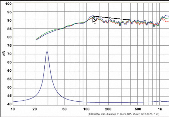

The problem seems to be more the initial peak in SB23NRX45-8 at about the 140Hz: i have not been able to remove this whatever I did. An L-Pad is just not practical, either.
hi Steve, I wouldnt worry about it. You will probably find it is artifect of the factory measurements. They do them usually in a standard box which is not optimal for the driver. You are better off using modeled response under 200 hz. Try the baffle step adjusted frds you should notice a difference 🙂

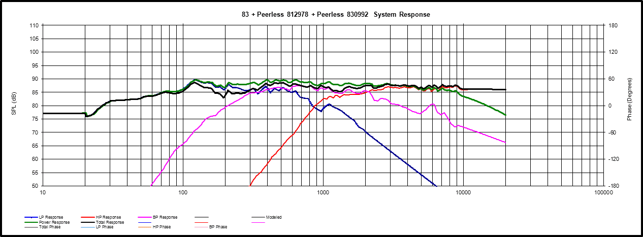

Hi KH, do you think that the anomaly showing in the response attached is a mechanical resonance?
I'd interpreted it as a rising response typical of being in too small a box, but I guess if anything it would be more likely to be in too large a box for manufacturers measurements.
There is a tiny glitch in the impedance curve around the same place as the dip in the middle of the hump, but nothing particularly obvious.
On another note, putting in the z offset (relative to the tweeter) for the mid certainly makes it a lot harder to get decent phase matching! Looking at the cad drawing for the drivers (mid and tweeter) I estimated the offset to be around 18mm (a bit more than Steve's 14mm) This is an area I'm a little uncertain of, as my measurements took care of this (and I had pretty much time aligned drivers as well which makes it easier!)

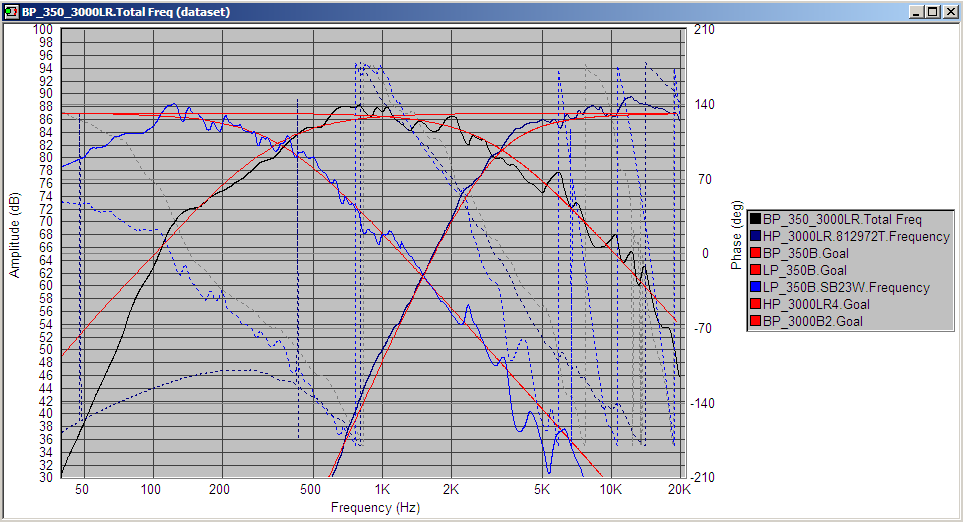

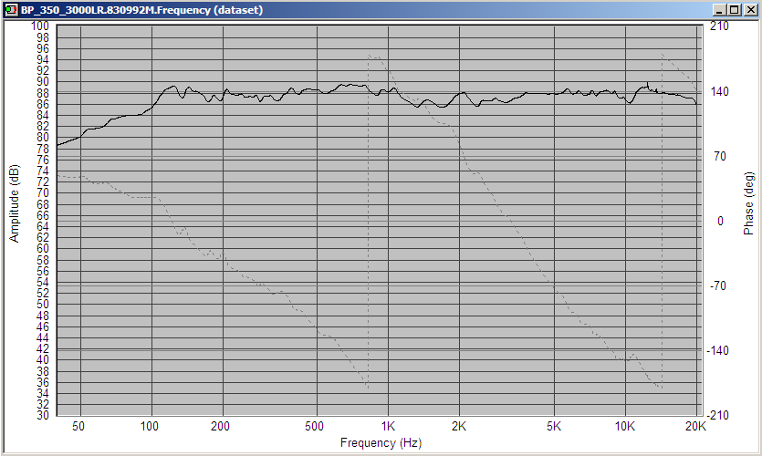

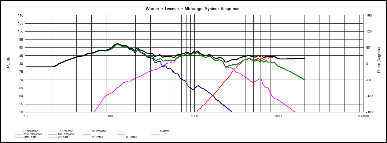

Me being my usual obsessive self 😉 I accidentally discovered if I use a 2nd order bessel on the mid lp and 4th order LR on the tweeter, both at 3Khz I get almost perfect phase tracking and pretty good FR as well. looks better than the symetrical 4th order LR at 3Khz.
Time for me to hang up my hat for a while though, I should post the schematics of what I have done so Steve can play with it some more 🙂

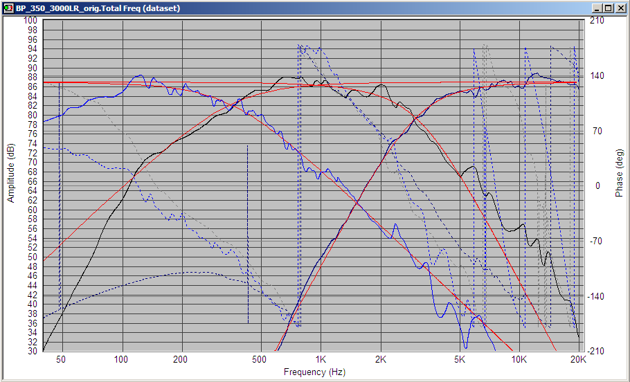

First pic is what I had got too with 2nd order bessel at 350Hz and 4th order LR at 3Khz. Second pic is the summed response.
Third pic is with 2nd order bessel at 350Hz and also on the mid at 3000hz with the 4th order LR at 3000Hz from the first pic on the tweeter. Fourth pic is the resulting FR.
Offsets used on the drivers were -18mm for the mid and -40mm for the SB23.
Tony.
Tony.

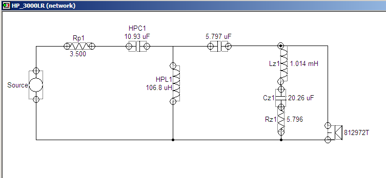

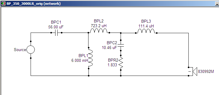

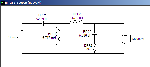

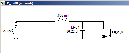

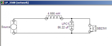

and here are the schematics. Knock yourself out Steve 😉 (for real world you will want to adjust to nearest standard values and see how it looks, if ok then you don't need to worry about coming up with strange values).
Third one is the one that has bessel 2nd order slope for both the high and low pass of the bandpass rather than 2nd order on the high pass and 4th order on the low pass.

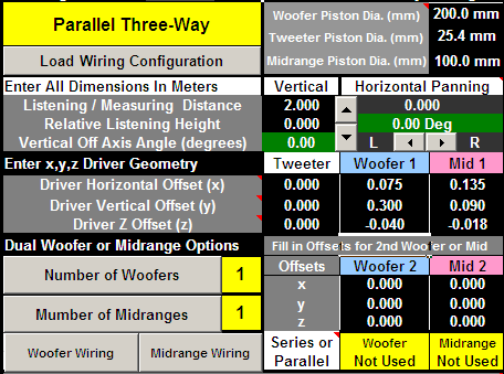

z offsets to put into PCD are -18 and -40 for what I have simmed here the baffle position offsets didn't seem to make much difference but it doesn't hurt to put them in. I don't know if the Z offsets are correct however, they are my best guesses based on the cad diagrams of the drivers as to where the voice coils would be. edit: actually I haven't checked the impedance of these 🙄 you have to put all of the networks into one in SW to get it to do the impedance, but you can only run the optimizer if you have a single driver (which is why I have separate networks for each driver) the optimizer in SW is great!!
Tony.

edit3: added pcd saved file. tweaking the coil in the high pass to 140uH gives a better result 😉 I'm stopping now, I promise 😀
Tony.
edit2: added pcd offsets screenshot.

HI Tony
First of all, a big thank you for all yr work. Very much appreciated and way beyond anything I was expecting!
Interestingly, when I compared my own C, Z and L values with yours, they were very close on most components (but way off on a couple).
When I put your values into PCD with csp file, i get graph below (assuming I have components in right place on PCD circuit).
My last attempt at PCD is second graph which appears to have a flatter summed response.
Woofer LP = second order filter
Mid HP = second order
Mid LP = second order
Tweeter = second order parallel

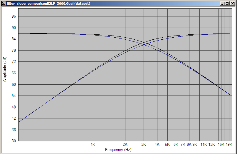

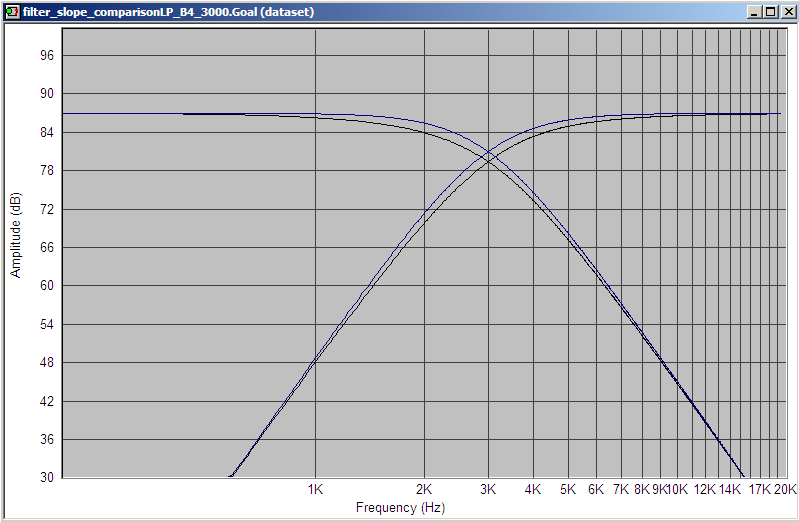

Hi Steven, You aren't thinking of a chebychev filter are you? Bessel does have a bit of a hump at crossover (similar to butterworth but not as much) which can be useful if you have a hole in your response.... The usual complaint about bessel is that the rolloff starts earlier (so you have a wider area of summation, but for 2nd order the rolloff actually starts later than for a LR. 4th order the bessel rollof starts earlier and is deeper. I used 4th order bessel on my MTM's and I'm very happy with it.
The main advantage of bessel is that it has perfectly flat group delay in the pass band, and has the best phase response out of LR, Butterworth and Chebychev filters.
Attached are two comparisons of bessel and LR slopes. Black is bessel and blue is LR. I find it interesting that the 4th order bessel still will sum with a hump compared to the LR, it seems that it would be the opposite when you look at the slopes (the second order seems intuitive that it will have a hump) unless I'm remembering incorrectly and 2nd order has a 1.5db hump and 4th order has a 1.5db dip, that would seem more intuitive......
Tony.
