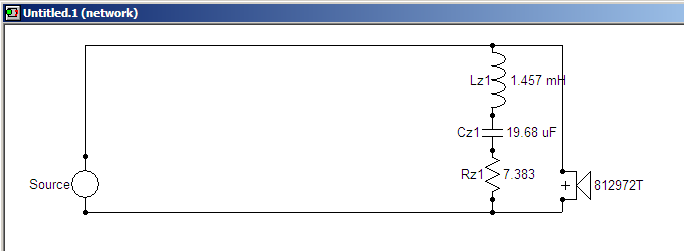

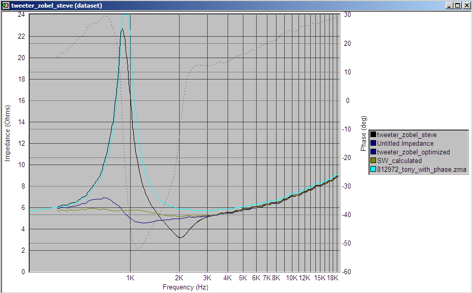

Hi Steve,
first thing I would say definitely has to change is the resonant peak filter on the tweeter. I modeled it it speaker workshop with the values you have in PCD, and it is missing the mark. Attached is a comparison of your pcd one, compared to the one automatically calculated by speaker workshop, and finally the one that resulted when I ran the optimizer in SW for the tweeter circuit I had.
The SW auto one is pretty much optimal as far as flattening the impedance is concerned, the optimizer probably changed it a bit to get the rollof to match the target curve I had better. The circuit diagram shows the SW auto calculated one.
The tweeter doesn't appear to have any ferro fluid (the impedance peak would be much lower if it did) so it probably does need the zobel if you want it to roll off properly, certainly I found it necessary (even though I started without it) to get the tweeter to fit the target curve (which I ended up setting at 4th order L/R at 3Khz).
Tony.
