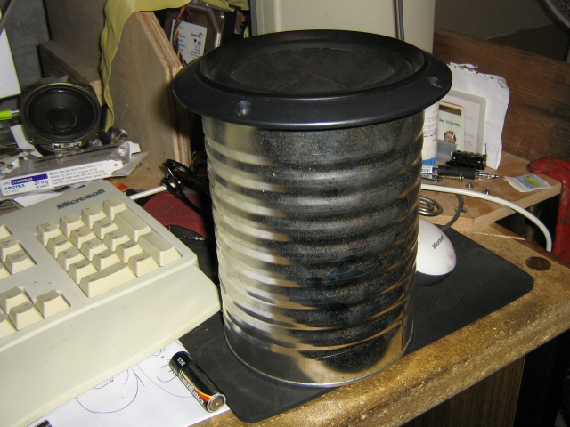

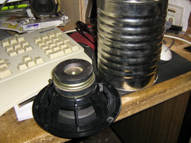

Cheap Sony woofer fits a Milo tin perfectly

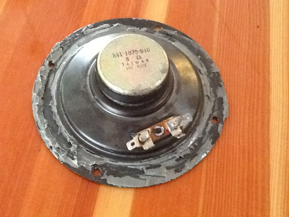

Thanks yr replies.
I may have been a bit hasty in declaring the mid driver as 'normal'. In looking more closely at it and links provided by Tony, the mid driver appears to have a metal sealed back... See photo attached.
This may explain design of speaker.
Either way, way to go now appears to be to construct separate compartment for new Peerless mid 4in (5.0 l according to WIN Isd) and find an 8 in driver best suited for a small cabinet approx 45 litres.
Of course this ignores existing cross overs and whether they are any good for new drivers, but one step at a time!

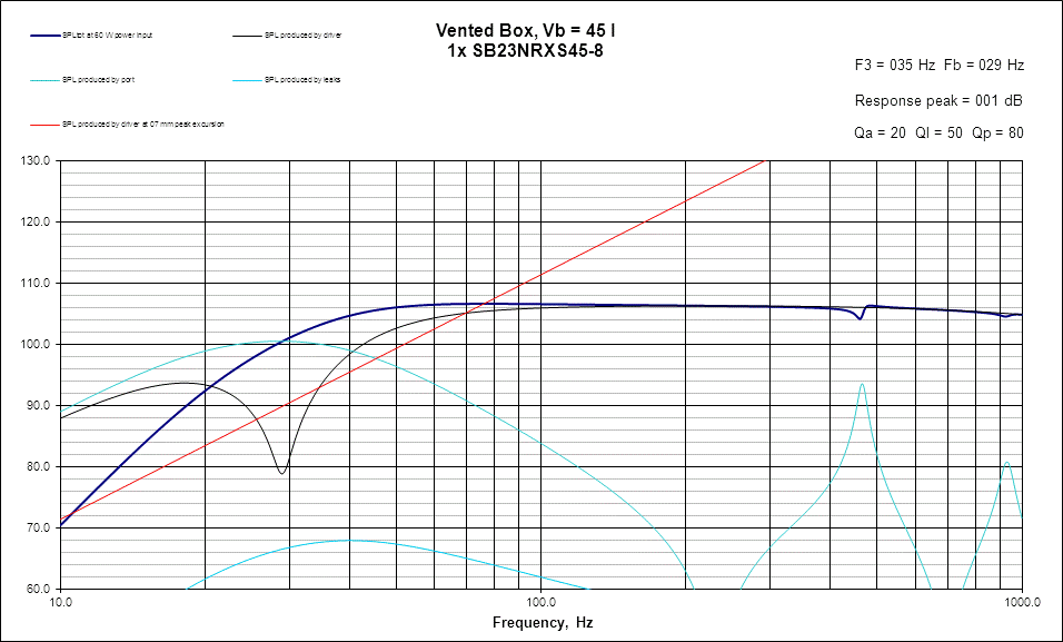

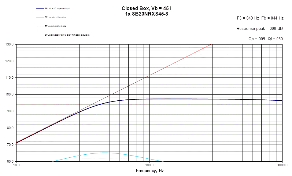

You could do a lot worse than these http://www.wescomponents.com/datasheets/Speakers/SB_Acoustics/SB23NRXS45-8.pdf
I've been working with some 4" SB drivers and I'm very impressed with them!
The 8" linked above models very well in 45L sealed enclosure (with heavy fill). F3 around 43Hz F10 around 25Hz.
linear travel runs out at about 10W but I think it should be fine up to probably as much as 50W.
Note sure of the retail price of them but suspect that they would be somewhere around the $100 mark each.

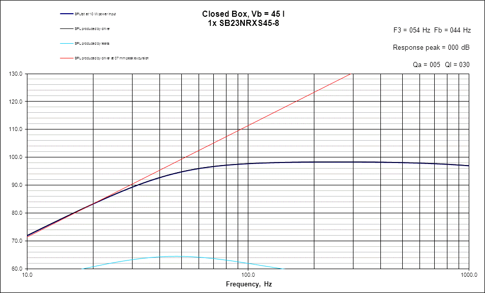

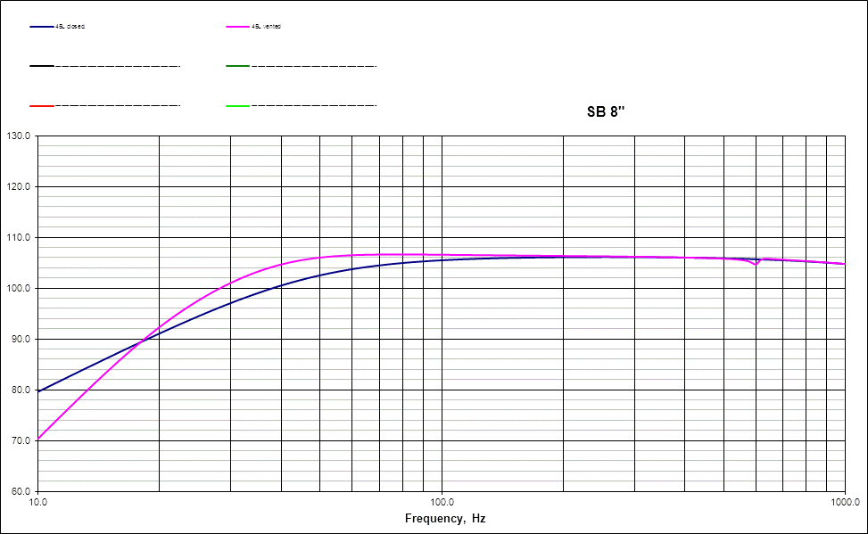

Scrap the above. I thought that the modeling seemed very good for a 8"! My unibox still had 2 ohms of series resistance from when I was playing around on a previous incarnation.... After changing to 0.2 ohms it's not quite so fantastic but still respectable. However recommended box size is only 35L.
vented at 45L with this driver might be an option too.
Tony.
