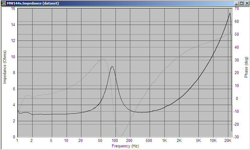

Fs of the Peerless is 89Hz so 2 octaves above resonance if 360Hz and if you look at the performance graph it gets very ratty and broken up above 8k
You need to pick a XO point where the drivers response is reasonably flat and smooth for an octave ( at least ) above and below the XO point so in this instance 3k looks OK to me. It is a design starting point anyway

Having studied AllenB article, another site Diyaudioandvideo plus instructions in the 3 way PCBs, I am feeling a little more confident. However latest qsn is concerning the bandpass filter crossover frequencies. If I am using 300 Hz and 2400 Hz for my low and high pass frequencies respectively, are these the same frequencies used for bandpass filter, I.e.
300Hz is bandpass High Pass and 2400 Hz is bandpass Low Pass?
Also woofer and mid impedances have peaks at their Fs of 27 and 89 Hz respectively so will these require impedance attenuation or are they sufficiently distant from cross over to be dampened sufficiently?

89 X 2 = 178 X 2 = 356 so not quite 2 octaves, but slightly greater than 1 1/2 octaves. What is the size of the midrange internal box and what is the midrange "In box" resonance?
If the midrange in box resonance is below 180/200 then it is OK if not perfect and XO spread can be dependent on slope. if using 300 as the bandpass high pass and both crossovers use 2nd order electrical then it may be OK, but if using a first order slope on the woofer then it may need to be crossed a little lower. I read a book by Weems which recommended using the inverse bandpass ratio to set the woofer and tweeter XO points. 2700/300=9 so 1/9 so use 270 for the woofer and 3k for the tweeter General sort of guideline and not gospel but it gives you an idea of the things that need thinking about

I just put some figures into the box program. the Peerless will work in any volume from 1 litre to 10 litres but the optimum for power handling Vs musicality seems to be between 4 and 7 litres
At 4 litres the Fc is 112 Hz using the bigger box (7l) it is 103Hz and you could get away with a first order ( a single cap in series ) at 300 but the midrange clarity would probably be better with the second order

Mid sealed box resonance 113Hz (Unibox) and 109Hz (winIsd) with vol 4.5 litres.
Reason for qsn re bandpass freq is that PCBs instructions contain tables for high/low crossover frequency components plus bandpass frequencies with first and second order crossovers.
So am I correct in assuming values to be used in table for bandpass crossovers are the same ones as for high and low crossovers in general?
