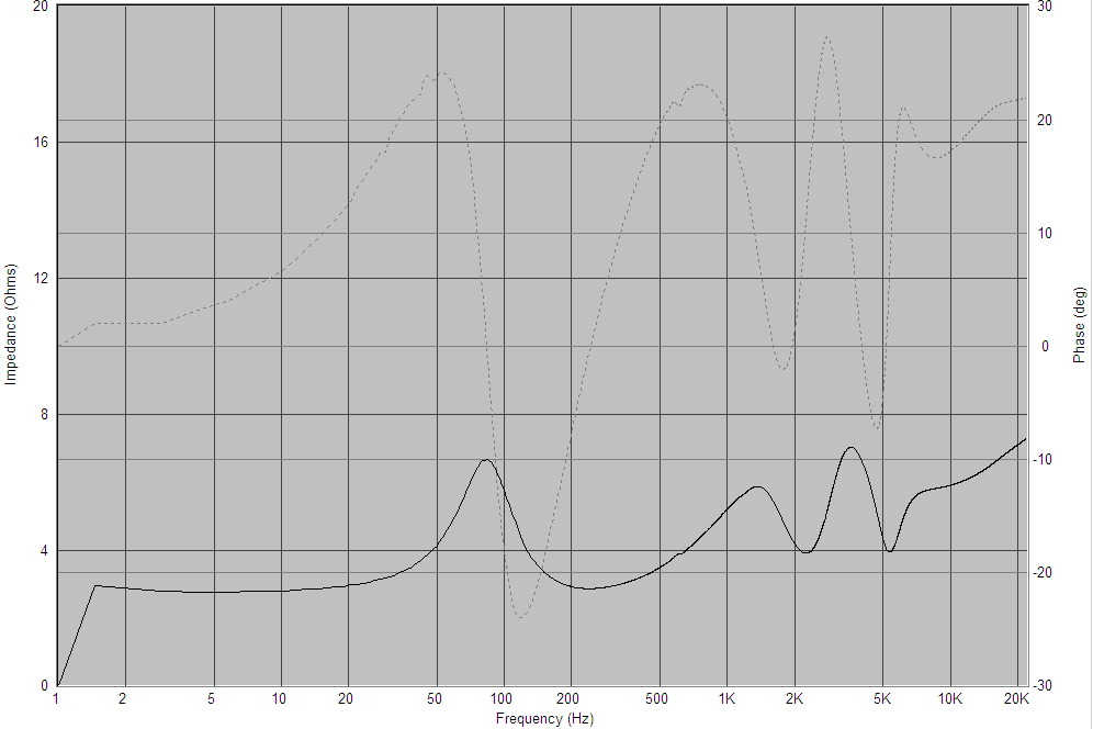

One often overlooked point of a crossover design is the actual impedance measurement of the speakers at the crossover point chosen. Do not just use a number like 8ohms at crossover. You need to understand that isn't the real value that you need to use. The actual impedance of the speaker in the box you are using at the crossover point will give you the impedance value that you need to use for the crossover point. This goes for both the upper and lower crossover points of a band pass filter. So if the mid range driver has a 6.4 ohm value at the lower frequency of the bandpass and say 8.7 ohms at the higher frequency point those are the values that you will need to use in your filter design to actually produce a crossover with the correct electrical filter. If you are using a Zobel or conjugate network on the speaker to flatten the impedance rise on a device then you need to develop this first and again remeasure the speakers impedance curve to plug in the electrical impedance at the crossover points to truly have the frequency points you have chosen and also the electrical -3db or -6db points that will sum correctly! If you do not do this your values will not be correct, the crossover point will not sum correctly. Remember also that you should check your network connected to the speaker after you build the network as the normal quality of a capacitor and many times an inductor can be as wide as 10 to 20% of the real values you have chosen. You will then need to adjust your values to make the crossover function correctly. This is the real reason that people often talk about why when substituting capacitors in a crossover from one brand to another of the same type that they say they hear a difference in their speakers, the actual values of the substituted components are not exactly the same over their value range and this is actually shifting the crossover point and changing the slope. This is the difference between an accurate crossover and one that is chosen based strictly on theoretical values only!
Thanks guys your replies.
The woofer and mid driver impedance charts have large peaks which i plan to attenuate with Zobel circuit.

Just for your information at around 300 hertz most woofers have an impedance equal or close to their DCR and often [sometimes] a drivers nominal impedance is given as the impedance at the XO frequency.
Zobels are used to flatten the impedance at a higher frequency so a great help when using book crossovers based on nominal impedance.

I understand what you are saying. I am moving past the use of a simple Zobel network of a simple RC network to a true conjugate network using an LRC network that is counter to the speakers impedance curve. Not something that is done much here in diy audio.

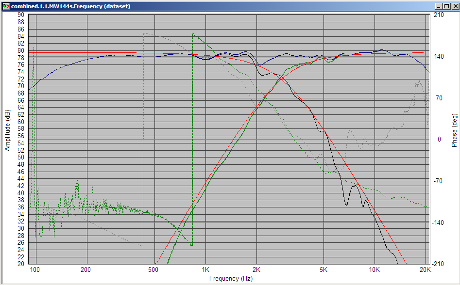

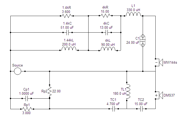

Hi Steve, I've attached an example here from my own crossover.
The target was 4th order bessel at 2.8Khz. The red traces represent that target.
The crossover to actually achieve that target consisted of a couple of notch filters and a second order electrical filter on the woofers, and a third order electrical on the tweeter. This crossover is quite a complex one but I was struggling with a few things that made it hard to get a good match to my target, I got there in the end though 🙂
Other things to look at (other than seemingly flat frequency response) are how well the phase of the two speakers tracks through the crossover region (dotted lines on the graph)
What Kindhornman said about impedance is something to watch for as well. I spent ages coming up with a super flat frequency response in the simulator but had not been simulating the impedance, I decided I should check it only to find that the impedance was dropping to about 1 ohm in places. Luckily I realized before I built it!! So do check the impedance!!
