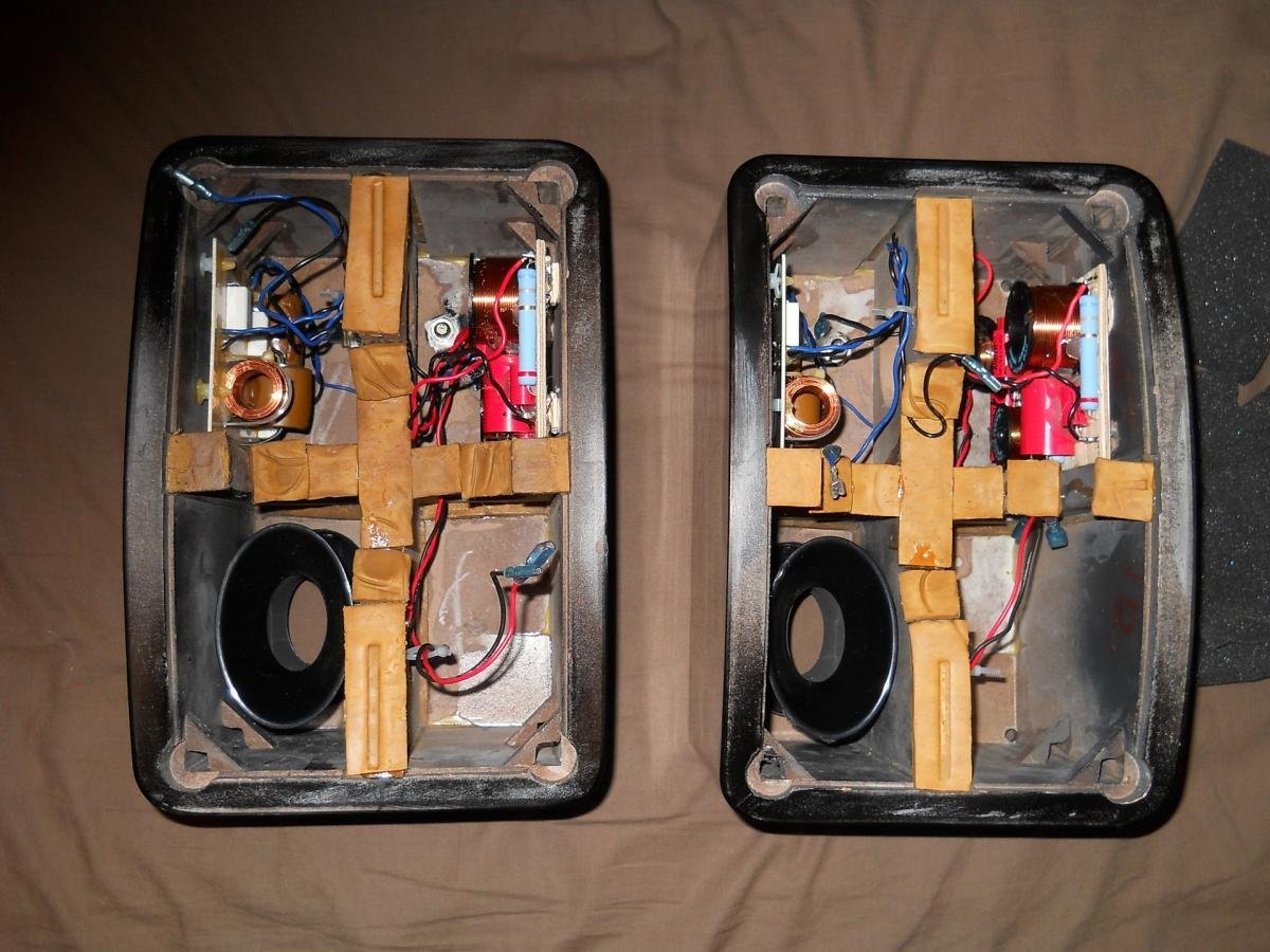

Perhaps shape of the baffle helps with stiffness so it can be bit flimsier than expected. Perhaps the allen bolts to back is to make the innards accessible while visually hiding any fasteners. Back panel could have been detachable instead of the front, but I speculate it was likely easier this way. If backpanel was detachable, they would have needed different way to attach the driver for example. The bracing damping is interesting however, damping everywhere, no rigid connections between bracing and panels!
More images from innards here https://www.stereonet.com/forums/topic/98114-kef-ls50-crossover-upgrade/
Reactions: IamJF and zman01
Did not know earlier that the KEF LS50 baffle is constructed this way and comparatively so light and hollow. Typically the best practices recommend a very strong and dense baffle. I guess the strength will come from the shape and the materials used, and due to the "lossy" nature of the mounting and braces, the driver is still well decoupled from the baffle and rest of the cabinet. The LS50 baffle shape should help with the diffraction signature also, so with the stiffness it would be two birds with one stone.
Agree, the rear mount screws would keep the design clean.
IIRC, the KEF Team found that with using damped bracing and damped mounting of front baffle and driver they could do away with CLD cabinet construction? Or the cabinet has CLD construction too?
The text hints there is CLD on the walls, but the images and illustrations show it only between brace and wall, and between brace and drive magnet.

I've been inside both the OG LS50 and Meta and they made some changes between the two. With the OG the baffle was a plastic moulding that was screwed in from the rear via long bolts as @fluid shows. With the meta, as far as I can tell, the front baffle was moulded from a much bulkier denser material and rigidly glued to the carcass, the rear panel was then glued in. In both cases the horizontal and vertical braces were separated from the enclosure with a putty like compliant tape, also placed between the driver magnet and the brace. There is nothing on the enclosure walls.
Basic stuff aside, I think its very hard to predict exactly what an enclosure will do in terms of panel resonances. The devil really is in the detail. Materials, joint types, adhesive, bracing, mounting, damping all contribute. Its great that KEF share as much as they do.

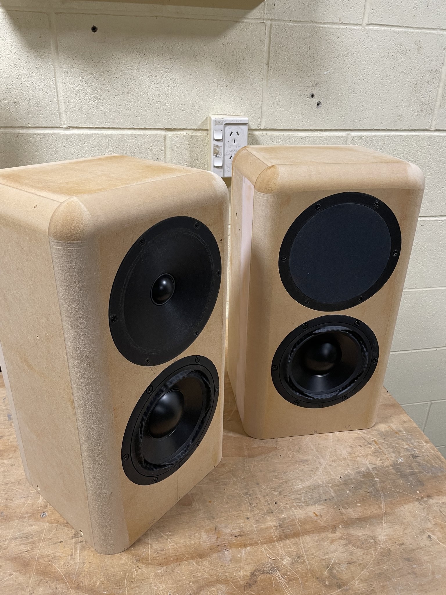

For now my plan is to make a dual walled construction with a flexible sealant used betwen the outer and inner walls for damping.
The inner shell will be bigger/thicker and may be filled with something, sand plaster, resin, bog or some combination. The inner shell will use the wall shape for stiffness and have no bracing. The inner baffle part will mount the woofer and waveguide and aim to be stiff and solid. The waveguide will have some form of damped gasket. The outer visible skin will be stiff thin and light this will be the constraining layer. Depending on the shape I decide on for the cabinet the outer will either be in two parts or one part with a gap.
I might make a control that is just 3D printed for comparison or I might not depending on time and my own interest later on.

Box may have been a bad word to use out of habit, the shape won't be boxy but curved. So no rear panel as such.
The baffle will either be printed as part of the inner in a complete cross section or if that doesn't work for print orientation the baffle will be a separate piece and rigidly glued with something strong like epoxy.

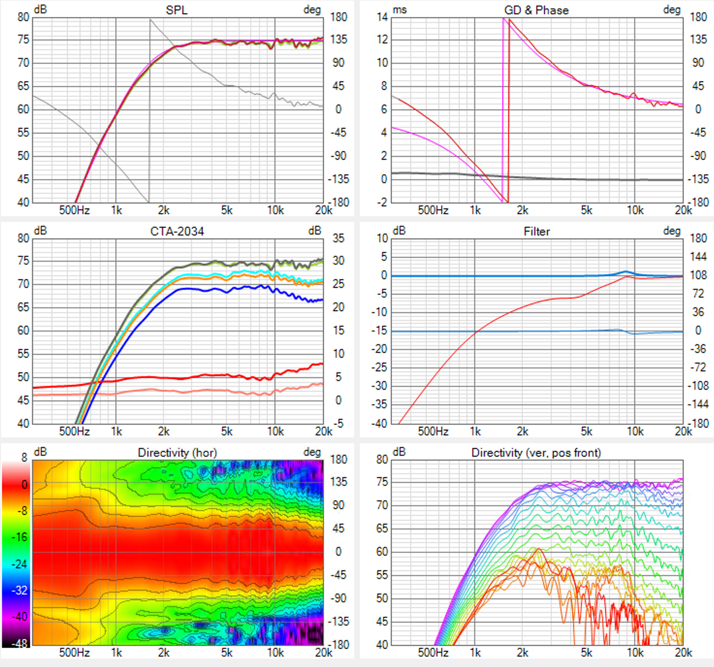

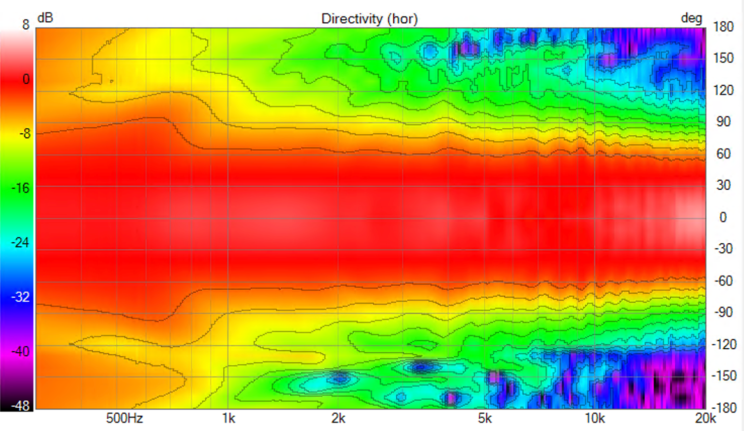

I sent a pair of waveguides to @Mainframe in the hope that he would find time to test before I did and it worked as there is now some data to look at.
There isn't much of a surprise to me that measured reality is close to the prediction, but it really does hold directivity lower and more evenly than I thought it would. Normally this would be a benefit but in this configuration with a 6.5" woofer it makes mating the two together to not be a paint by numbers exercise. There is a 25mm roundover on these which is less than the 36mm originally simulated.
When the response is equalised for a flat on axis response with a 1.5K LR4 it looks like this
Interestingly the response is smoothest at 40 degrees off axis and if that is used as the reference axis you get a glossy brochure worthy normalized polar plot. I don't consider this to be totally representative of a real life scenario but it is interesting none the less.
