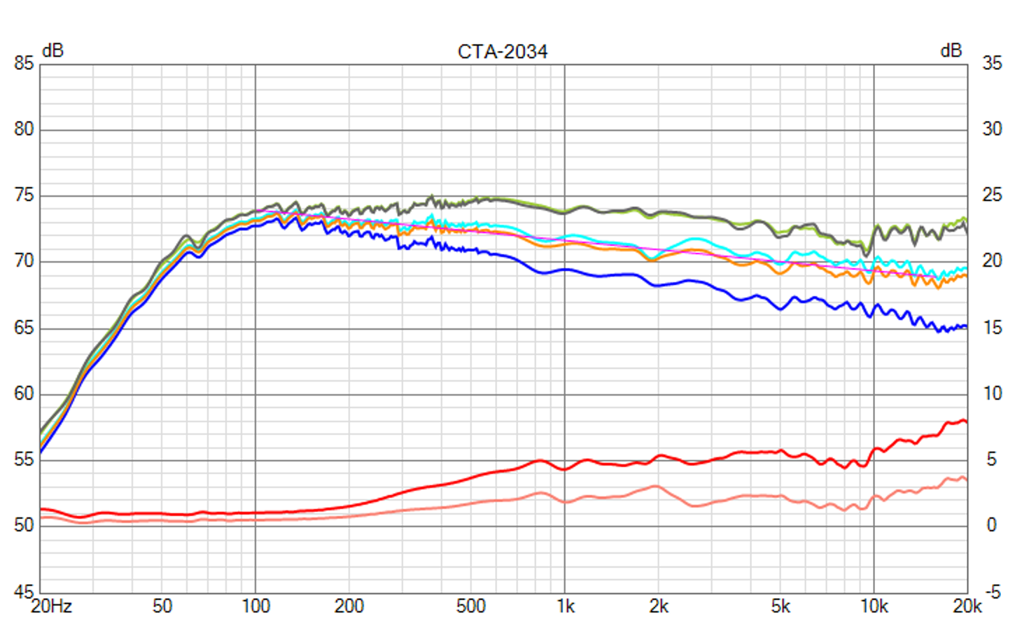

To get a reasonable match between the 6.5 and waveguide I needed to put a bit of a downslope to the on axis, this gave a nice in room slope and smooth on axis and listening window but not flat. There is a bit of diffraction between 7 and 10K where I dipped the on axis to reduce a power response increase. The crossover is at 2K which funnily enough is the same as Purifi chose for their SPK16. If it is lower which the waveguide can easily do there is a massive DI bump from there being too much directivity in the combination. A smaller waveguide could possibly allow a lower crossover or the current one needs a bigger woofer or maybe a cardioid woofer to stop the DI increase in the woofer.
In this version there is a phase offset to flatten the DI and make all the slopes smoother. I have a phase aligned version that doesn't look much worse, hard to know if one would sound really any different to the other.
I think the overall speaker looks reasonable and it has a preference rating of 8.7 with the Vituix standard options.
As these are not my own measurements I can't speak to what they might sound like. Still some way from being in a position to listen myself.
Of course the downslope could be taken out and it would make the normalized polar look prettier but it would then likely be brighter and it would cause the inroom to curve as the woofer has a natural downsloping rising DI where the waveguide is inherently flatter until 10K.

The DI of the tweeter waveguide is a nearly constant 5 dB from 1.1k to 9.5k. That is really impressive.
That is interesting. In my Purifi-waveguide project, I also found that the best CTA-2034 performance required a phase offset of about 45 degrees between the two drivers. I was able to get a plot of sound power, PIR, and DI that was nearly perfect. But in extended listening, I preferred the phase matched version, even though the DI and PIR curves were a little more lumpy.In this version there is a phase offset to flatten the DI and make all the slopes smoother. I have a phase aligned version that doesn't look much worse, hard to know if one would sound really any different to the other.

There isn't much of a surprise to me that measured reality is close to the prediction, but it really does hold directivity lower and more evenly than I thought it would. Normally this would be a benefit but in this configuration with a 6.5" woofer it makes mating the two together to not be a paint by numbers exercise. There is a 25mm roundover on these which is less than the 36mm originally simulated.
When the response is equalised for a flat on axis response with a 1.5K LR4 it looks like this
Interestingly the response is smoothest at 40 degrees off axis and if that is used as the reference axis you get a glossy brochure worthy normalized polar plot. I don't consider this to be totally representative of a real life scenario but it is interesting none the less.

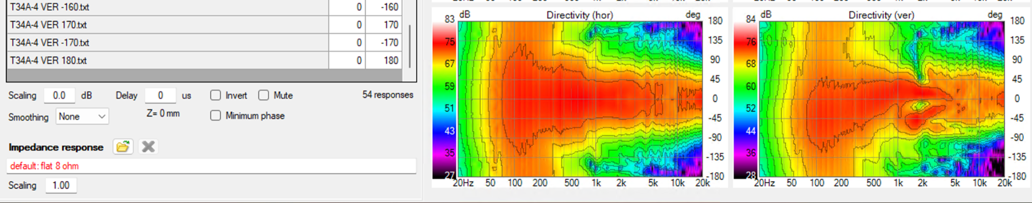

Vertical measurements were made and included in the previous Vituix scrennshots even if the directivity plot wasn't shown.@fluid, do you have vertical measurements, too? I saw you simulated the waveguide in 1/4 symmetry and I'm trying the same stunt soon.
