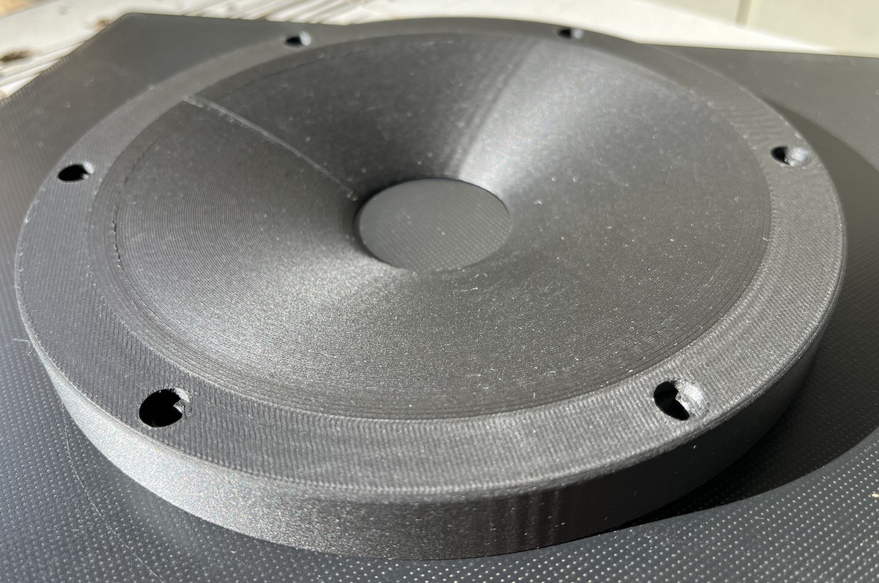

For completeness and academic interest this is the raw waveguide response without any EQ, impedance peak is at 760Hz which is very close to the value hificompass measured in his review.
To get a reasonable match between the 6.5 and waveguide I needed to put a bit of a downslope to the on axis, this gave a nice in room slope and smooth on axis and listening window but not flat. There is a bit of diffraction between 7 and 10K where I dipped the on axis to reduce a power response increase. The crossover is at 2K which funnily enough is the same as Purifi chose for their SPK16. If it is lower which the waveguide can easily do there is a massive DI bump from there being too much directivity in the combination. A smaller waveguide could possibly allow a lower crossover or the current one needs a bigger woofer or maybe a cardioid woofer to stop the DI increase in the woofer.
In this version there is a phase offset to flatten the DI and make all the slopes smoother. I have a phase aligned version that doesn't look much worse, hard to know if one would sound really any different to the other.
I think the overall speaker looks reasonable and it has a preference rating of 8.7 with the Vituix standard options.
As these are not my own measurements I can't speak to what they might sound like. Still some way from being in a position to listen myself.
Of course the downslope could be taken out and it would make the normalized polar look prettier but it would then likely be brighter and it would cause the inroom to curve as the woofer has a natural downsloping rising DI where the waveguide is inherently flatter until 10K.

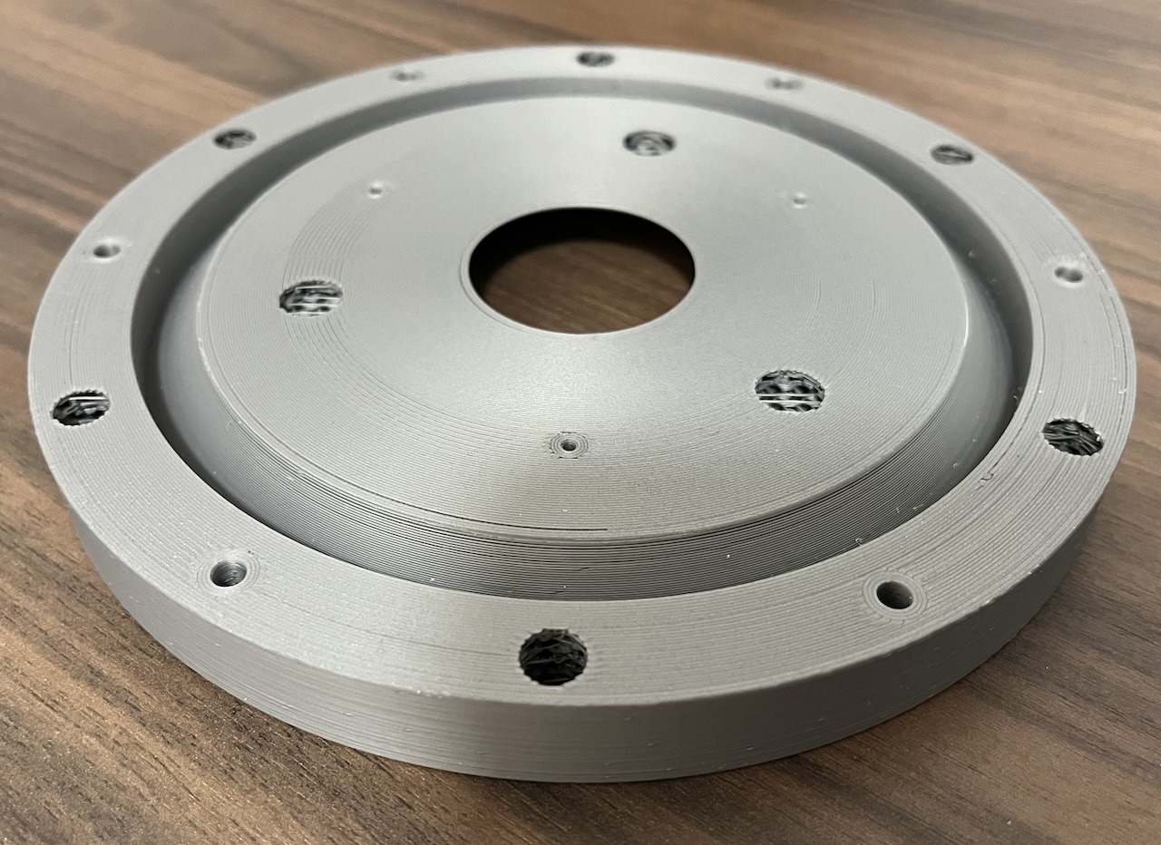

Do you have any ideas how to design such kind of waveguide?

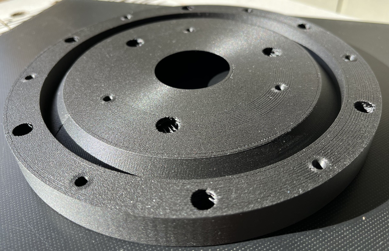

The things you want are at odds with each other. The T34A needs a very gentle large thin waveguide due to it's natural width.
To increase support for the driver and make a lower crossover possible the waveguide needs to be narrower and deeper like the ASCII one. This will produce a better match for the directivity of a 6.5" driver and does not work with the T34A.
The SB26 used in the ASCII is really good at going low, it just cannot go quite as loud due to lower sensitivity but this doesn't matter when mated to a Purifi mid woofer as they are the same.
The T34A and Purifi 6.5 is a horrible DI combination at 1K, I would imagine that the Purifi tweeter is much the same. The crossover in the SPK16 is also around 2K not by accident but because that is really where it needs to be.
The SB26 is the only dome tweeter I know that will work to produce a result like the ASCII. The SB26 narrows naturally after 10K so the phase shield like you see on the ASCII is necessary if you want the over 10K response to stay wide.
The T34A can cross at 1.5 or 1.3K easily in the waveguide I have but not with a good horizontal directivity match to a 6.5 woofer and I can see little value in choosing better vertical directivity if the horizontal is a mess unless you want to listen in the nearfield.

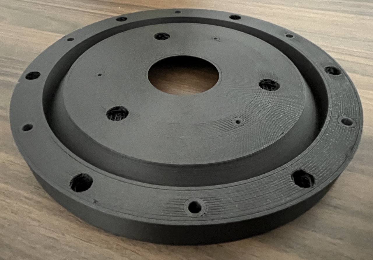

I have also considered the trade off of looks vs access. A removable back panel is the obvious solution but construction is easier and more solid with the waveguide being bolted to the front. I have considered if there is a halfway option where a magnetic trim ring is used to hide the bolts and made it look more seamless. Of course there is then the possibility of rattles and getting the right level of magnetism to make it removable but not prone to being insecure.
With my current design using heat set inserts I imagine that the tweeter could be installed through the woofer hole but it would also most likely be frustrating due to the level of magnetic attraction between bolt and driver.
