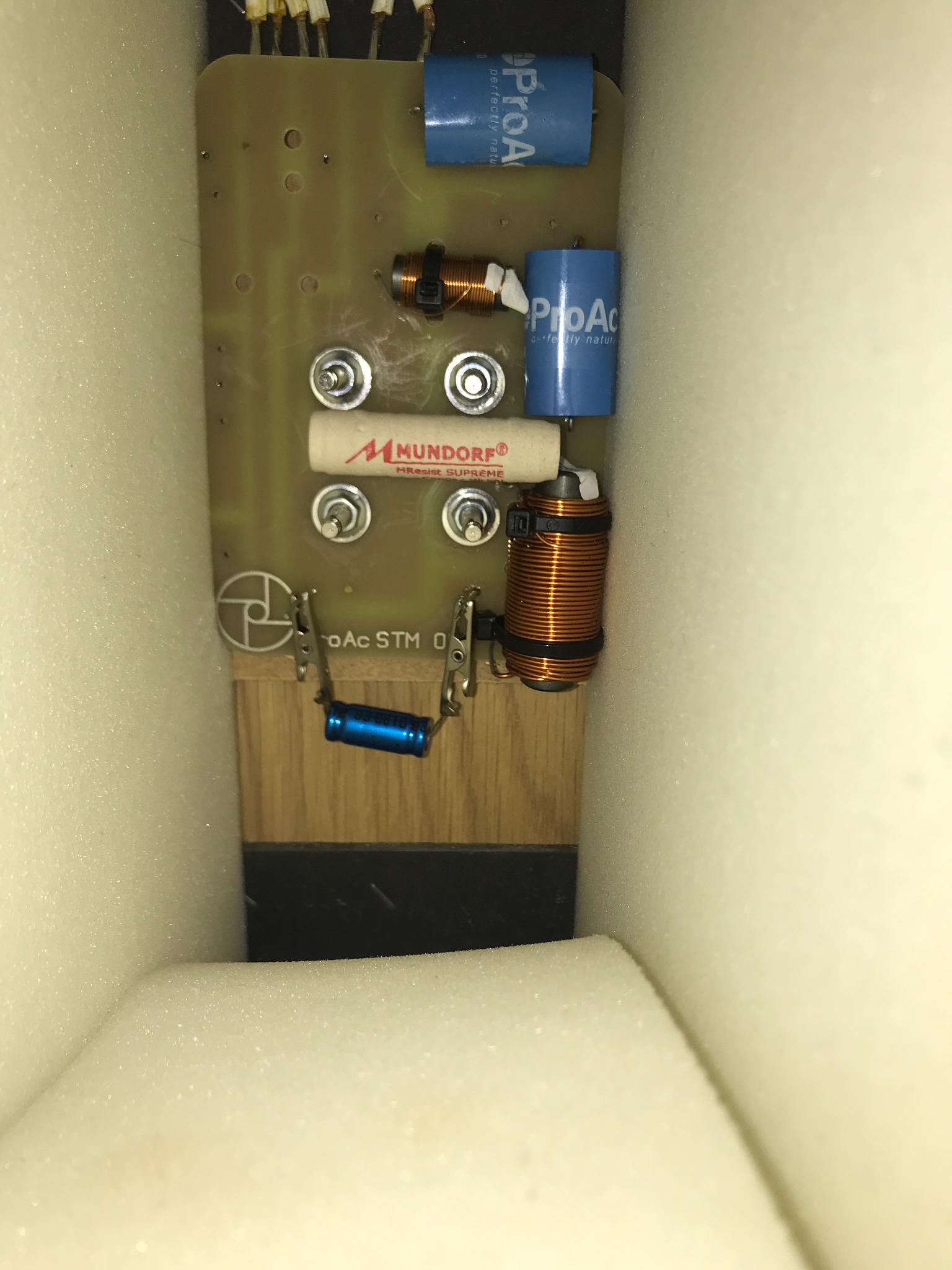

so far putting back in the electrolytics, it’s brighter. But kinda harsher too.
will report back in a bit.
definitely a difference.
Ok so I did the experiment tonight.
it’s the caps that make the difference.
i soldered the alligator clips on to the electrolytics and the polys.
so It only takes me 5 min to switch out. Open the woofer, un clip the electrolytic and clip on the poly. Simply. and vise versa
the e
electrolytics sound harsher. And yes brighter. But they do have more growl.
but the harshness is apparent when switching to the poly. The poly is quieter?
yeah the cap material makes a difference no doubt. Very clear.
the electrolytics measured 18.4uf and 18.2uf. The poly measured 18.2uf and 18uf.
very cool experiment.
the poly also give more balance between the left and right speaker. If that makes sense

So how is the sound with the corrected lythic value ? 18 uF ? 17 ? 16 ? what pleased you the most ?
Did you try with the former resistor before swaping for the Mundorf Supreme M resist ? Or did you check both at the same time the cap add and the resistor add ?
When you tweak or refurbish a filter it is better to check after a standalone part swap or you do nor know from where it comes.
The harsh & brigth (which is not the same) can involve serveral frequency bands. Note some pointed out this resistor needs several hours of burning in. Anyway it is clearer and bring more ligthness, also resolution. the swap is easy with the crocos !
Reactions: tone?
No the electrolytic was harsh. Not the poly Cap.
btw. The poly cap is a Solen jumped with a clarity cap in parallel to reach the value of 18uf. ( Solen 16uf , clarity cap 2uf)
the poly caps sound better. Smoother and maybe even quieter. If that is possible.

interestingly enough I also noticed that keeping component values tight between speakers matters as well.
that is, if the cap on your woofer in the left speaker is 18.5uf and the cap on the right speaker is 18.1uf. It will make the speakers a bit ‘off balance’.
why as well when I build my final external xo, i will get caps that are matched for both speakers in values. It’s worth paying more and requesting the seller to measure and match caps before buying them.
IIRC you measured 0.29 uF difference between the two R&L lythics. It is very tigth tolerance whatever the difference is comming from a factory setup or just sligthy difference that doesn't matter. Imho it is more that last difference. Up to you to increase or not precision and notice when your ears will not notice anymore at that cut-off. Imho it is important to solve that first has you have the luck to have mkp caps in the high pass filter (treble) that has already precise and stable capacitance value. Since the filter will be rigth with the values, you can tweak with more ease at iso values. Anyway before swapping more parts like tweeters, do not forget that the equilibrium is also comming from the devices before.
The most important is to have the rigth filter values.
