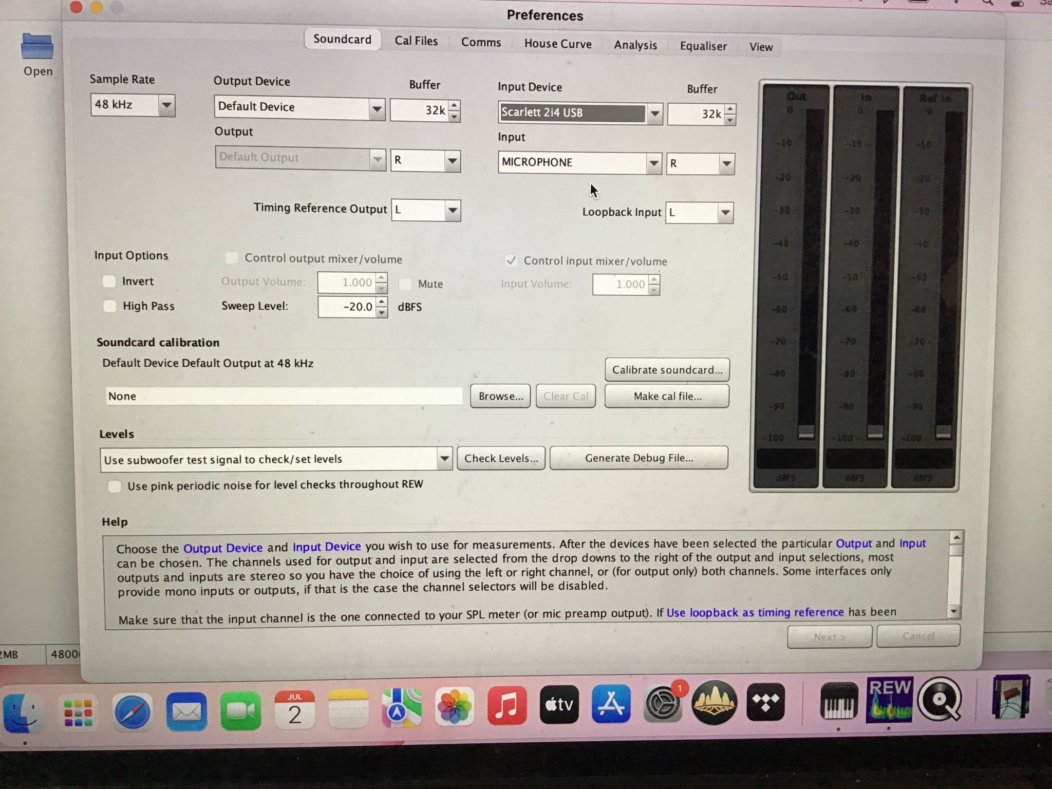

You might take a screenshot of your REW preference page and also the measurement page to post here. That will be much easier to see. On MacOS that's Shift+Command+3 (or 4 to select an area). You should be able to paste that here.

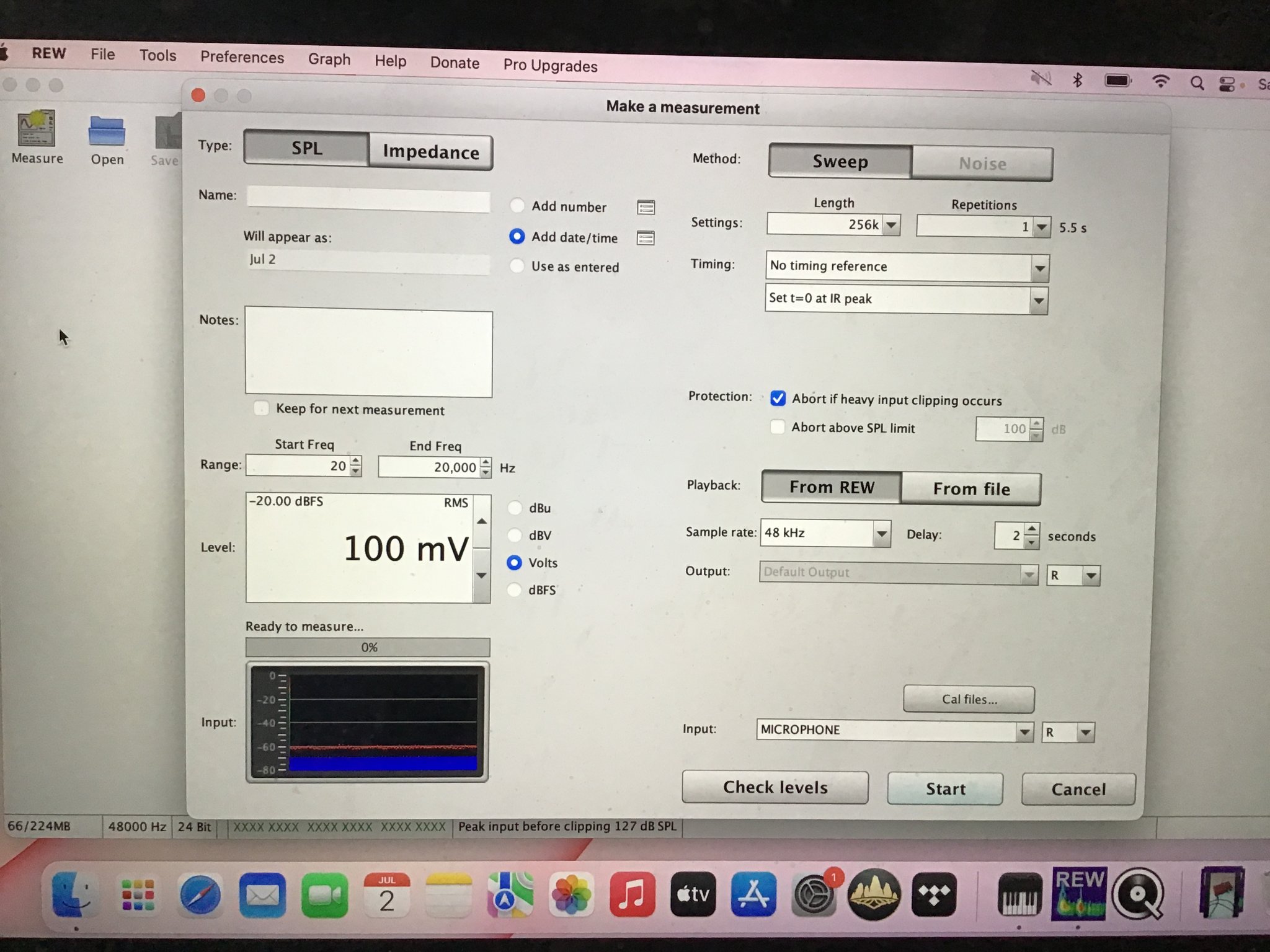

ill try the loop and take screen shots of the preference page and measurement page

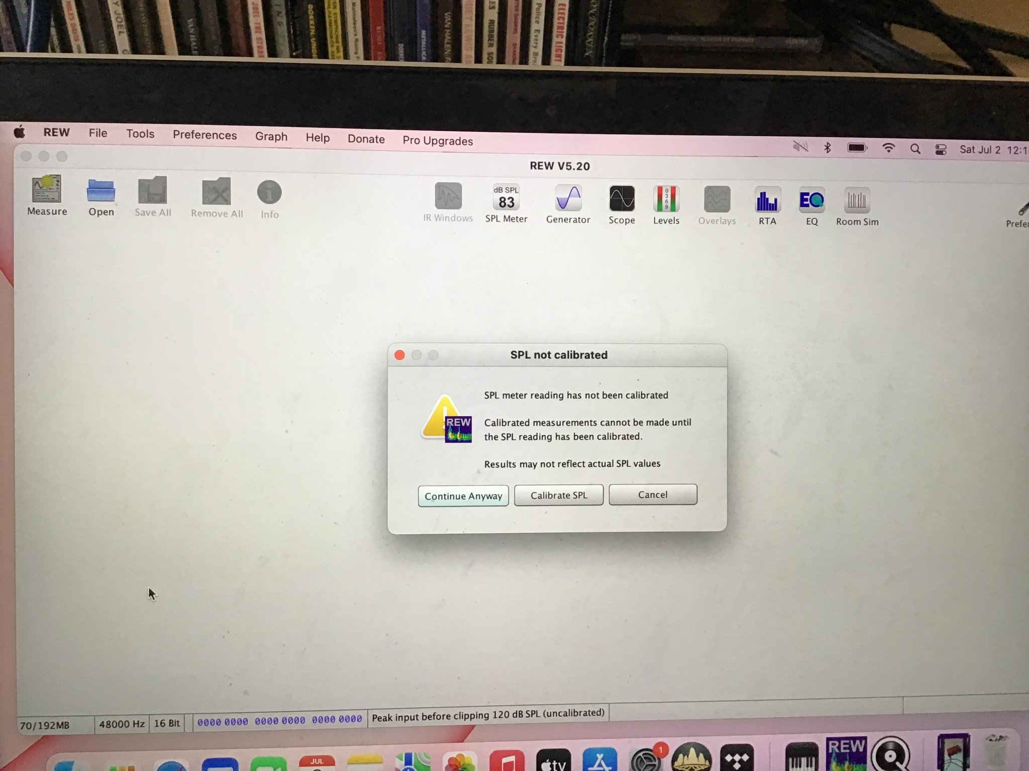

Seems that it needs to calibrate the Scarlett for some reason
how do I do that?
it thinks the Scarlett is a usb mic
how do I do that?

One thing I see right away - you had the piezo plugged into the left channel, but in REW you chose the Right channel as your input.
You don't need to calibrate, just skip that for now.
Also; try choosing the Scarlet as your output device instead of Default. I doubt that will do anything, but it's good practice. Also choose something other than "Subwoofer levels" as you test when checking levels.
Mostly, be sure that you have chosen the correct input in REW.
