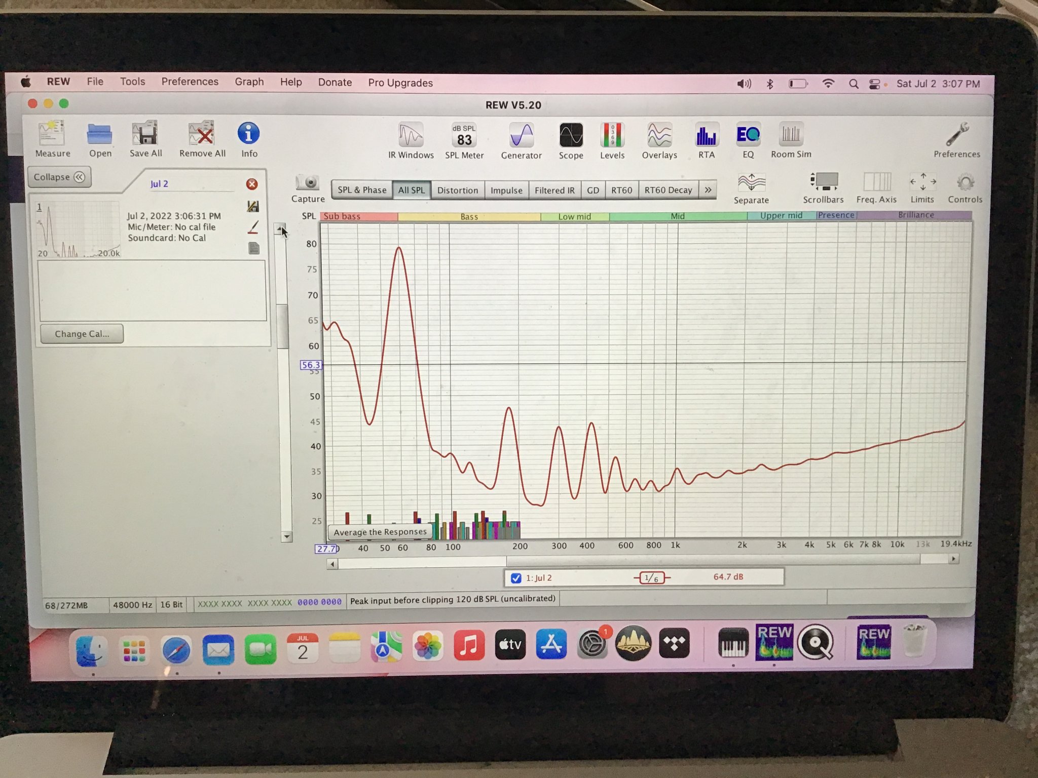

Looks good. I don't see a whole lot of ringing in there, but certainly the sound of the speaker side is strongly colored. You can see that in the frequency response. How much that adds to what you hear is difficult to determine without a sophisticated setup. But you can compare what you see now to what you can measure after modifications. You will be able to measure and see any changes you make.
As a sanity check, do a measurement with the speaker disconnected from the amp to see what noises are picked up by the piezo mic with no sound in the speaker. That way we can look for mains hum and other things.
Be sure to make a precise note of where the input volume is now set, along with amp volume and REW settings Maybe take pics, too. You want to be at exactly the same gains if you are going to measure changes.

i did do the alligator clip thing
That's mains electric noise. It's everywhere. Think of the Piezo as a guitar pickup without humbucking coils.what’s the 60hz thing?
Aren't they sealed?
is what sealed?
ah just read
yeah electrolytics are sealed. And it doesn’t take long to charge them either.
most of their charge is stored anyway. Even if you leave them without power going through them.
but they don’t unform that quickly.
and they reform as well.
they aren’t that sensitive as some say.
ah ok. So no getting around that huh?
I was responding to Ben's comment about the weather.is what sealed?
Not easily, no. It's something you have to be aware of when looking at your piezo measurements.So no getting around that huh?
