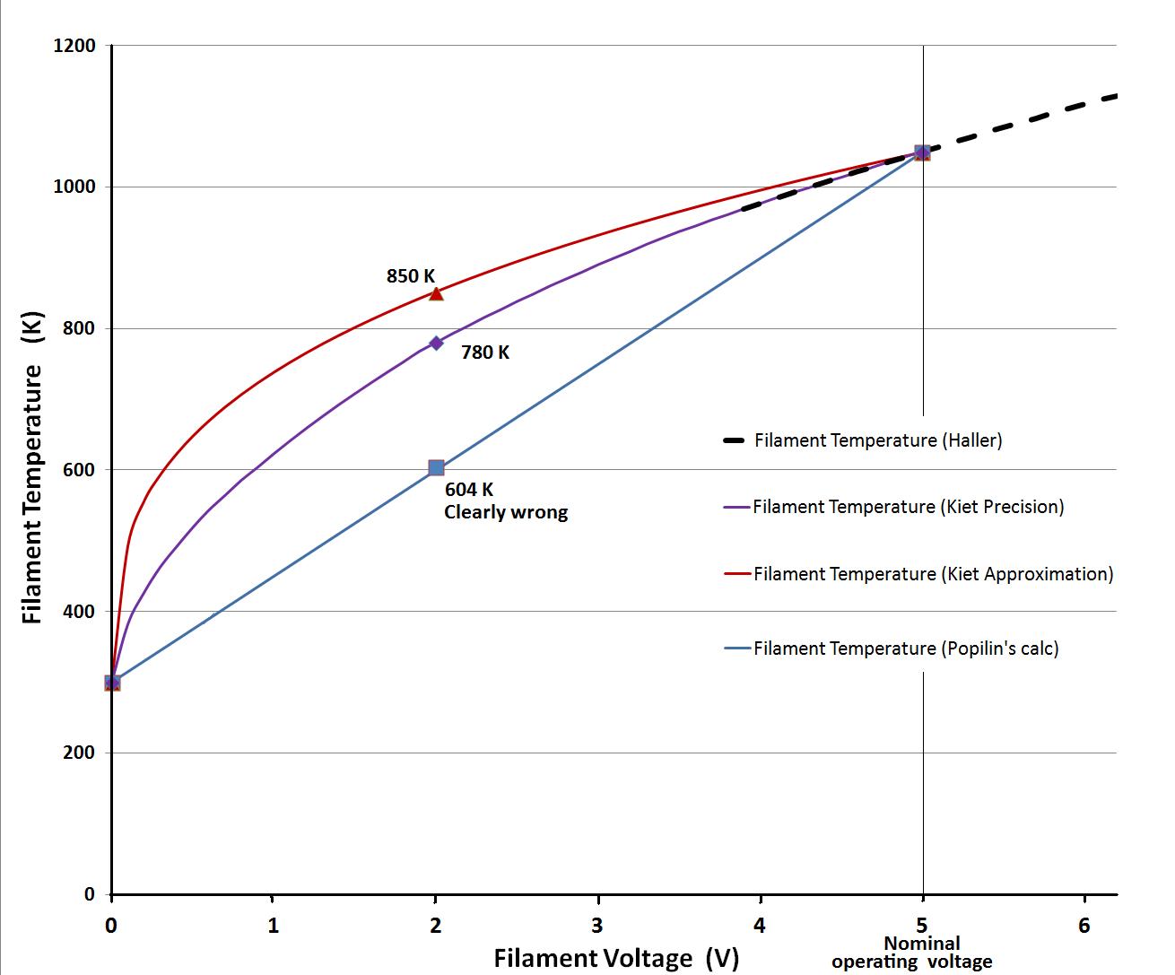

As proved in my post #344 where I calculated the electric input at 604 K and the heat output at 604 K. The two values should be about equal (within 10% or so) but they are clearly very different. You need to explain that one away, Popilin.
Let’s see
So, we can use an approximate method to find out if your 604 K is realistic.
At 5 V filament energisation, from the grey body radiation loss formula,
P = k (Tf^4 - Ta^4) = 10 W = k (1050^4 - 700^4) hence k, a constant comprising the product of area, emissivity, & Stefan Boltzmann constant, is equal to 1.035x10^-11 W.K^-4.
Then
k = Area . Emissivity . Stefan-Boltzmann constant = 1.035x10⁻¹¹ W ºK⁻⁴
Regardless of cathode area!!!
Cathode area can vary an order of magnitude; sometimes more...that’s why your calculation is like throwing dice…
Ah, now I understand, your "constant" is like your planar diode which grows up or shrinks according to your need; that is!
Very accurate and realistic…
Something like 850 K by the above quick cube law estimate:
300K + (1050K - 300K) x (2/5)^1/3 = 850 K

You said the temperature is 604 K - a ridiculously low value. I've posted two ways of checking it:-
a) comparing electric input with heat output (My post #344). You need to explain away that one - I note you have not attempted that;
b) Your 604 K value implies a linear dependence of temperature upon filament voltage. Its actually approximately dependent on the cube root of the voltage (My post #357). You need to explain away that one too - I note you have not attempted that either.
Definitely no, the temperature value is totally consistent, even when you do not understand

What is debatable is the method to measure cathode temperature, and I must agree with you that retarding potentials is not the best method, nevertheless, your “calculation” method has proven to be worse.
I got a temperature of approx 780 K for 2 V energisation.
Jo ≈ 210 mA/cm²
io ≈ 840 mA

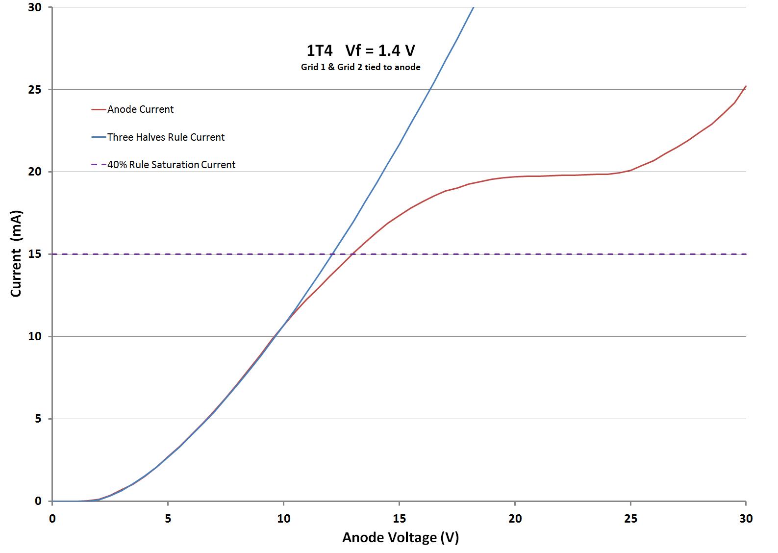

We see that the plot corresponds to the three-halves power rule up to about 10V. From 10V to about 14V, the plot veers to the right of the three-halves line. Can you say why, Popilin? I can, but I bet you cannot. If anyone wants to know, send me a private message. Otherwise, I post the answer here in a few days. It's quite simple.
Popilin, can you explain why the plot diverges away from the langmuir law between about 10 V and 12 V? I bet you can't - it's quite simple but it requires a real understanding of tubes and their construction.
I can. If anyone wants to know, send me a PM. Otherwise I will post the reason in a few days.
The question should be where is the transition point between the space charge limited region (Child-Langmuir law), and the emission limited region (Richardson-Dushman equation).
The transition point can be determined mathematically as follows
Child-Langmuir law
J = (4 εo / 9) √ (2e / m) (1 / d²) V^(3/2)
Details here
http://www.diyaudio.com/forums/tubes-valves/264781-getter-heater-b-sequencing-12.html#post4128561
Richardson-Dusman equation
Jo = Ao T² exp ( - e φ / k T )
Equating
Vt = [(9 d² / 4 εo) √ (m / 2 e) Jo]^(2/3)
For the 5R4GY at 2 V heater voltage
Jo ≈ 6.44 mA/cm²
And
d ≈ 1 mm
Then
Vt ≈ 9 V
Indeed the 5R4GY at 2 V heater voltage has a transition point at about 7 V on the Ia vs Va plot and the calculated value is about 9 V, which is remarkable, and confirms that the 5R4GY is a good approximation to a planar diode.
Let’s see your plots
As you tied the control grid and screen grid to anode, the effective distance cathode-anode was greatly reduced; at low anode voltages everything is close to normal, at about 10 V the electron cloud (space charge) is moved toward the grid plane reducing the electric field E, as a result you have a “lazy diode” until about 18 V to 20 V, beyond there, the electron cloud is depleted and saturation is reached.

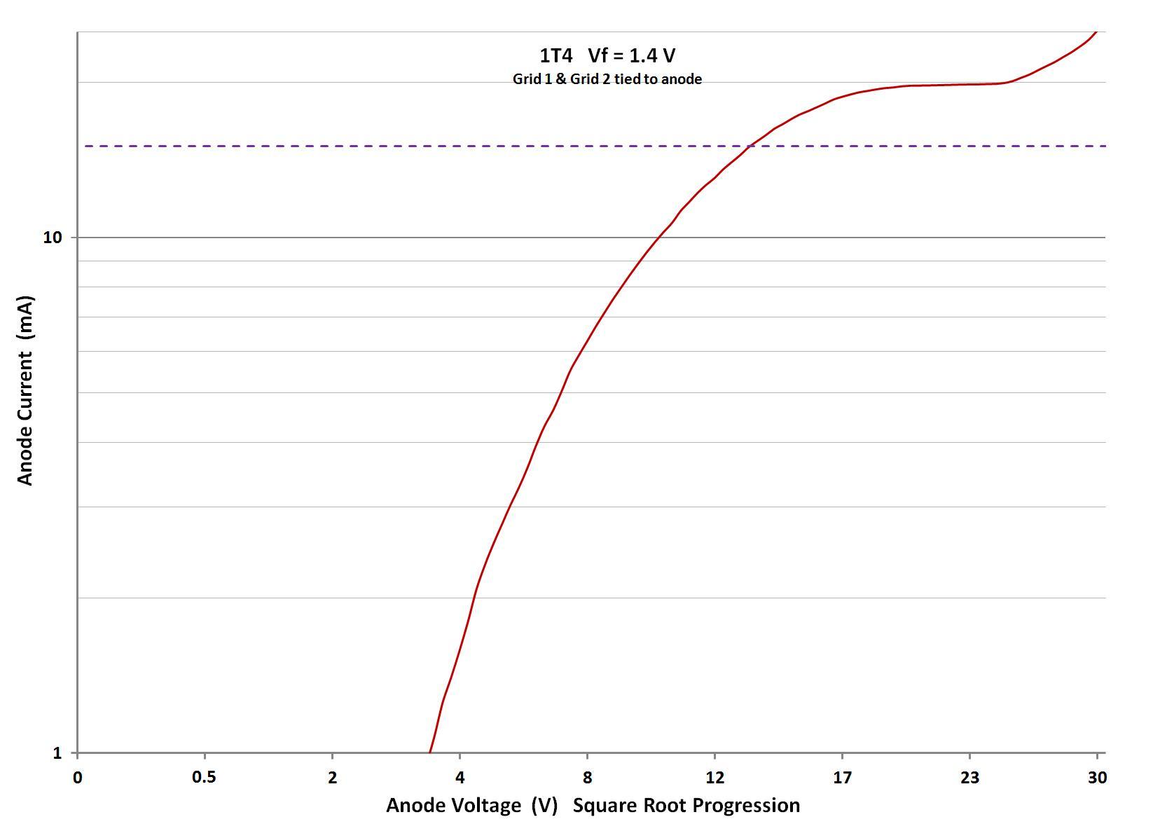

My Goodness! Total and absolutely unbelievable! You still do not understand!!!
Your understanding of physics is reduced to mere…arithmetic.
If you need x in an exponential function f(x)=exp(x) you need a logarithm with base e, i.e. f⁻¹(x)=Ln(x), not 10, i.e. f⁻¹(x)=Log(x); this is elementary, even in high school.
If you want to work with base 10, e.g. instead a calculator you only have logarithm tables, you must use the following relations
Ln(x) = Log(x) / Log(e)
Log(x) = Ln(x) / Ln(10)
As you used the wrong logarithm, you did not see Schottky effect, as the Ia vs Va plot at saturation looks almost a horizontal line, with the wrong function, i.e. Log(Ia) it looks more horizontal than before.
As a final comment, your experiment was poorly designed, with heaters at full power, you can measure almost nothing.
The software does not show the points, next time you could try this
At 2 V filament energisation, taking your 604 K temperature as correct, since resistance is approx proportional to temperature, power is approx P = V^2 x 2/5 x 1050/604 = 2.78 W.
That is for an imaginary 5R4GY, for my real sample, measured power was
P = (2.17 ± 0.01) W
Throwing dice, … , err, with your own equation
T ≈ 683 ºK

Starting with your Isat value of 3.4 A at 850 K, and your work function value, 1 eV ie 1.602 x 10^-19 J , we can calculate what the saturation current would be at normal operating temperature, 1050 K:-
I2 = 3.4 x [1050/850]^2 x e^[1.6x10^-19/1.38x10^-23 {(1050-850)/(1050x850)}]
I2 = 3.4 x 1.53 x 13.4 = 70 A.
I sincerely hope you realise that a 5R4GY will definitely NOT pass 70 amps, which it must do if your calculation of 3.4 A at 850 K is correct! The octal socket will be destroyed in seconds! The leads inside the tube will melt immediately.
Definitely no, the temperature value {604 K} is totally consistent, even when you do not understand
On the contary, itv is you who do not understand.
I explained why you are wrong before, with nothing but 1st year high school algebra (my post #357). Since you have a lot of trouble doing simple algrebraic calculations, here it is in graphical form:-
You can see that if 2 V filament energisation results in 604 K temperature as you claimed, the best fit line is very close to linear. That is simply impossible, because of the Stefan-Bolzmann law - radiation heat rses to the 4th power of temperature. Therefore, since the resistance rises with temperature so power is approx linear with voltage, temperature is proportional to the 4th root of power, and the cube root of voltage.
Notice that my approximation based on T proportional to cube root of V is much closer to the truth. The best fit curve pasing through 850 K and ambient (300 K) and 1050 K is quite realistic.
Notice that the dotted line from 4V to 6V lines up prceisely with the curve passing through my estimate of 780 K calculated with the more precise method I explained in my post #332.
This dotted line was copied from the chart on the 2nd page of Haller C E, Tube Filament and Heater Characteristics, Electronics July 1944. This chart is shown in some tube application manuals. It doesn't show the line below 4V or above 6 V because of course you shouldn't operate tubes other than close to 5V.
Haller uses a different mathematical approach to obtain the formula to me, but comes up with the same answer. So if you want to keep claiming I'm wrong, you better explain why Haller is wrong too.
Note that filaments in tubes designed by RCA can be tungsten, tungsten-molybdenum alloy, or nickel. My graph is completely applicable to tungsten and tungsten-moly. But for low voltgaes it will be a little bit out for nickel due to the Worthing exponent of nickel increasing suddenly below the curie point. At 2 V and above it will be fine.

The reason why the measured current veers away to the right of the langmuir V^3/2 line is due to the construction of the 1T4. The filament strand is 22 mm long. The anode and grids cover most of it, 18 mm. However, while most of the filament heat is lost be radiation to the anode and grids, some is lost by conduction to the filament support structure. This causes the temperature to be low at the ends.
The plot below is from a computer model of the 1T4. Notice that the temperature is pretty even in the middle 60% or so of the filament (13 mm) but it drops away rapidly at the ends. This is a compromise RCA made inorder to fit the tube structure within a miniature 7-pin glass envelope. They did implement some thermal isolation measures not used in octal tubes, which is why the ends run at 500K and 680 K.
This temperature profile means that the saturation current at the ends is low compared to the middle. As anode voltage is increased from zero, the current follows a V^3/2 law until the ends saturate. The ends become thermally limitted at 10 V, well before the centre does so. As the voltage is further increased, saturation conditions progressively move twards the centre. That is the main reason.
The 1T4 is an RF pentode. As such it has a variable pitch control grid. In the coarse pitch parts of the grid (at each end) , the screen grid field partly penetrates between control grid turns. This means that the tube acts acts as a diode whose electric field is weaker at the ends and stronger in the middle. This partly compensates for the filament temperature profile by delaying end saturation. But there comes a point (around 10V) where the temperature profile wins out - at the ends there is no more current to be had.
Filament temperature profile effect will occur in the 5R4GY as well, without any compensation from a variable pitch grid. So the veering away from the V^3/2 curve will not be a sharp inflexion like it is with the 1T4 strapped as a diode. But it will occur.

Why you thought I used base-10 logarithms is a mystery to me. But it doesn't matter whether you plot a graph with base1- logs or base-e logs, the progression up the axis is the same. That's because
Log(x) = Ln(x) x 0.4343.
( 0.4343 being Log(e) )
You seem to have a difficulty understanding graph scaling.
You didn't reveal until later that you "measured" at low currents, if indeed you did in fact measure. Rather convenient for you that you kept it quiet.
I'll stay with Microsoft Excel thanks. It can do just about anything.
And when Excel is not the best tool for the job, I use Mathcad. Excel is ideal for the sort of plots in this thread. The loading of measurements was loaded into an Excel file by the instrument control software.
Excel will show you the points if you enable points (called "markers" by Microsoft) and has very flexible options. I didn't enable them in the 1T4 plots because:-
a) Unlike a plot done manually with basic instruments, the plot was done automatically with computer controlled power supplies and metering to 4-1/2 digit accuracy, as I explained. Excel's curve fitting was turned on. So each point is precisely dead on the curve - no visible random error.
b) There's just too many points. Measurements were made at 0.5V intervals, 60 points in total - They would merge together.
We can take it from the above that Popilin:-
a) Is well aware I asked the question to test her;
b) Doesn't know what the answer is, despite claiming to know about tube physics.

I asked what is happening at 10V, not what is happening at 14V.
Child-Langmuir law
{....more formulae...}
None of that has any relavence whatsoever to what's happening between 10 V and around 12V to 13 V or so. The real transition to thermallly limmitted current as per clasic textbook plots occurs around 15 V.
Further, since at low temperatures a radiation heat loss falls much much faster than conduction heat flow, the temperature profile changes from an inverted bathtube shape to an arc. So the movement away from the classic V^3/2 space charge limmitted curve is greater the lower the filament voltage is.
That is the opposite of what your set of plots show. One reason why I supect your "measurements" are dodgy or faked.
Writers of textbooks for teaching like to show nice neat plots that match the theory presented, which is always simplified. Real tubes work differently - a point you don't appreciate, Popilin.
As it happens, I used base-e logs. But to determine the saturation current it makes no difference. Try it and see.As you used the wrong logarithm, you did not see Schottky effect, as the Ia vs Va plot at saturation looks almost a horizontal line, with the wrong function, i.e. Log(Ia) it looks more horizontal than before.
My intent was to show you that real directly heated tubes do not look anything like classic textbook plots.As a final comment, your experiment was poorly designed, with heaters at full power, you can measure almost nothing.
