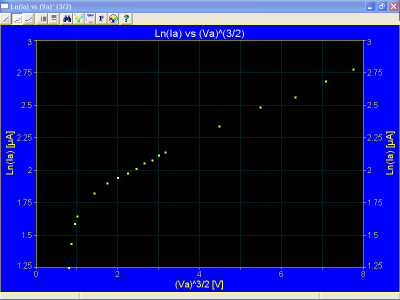

Let’s suppose an Ia vs Va plot, way before saturation obviously it must follow the 3/2 power law, i.e.
Ia = Co V^(3/2)
Then
Ln(Ia) = (3/2) Ln(V) + Ln(Co)
It is not a 3/2 power law anymore!!!
So what! You don't get it do you? A straight line in a log-vs-root plot is almost a straight line in a linear plot over most of the range. In a log plot the visual effect is that the transition from Langmuir to Schottky lines moves to the right, but the langmuir line still departs from the origin at a marked angle. Not vertical like in the plot you "naively" posted several times.
It should be obvious to you that the plot is wrong. Not just a case of sloppy draftmanship, its seriously wrong.
Why are you still defending it anyway? You are only making yourself look silly. It has been established you didn't get it from the Nottingham refrence you cited. It's best forgoten about.

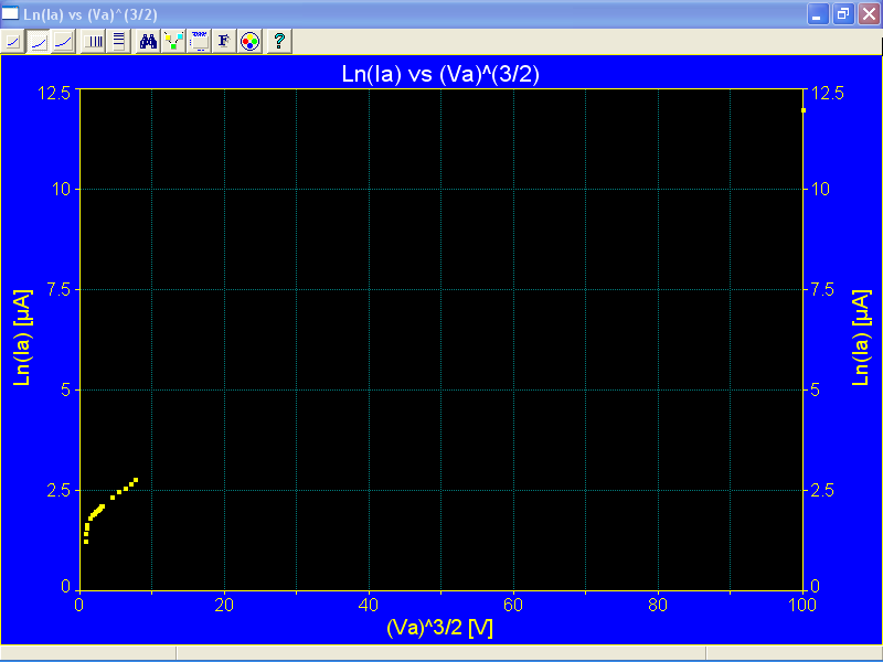

Meantime, you will be punished with...more plots! 😀
Typical plot Ln(Ia) vs √Va, 5R4GY, 1 V heater voltage
The same plot with a false point in order to change the scale factor
Yeah - another graph from another source we cannot access on line. Without the asscociated text as usual.

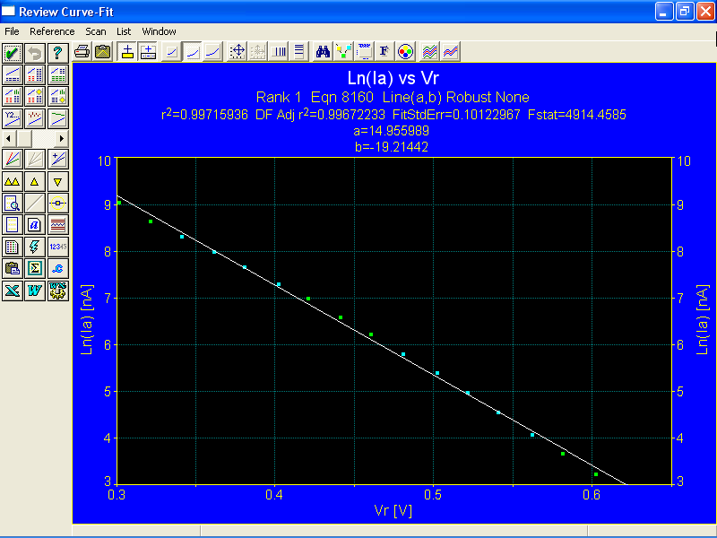

I note that you did not say how you measured it.
Yes I did, anyway if you insist…
Applying a retarding potential, Vr
Jr = Ao T² exp [ - e ( φ + Vr ) / ( k T )] = Jo exp ( - e Vr / k T )
Then you can obtain cathode temperature, T, from the slope of the straight line
Ln (Jr) = - ( e / k T ) Vr + Ln (Jo)
Or
Ln (Ia) = - ( e / k T ) Vr + Ln (Io)
From the graph
We obtain
T ≈ 604 ºK
This is bad physics. Ln(x) and sqrt(x) have different dimensions/units, and if they happen to share a numeric similarity over a limited range of values that is just a happy coincidence. The correct interpretation of gradient will always have correct dimensions, it's an easy check to make........A straight line in a log-vs-root plot is almost a straight line in a linear plot over most of the range.
It's not a happy coincidence at all. Try it and see. Draw a plot using Log-vs-root axes, and replot the same values in linear axes. You'll find that straight lines in one are only slightly curves in the other. Hence "J" shapes as in the langmiur part of the graph in a linear plot is still a "J" shape in a log-vs-root plot, but the foot of the J is visually longer.
Using Popilin's linear axes plot, the 0 V intecept appers to be 7.5 mA. Try it and see. Doing it correctly, with log-vs-root values, it's 9.1 mA. So, yes, using a linear plot results in an error, but I was showing that Popilin's "measurement" is not believable. Only the order of magnitude is needed to do that.
..... etc etc
We obtain
T ≈ 604 ºK

Re 5R4GY filament temperature, which Popilin says is 604 K at 2 V energisation:-
If Popilin was anywhere near as good with math/physics as he claims to be, he would have spotted something obvious:-
Given ambient temperature is approx 300 K, a filament temperature of supposedly 604 K at 2 V filament voltage, and the standard cathode temperature of 1050 K at normal voltage (5 V), it all implies that temperature varies directly proportionally with filament voltage. That cannot be.
Try it and see: 300 + (1050 - 300) x 2/5 = 600 K.
But due to the formula for radiated heat, wich arises from the Stefan-Bolzmann law, P = k (Tk^4 - Ta^4), and electrically, P is approx proportional to voltage (due to resistance rising with temperature), temperature is thus approx proportional to V^1/3.
So the relationship between temperature and voltage is nothing like linear. Tubes strongly regulate their own cathode temperature. Dropping the heater voltage to 40% of the normal value will thus result in a temperature way above 600 K. Something like 850 K by the above quick cube law estimate:
300K + (1050K - 300K) x (2/5)^1/3 = 850 K
In practice, its a bit lower than 850 K due to some conduction loss (proportionately higher cf radiation, at lower temperatures), resistance is not quite linear with temperature, and anode temperature will fall below the normal level, radiating back to the filament a bit less.
Popilin should have realised his 604 K cannot possibly be right as soon as he got it. It took 5 minutes to type this, but about 1/10th of a second to think it.
This is the sort of sanity check that good engineers and physicists do all the time. Not Popilin apparently.
I can do more: post the whole thing on the forum. If the moderators find it inappropriate, they can always remove it
Many thanks. The link provided by TrippleM works as well.
{Did not state how 604 K was arrived at}
Yes I did, ......
You came up with the 604 K value in your post #339
Cathode temperature, measured with retarding potentials, at 2 V
T = (604 ± 25) ºK
That's all you said about it. Clearly the "+,- 25" bit is entirely your imagination.
"measured with retarding potentials" is hardly setting out how you arrived at the temperature. How was it measured? With what equipment? There are several different methods derived from retarding field theory, all with varying degrees of none too good inaccuracy and various levels of test equipment complexity, eg the methods of Hienze & Haro, Sentaro, the sawtooth and AC methods of Takada, the harmonic method of Ikehara. Which one did you in fact use?
From the math you quoted, it seems you used the simple static (DC) method, which is the most hopeless method of all, as Ikehara stated in his 1953 paper. You did not, for instance, give any math for the harmonic method.
The 5R4GY is directly heated. Why one earth did you go for a complex inaccurate method (static retarding field plot), when you could have just measured the filament current, calculated the resistance from Ohm's Law, and then derived temperature from Worthing's Law. Quick, simple, and even without the tweak for conduction loss at the ends, sufficiently accurate for the purpose?
