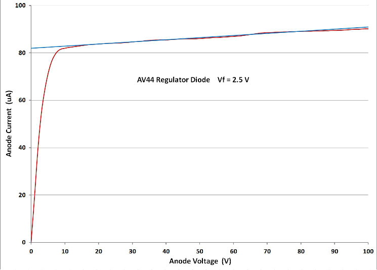

And as I pointed out to you before, your monochrome graph puporting to be for a pure tungsten cathode simply isn't. There's way too much change in Ia when compared with measured data for actual pure cathode tubes such a the AV44 regulator tube.
No Keit, please read the title:
Logarithm of thermionic emission current I of tungsten as function of square root of anode voltage Va. (After W. B. Nottingham, Phys. Rev., 58:927–928, 1940)
Clearly, the plot corresponds to Ln(ia) vs Va, and I must repeat over and over…

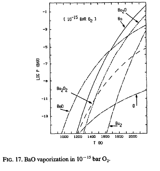

Concerning evaporation of BaO and (lack of) dissociation, here's confirmation that vapour pressure of Ba arising from evaporation of Ba-O is small:
http://www.nist.gov/data/PDFfiles/jpcrd326.pdf
High Temperature Vapourisation Behaviour of Oxides II. oxides of ..(..)..Ba...(..)..
Lamoreaux and Hildenbrand and Brewer 1986, p430:
"Recent mass spectrometric invetsigation in our own laboratory (Lamoreaux and Hildenbrand, 1983), however, show that under neutral conditions the ratio p(BaO)/p(Ba) is greater than 100....."
Attached is a clip from p430 which shows this graphically versus temperature.
Even below nominal cathode temperatures, condensation of intact BaO should significantly exceed that of Barium. As H/W also reads.
But how relavent is this? Not at all relavent, it seems.
The text states that the data used to plot the graphs were calculated for evaporation of BaO. They make the point that for evaporating BaO, you won't get just BaO gas, you'll get traces of other species, eg Ba, O, Ba2O, BaO2, etc. Nothing remarkable about that - evaporation is driven by temerature, which also drives dissocaition.
However, these calculated results do not allow for activation - which happens in vaccum tube manufacturer and results in loss of oxygen and excess Ba atoms in the matrix. You can't have much Ba vapour if there was practically no Ba to start with.
Furrther, the authors state on page 430 that their calculated result does not agree with measured results obtained by several other independent researchers. But they don't describe the descrepancies, nor do they explain them. Not very confidence inspiring.

H/W Vol 1 fig 54 gives the evaporation rate of BaO, but Ba isn't mentioned. The data was obtained from a paper by Claasenn & Veenemans and is for unactivated BaO - their experimental apparatus did not provide for activation.
H/W Vol 2 fig 82 and fig 83 show that the vapour pressure (at tube temperatures) of Ba is about 10^9 times that of BaO, which agrees with Ba data in the CRC handbook and the BaO data given in Blewett J P, Liebhafsky H A, Henneley E F, The Vapor Pressure and Evaporation Rate of Barium Oxide, J Chem Phys 7 478 1939.
In order to be condensed, each species has to be evaporated (from the hot cathode) in the first place.

H/W Vol 2 Sec 6.31.2 p261 Evaporation of Excess Barium states published figures for rate of evaporation of Ba from a Bao/Ba cathode, in units of ug per hour per cm^2. At temperatures typical of oxide cathodes, this rate of evaporation can be directly contrasted with the (far faster) rate of evaporation of BaO published in Vol 1, and I've previously posted an overlay of these two results showing precisely that. Lamoreaux and Hildenbrand and Brewer appears to confirm this..........
Pointers are that BaO is the primary evaporate here, and presumably that is what condenses mostly on the grid. We'll soon see !
Well, it says on page 262 that Kawamura measured the Ba evaporation rate at 7.5 ug.cm^-2.hr-1 at 1200 K. Fig 54 shows the evaporation of BaO at 1200 K to be about 2 ug.cm^-2.hr-1. (I think you may have gone on Becker's measurements, which were not applicable to "modern" oxide ctahodes, being about 2 orders of magnitude too low.)
So, it appears from that Ba still predominates, but only just and by nowhere near as much as I anticipated.
But wait....
H/W gets that figure from Kawamura H, On the evaporation of oxide cathode, Journ. Phys. Soc Japan 1946 (8).
That paper says that Kawamura measured it as follows:-
He used a special vacuum tube with an oxide cathode, and anode, and a grid wire outside the anode. It was constructed so that (judging by the drawing, by inverting the tube) the anode could be slid at will up and down. With the anode down, the anode shields the grid from cathode vapour. With the anode up the grid is exposed to cathode vapour.
He activated the cathode by a variation of the usual procedure not adequately explained.
He then operated the tube with anode up (thus exposing the grid to the cathode vapour) and periodically lowered the anode (blocking cathode emission) and measured the grid-anode current with the cathode emission blocked.
He thus did not measure the Ba mass transfer directly. He inferred it by the degree in which grid emission increased over time.
Interestingly, if you are correct and BaO is the dominant vapour species, he was really measuring that! He just assumed that the grid emission was due to Ba and not something else. He thus assumed that the cathode vapour was Ba and nothing else of significance. Perhaps he had good reason to assume that. Perhaps he didn't.
His measurement intervals were extremely short, minutes. Nothing like the 20,000 hour typical life of a commercial vacuum tube. I don't know how he accounted for general tube gas - he may simply not have. And his grid was a simple bent wire. Doesn't sound an accurate method. There no mention of any getter to soak up the oxygen (which must be liberated at the same rate as Ba), which would affect the test.
All things considered, I don't think we can rely on it.

I digitised the anode current (Ia) vs anode voltage (Va) plot from the datasheet and used a curve follower macro in CAD software to produce a list of plot points, at each 0.5V Va increment. I then imported the list into MS-Excel so I could re-plot with both linear and log(Ia)-vs-root(Va) scales. I applied a sliding 5v-wide Hamming window to smooth out digitisation errors.
Here is the log(Ia) vs root(Va) plot:-
I have included a "schottky line" it appears to fit pretty good. But more about that later.
Here is a plot included by Popilin in several of his posts. He claimed it represents a pure tungsten vacuum tube.
attachment.php
We see that Popilin's plot in no way resembles any real pure tungsten tube, and I'm not talking about it apparently taking 2,000,000 mega-amps at 1 kV - presumably a typo.
The first thing we notice is that Popilin's plot has the "schottky line" way way too steep - unbelievably steep. All the pure tungsten types (noise diodes, regulators) I've seen data for have it just about horizontal. For a doubling of voltage, Popilin's schottky line inceases 24% whereas the AV44 line increases only 4%.
The second thing we notice is that Popilin's plot to the left of the transition away from the "schottky line" (ie below about root 36 volts, "6" on the scle provided) is completely wrong and impossible. There ought to be a definite slope starting from the origin, following the V^3/2 Langmuir law out from the origin.
We can conclude that Popilin's plot was drawn up not from measuring a real tube, and also not from any proper calculation for a pure tungsten cathode tube, plotting dots notwithstanding tube. It's a fake. It was obviously drawn up by someone not familiar with tube physics, and definitely by someone who has not worked with such tubes in a laboratory or engineering workshop.
Here is the same AV44 data plotted with linear scales as is usually done:-
We see that:-
1) A straight line is still a good fit to the "schottky line". This will not be surprising to any engineer accustomed to graphing data - A straight line function in linear axes is still a straight line in log-log axes, and over the range used here, there's little difference between a log scale and a root scale.
2) Some ripples in the plot are more visible. It is the nature of log scales to de-emphasize small errors in plotting. These are in the original datasheet and can be assumed to be dafting error arising from the use of a lead-line (People who did tech drawing before computers will know what a lead-line is - a length of Pb between 2 stainless steel flat springs - an alternative to french curves) or lab measurement error - no 5-1/2 digit multimeters existed in 1948.
3) It would be equally valid to assume the "schottky line" is curved slightly, assymptoting to a horizontal line, and is not a sloping straight line. Given the plotting errors as large as they are, you can't actually tell, but there's a hint.
We most likely could tell if the plot was extended to 200V, but unfortunately although the tube is rated to take 200V, the datasheet plot stops at 100 V.
As I posted previously, the slope past the transition point, and the lack of sharpness in the transition from space charge limitted region to the emission limitted region, are both due to practical tube geometry. End effects distort the electric field and cause the transition to be different at different positions along the filament. The saturation current varies because the residual space charge varies.
The filament consists of a single tungsten wire under tension. The practicalities of manufacture mean that it is not exactly centred and parallel on the anode cylinder axis - this also means the electric field is uneven along the filament length - again the saturation varies along the filament length.
Here for completeness is Popilin's alleged tungsten cathode tube re-plotted with linear scales:-
The schottky line, which was pretty steep, is thus now seen to be very slightly curved.
The pre-transition region (below 6V) is even now still clearly seen to be nothing like the normal three-halve power law increase from zero anode volts. A practical tube with a saturation point at only 6V would be pretty remarkable anyway, let alone one that can take 1 kV on the anode.
If you are checking that individual points match up with Popilin's plot, please take into account that the horizontal axis in Popilin's version is not an accurate square root progression - the "20" mark is slightly to the right of where it should be for some reason (drawn up "feehand" with MS-Paint or similar and not plotted from a calculation?). But the schottky line in Popilin's version is ruler straight.
