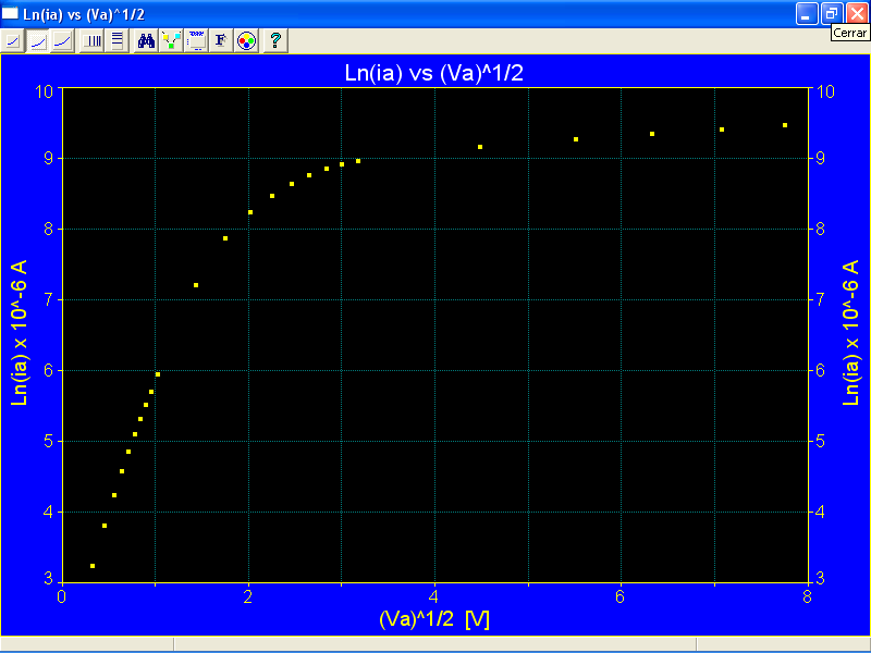

Obviously, the accelerating electric potential, Va must be referred to the emitter surface…..
Ah, at last. Your English is a little imprecise - do you mean Va is the voltage at the cathode surface?
….. now if the emitter surface is a valve cathode surface; Va becomes the electric potential of the anode with respect to the cathode, aka anode voltage, as you clearly understood a long ago
No, that's incorrect. The anode voltage is not the voltage at the emission surface.
If there is any possibility to ruin a definition, you surely will find it. 🙄

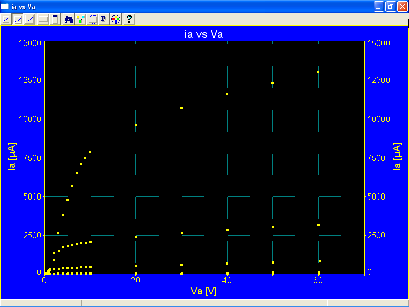

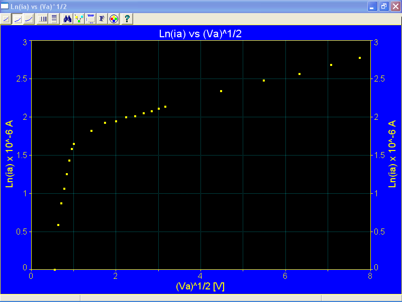

Seems you are the guilty one there. A glance at the pure tungsten type datasheets show the Ia vs Va line is practically horizontal once saturatioj is past, varing only a few percent attributable to end effects & such.
As you did not understand the scale factor issue, you also do not understand that Ia vs Va is the wrong plot in order to search for Schottky effect, as I said before, you must plot Ln(ia) vs Va
Measured ia vs Va for an oxide coated cathode, for low cathode temperatures, also look practically horizontal, however the correct plots Ln(ia) vs Va look like as they should be
Five plots ia vs Va
attachment.php
Ln(ia) vs Va corresponding with the previous first plot at the top
attachment.php
Ln(ia) vs Va corresponding with the previous last plot at the bottom
attachment.php

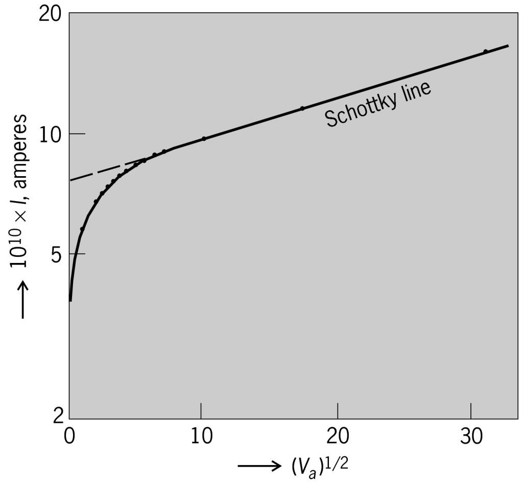

Surely you will complain about that, so I will repeat the plot for a tungsten cathode
Logarithm of thermionic emission current I of tungsten as function of square root of anode voltage Va. (After W. B. Nottingham, Phys. Rev., 58:927–928, 1940)
attachment.php

As you did not understand the scale factor issue, you also do not understand that Ia vs Va is the wrong plot in order to search for Schottky effect, as I said before, you must plot Ln(ia) vs Va.......
{lots of graphs of the same thing as before}
Why do you keep up with this nonsense?
As I pointed out before, it matters not a whit what scales you choose to graph with, or whether the axes be log, lin, square root, or freddy frogs.
What matters is the percentage change in Ia for a given range in Va. Or, if you like, the percentage change on Ln(Ia) for a given range of root Va.
And as I pointed out to you before, your monochrome graph puporting to be for a pure tungsten cathode simply isn't. There's way too much change in Ia when compared with measured data for actual pure cathode tubes such a the AV44 regulator tube.
If you vary the cathode temperature, then the saturation curent & voltage changes, the magnitude of the saturation currents change, but the shape essentially does not, the percentage change does not change, and that's what the data on real tubes shows.
Now, consider this: Assume a planar diode (that is a diode with flat cathode near a flat anode). Let's say the cathode-anode spacing is 5mm. Let's say the anode voltage is +100 V. The electric field is thus 20V/mm - we can assume the space charge is well depleted. The anode current will be whatever it is, as a function of the tube dimensions, cathode temperature, schottky effect.
Now, increase the anode-cathode spacing to 20 mm and the anode voltage to +400V. The electric field is still 20V/mm.
According to you, the current will be greater, as you think schottky effect is driven by anode voltage. It ain't so - the current will be the same as before.
Don't just tap your head against that Keitponite - get well back, and take a run toward it, screaming "Aaagggghhhhh!"
Then, with that planar diode with 20mm cathode-anode spacing, insert a grid exactly half way between the cathode and the anode. Put +200V on it. The electric field everywhere inside the tube structure is the same as before - a nice even 20V per mm. The grid will take some curent from the anode, but that doen't matter. Which are you going to regard as the Va for estimating schottky effect - +200V on the grid, or +400V on the anode? Think about it and what it means.
