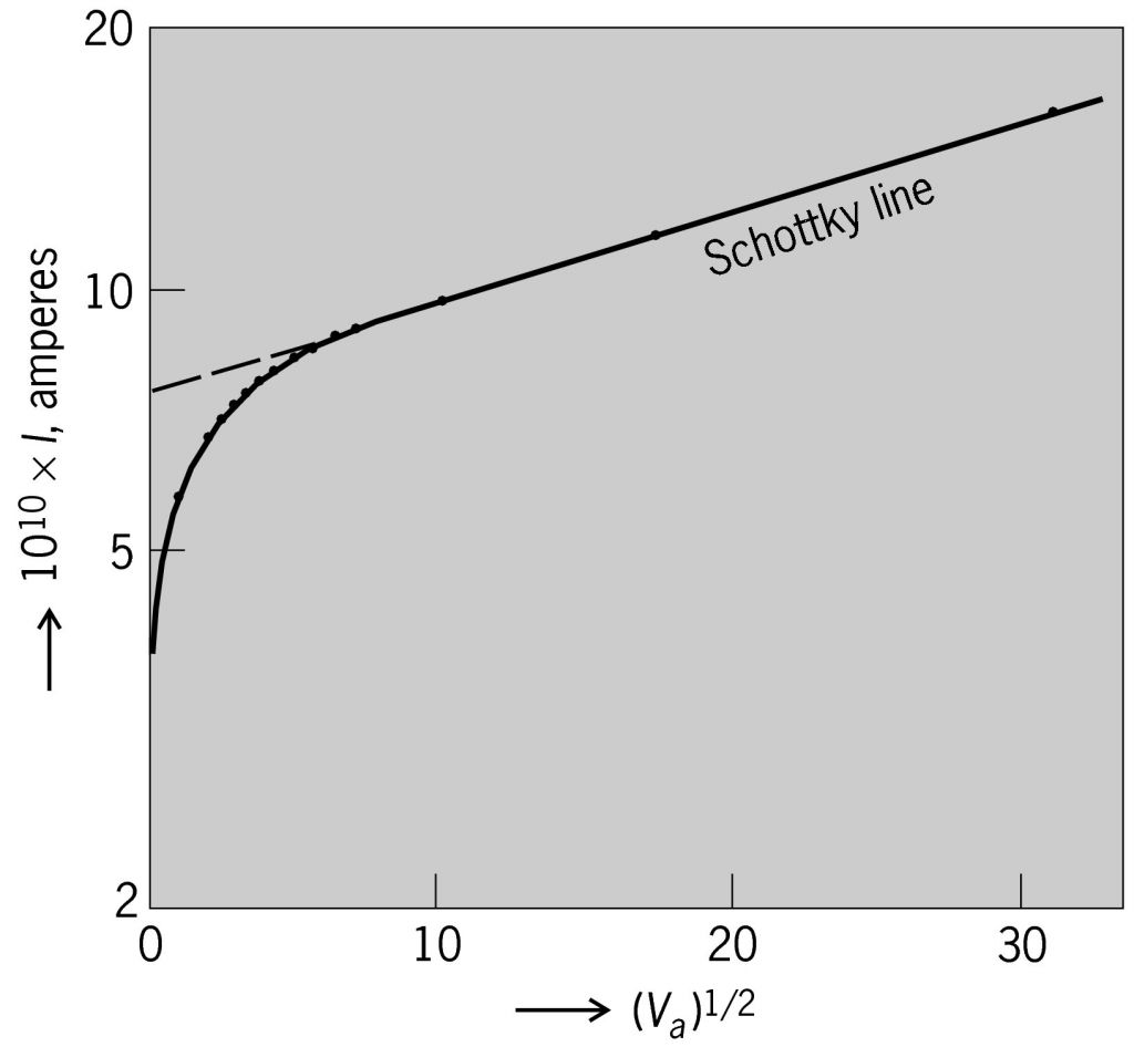

You can see the difference between pure metal cathodes (no schottky effect) and oxide cathodes (small schottky effect) quite easily. Plot anode current vs anode voltage for a pure tungsten cathode diode, eg an A2087 noise diode and plot for a small oxide cathode diode such as a 6AL5, at lowish filament voltages. You'll find that with increasing anode voltage past the emission saturation point, the pure tungsten diode clearly assympotes to a horizontal line, whereas the oxide cathode diode assymtotes to a line somewhat slanted upwards.
You have no idea about Schottky effect.
Experimental data for an oxide coated cathode
Logarithm of thermionic emission current I of tungsten as function of square root of anode voltage Va. (After W. B. Nottingham, Phys. Rev., 58:927–928, 1940)
The upward slanting is not entirely due to schottky effect - the net flow of current causes resistive I^2xR heating in the oxide layer, not entirely balanced out by the surface cooling effect of loosing energetic electrons.

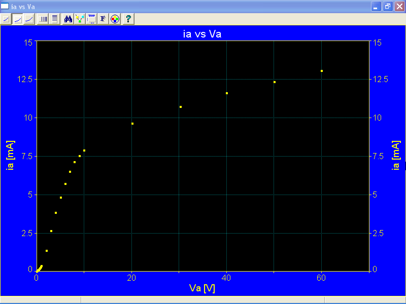

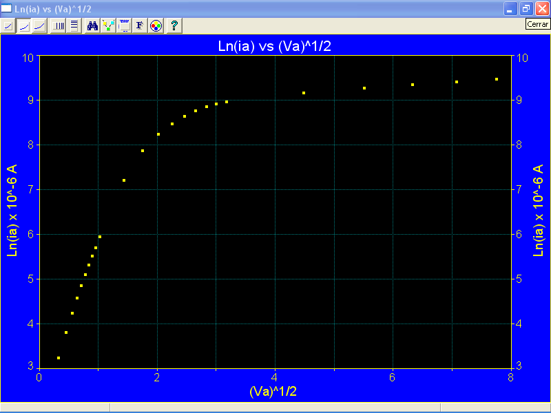

Popilin has provided a graph of anode current vs andoe voltage, showing an upward slope. It's of very limitted value because he's said absolutely nothing about how it was measured or what it was measured on (tube type? static curve or dynamic?) but is roughly in accordance with what I said in my previous post.
He hasn't provided a graph for a pure metal cathode tube which, as I said, would show the assymptote line to be horizontal.
What disappointing, you are not able to interpret a graph, I posted two of Ln(ia) vs √Va, one for the oxide coated cathode of my poor 5R4GY, and other for a tungsten cathode.
Here is the corresponding graph for ia vs Va, again for my 5R4GY
BTW, the graph is self-explanatory, maybe you need the name of the seller... 😀

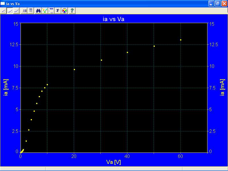

I cannot see any horizontal curve
http://frank.pocnet.net/sheets/084/a/A2087_GEC.pdf
You are confused by a scale factor, very common mistake. 😉
Make the curves with current expressed in µA and you will appreciate the correct slope, manufacturer did not this by the way.

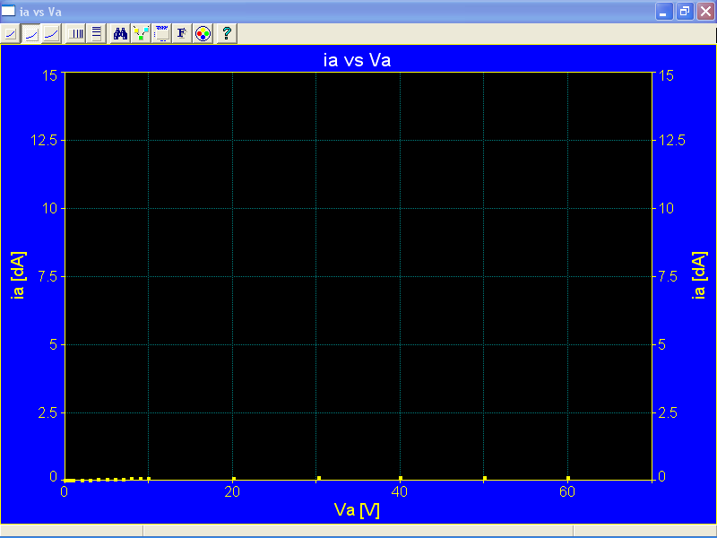

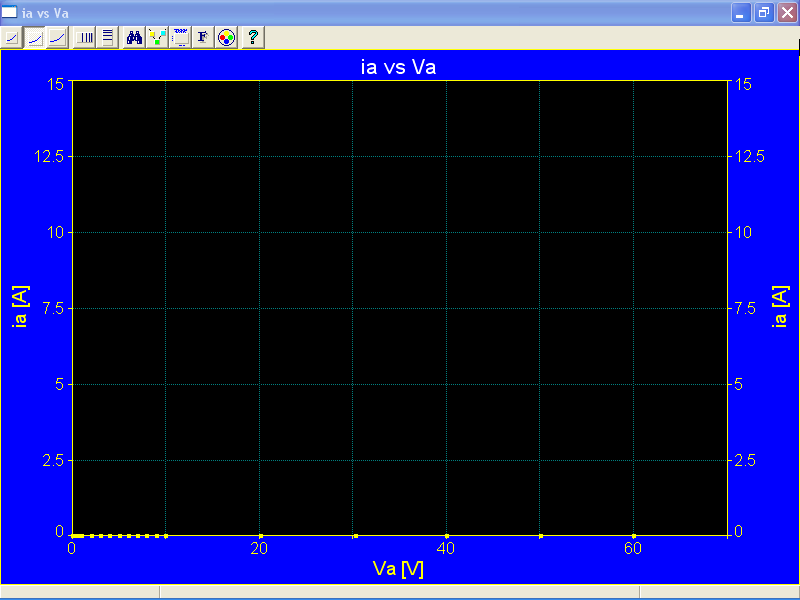

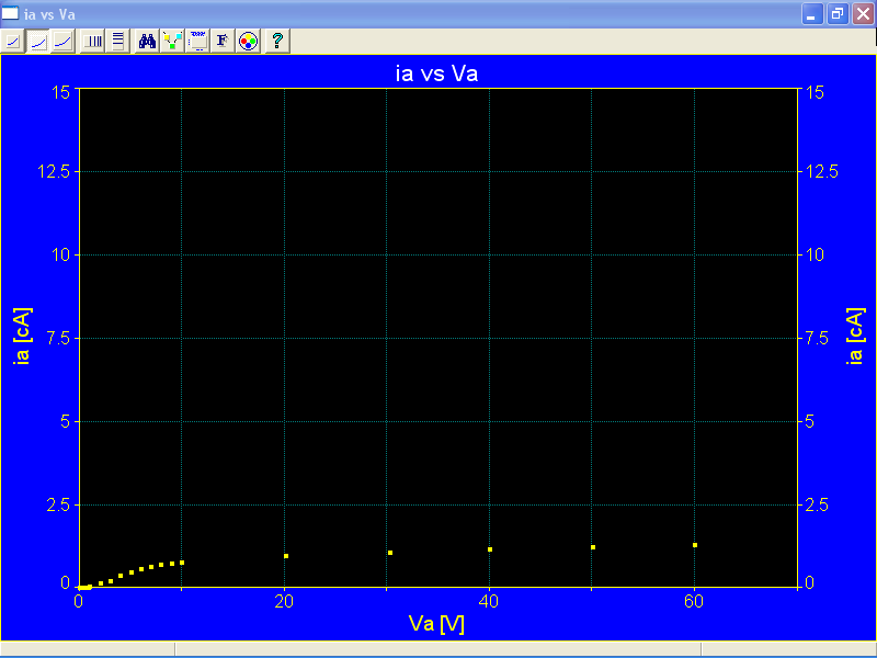

Just to avoid complains about the scale factor issue, here are the plots, exactly the same data, but different scale factors.
ia expressed in mA
ia expressed in cA
ia expressed in dA
ia expressed in A
All data are available to anybody who need them, I also could provide a link to a demo software.

You must be blind or have bent eyes then.I cannot see any horizontal curve
What nonsense is this? microamps or milliamps, or whatever units you like, it makes no difference, the shape is the same.
What nonsense is this? Why do you do these silly repetitions?

You repeated the plot several times at different scales. Why? It proves nothing. They are just progressively more useless as the plot range becomes too small to read.
