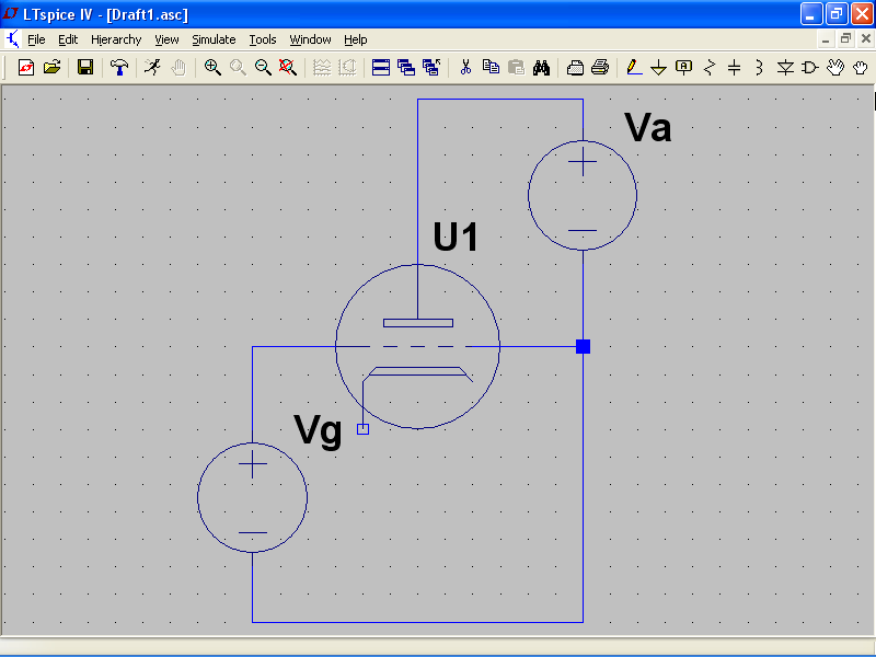

Third world style experiment
Some small RF triodes have more than one grid connection, in the case that these connections are separated for both grid rods, the grid can be heated with a PSU and it can be like a cathode.
Grid material is not so important in order to compare a new one with an old contaminated grid, let's suppose a molybdenum grid.
e φ = 4.15 eV,..... Ao = 55 A/(cm² ºK²)
Then, at 1000 ºK
Jo(Mo) ≈ 6.7 x 10¹ A/cm²
This means, for a typical receiving valve with grid surface of about 1 cm²
io(Mo) ≈ 6.7 x 10¹ A
This should be almost immeasurable for a new clean grid, but for an old contaminated grid, e.g. with Barium
e φ = 2.52 eV, ..... Ao = 0.06 A/(cm² ºK²)
Then, at 1000 ºK
Jo(Ba) ≈ 1.19 x 10 A/cm²
Supposing that almost all grid surface is contaminated
io(Ba) ≈ 1 x 10 A
This is easily measurable with a picoammeter.
Unfortunately we cannot follow the standard procedure as on post#138, because with a retarding potential, current will be too low, then forget to measure grid temperature and work function, but not all is lost, we can measure emission.
Again, from Richardson-Dushman equation
Jo = Ao T² exp ( - e φ / k T )
Applying an accelerating potential, Va, for a high value enough, current density reaches its saturation value, Js
Js = Jo exp [(α Va ) / ( k T )]
Then, you can obtain Jo from the straight line
Ln (Js) = [α / ( k T )] Va + Ln (Jo)
Seems to me a good idea to preheat the valve, with its heater at maximum allowed for some hours in order to eliminate as much gas as possible; cathode poisoning does not care anymore, and the other benefit is to contaminate the grid a bit more.
The most difficult is to maintain the grid hot enough to measure some current and cold enough to not destroy it.
Needless to say that temperature must be about the same on both cases, so supposing "identical" grids it must be ensured about the same "grid power" from the grid PSU.
I never did the experiment this way, but I guess that with a new uncontaminated grid, saturation current should be too low to measure; if not, comparing with measurement of an old contaminated one should be orders of magnitude lower.
If both measurements are comparable, we will need to think on another explanation.
Suggestions welcome. 😀
An idea that is totally impractical.
Impractical because because the resistance across the grid is milliohms at most, and much less than the pin-to-socket resistance.
But you can measure grid emission in a much eaier way: Just set up the tube under test in a standard circuit, cathode voltage bias, grid earthed via a micoammeter. Any grid emission that occurs must flow in the grid leak, along with the small current due to contact potential.
As the tube ages, the current in the grid leak changes from a slight negative value (due to contact potential) to a larger positive value (due to grid emission). One can extract further information by manipulating heater voltage (which changes contact potential in a predictable way) and by manipulating anode voltage (or screed grid voltage in a tetrode or pentode), and manipulating the bias voltage, which opposes contact potential but has only a tiny effect on grid emission.
In a tube with a gold plated grid, the change in grid leak current in the postive direction occurs much more slowly that with a nickel grid.
Of course, those of us who were employed in electronics in the Years Before Transistor already know all this.
Many books on tube testing (proper testing, not the simplified testing done in radio shops) cover the standard way to measure grid emission. A good example is in The Radiotron Designer's Handbook, Section 3.3 (iv) (c) Grid Primary Emission, page 102 (4th ed 1953).

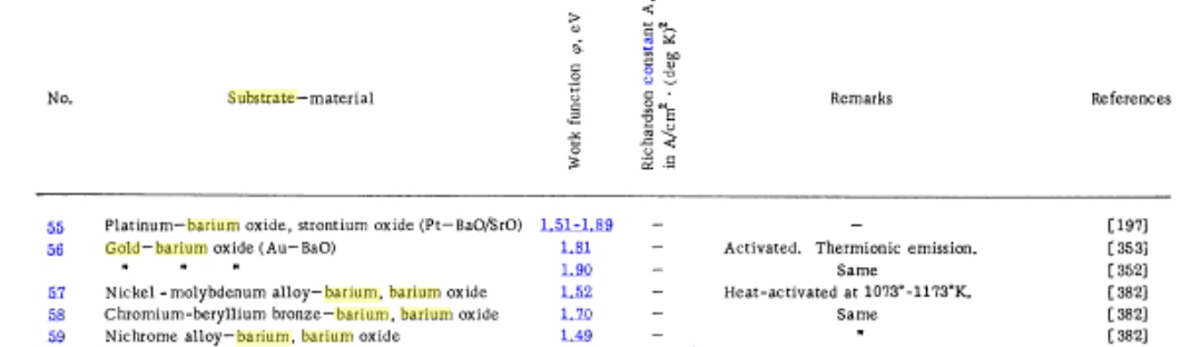

All good stuff as ever, popilin. I agree with you posts as to effect of external field on emission, BTW; I reached a similar conclusion a whilst back but probably didn't explain it so clearly.
Interesting idea, your experiment, too.
As far as calc of grid primary emission is concerned, there is a reference which quotes far lower work function values for BaO/Ba over both gold and moly-Ni substrates:
Handbook of Thermionic Properties: Electronic Work Functions and Richardson ... By Vadim S. Fomenko 1966
e φ = 1.81 for BaO (activated) over Au substrate
e φ = 1.75 for BaO/Ba over Au-10%Pt substrate
e φ = 1.51 for BaO/Ba over Ni-Mo substate
e φ = 1.49 for BaO/Ba over Ni-Cr substrate
If there is no BaO or BaO/Ba coating then e φ for the substrate only is much higher, of course.
See the image below for clip of the published table with these figures in print.
I think such lower values of e φ are perhaps necessary to explain why there can be any problem at all with primary grid emission, at the sort of temp grids are likely to attain. In fact, perhaps sufficient to explain the whole mystery ?
At 600K using your method and Fomenko's e φ values I obtain:
J(o) = c 1uA/cm2 for gold substrate
J(o) = c 0.4mA/cm2 for Ni-Moly substrate
I think that might be enough to explain it all perhaps. Would you kindly double-check calcs please, popilin or anyone?

For clarity, the units in the reference immediately above for work function e φ are in eV, BTW.
So my post should read:
e φ = 1.81eV for BaO (activated) over Au substrate
e φ = 1.75eV for BaO/Ba over Au-10%Pt substrate
e φ = 1.51eV for BaO/Ba over Ni-Mo substate
e φ = 1.49eV for BaO/Ba over Ni-Cr substrate
