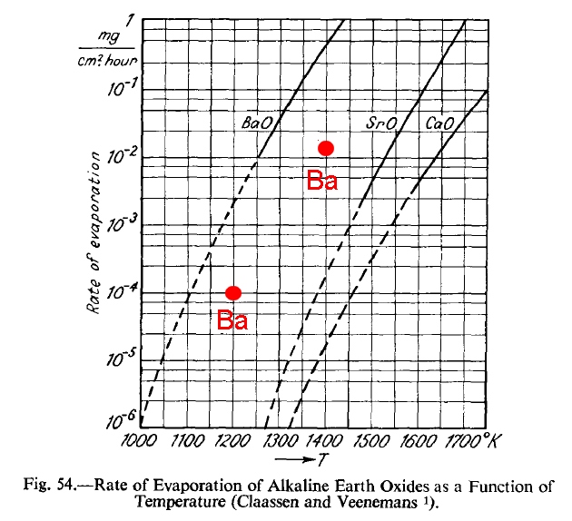

So it is said and no doubt believed in some texts, but does it stand scrutiny and is it true ?Puuting it another way, Ba dissolves readily in gold. Other metals that can be used to make grids offer very low diffusion rates.
Three problems cause me to doubt. 1) BaO prefentially evaporates from the cathode, so seems more likely that is what is deposited on the grid rather than Ba metal, no reason for dissociation AFAIK 2) Ba does not 'readily dissolve' in gold in the solid phase, even the self-diffusion coefficient of gold is lower than most common metals used for grids. Metal diffusion is a slow process especially at likely temperatures. 3) Only a thin film of gold is required to be effective, seemingly insufficient to conserve a concentration gradient (required for diffusion) for long.
The vapour pressure of Ba at 1000K is 10^9 times that of BaO. See CRC manual for Ba constants. See Blewett J P, Liebhafsky H A, Henneley E F, The Vapor Pressure and Evaporation Rate of Barium Oxide, J Chem Phys 7 478 1939.
All compounds dissociate at any non-zero kelvin temperature - but the rate goes up very sharply with temperature, many substances increasing their dissociation rate of the order nx10^6 for each 100K rise in temperature at ordinary temperatures.
The very slow dissociation of BaO is driven by the cathode operating temperature, 1050 K.
Who sez? References?2) Ba does not 'readily dissolve' in gold in the solid phase....... Metal diffusion is a slow process especially at likely temperatures.
It only has to be a very slow process, taking 1000's of hours to absorb picogrammes.

Nine order of magnitude just can't be right ! Perhaps the units or conditions are confused between the two sources ?The vapour pressure of Ba at 1000K is 10^9 times that of BaO. See CRC manual for Ba constants. See Blewett J P, Liebhafsky H A, Henneley E F, The Vapor Pressure and Evaporation Rate of Barium Oxide, J Chem Phys 7 478 1939.
Below is a marked up plot of evaporation rate of BaO and Ba versus temperature, obtained from the same source (Hermann/Wagener The Oxide Cathode 1951 Vol1 pp100, Vol2 sec 31), clearly illustrating that BaO is preferentially sublimed/evaporated over Ba by perhaps an order of magnitude or two.
What's more, there's a weight of literature discussing the evaporation of BaO from oxide cathodes as an issue, mostly associated with the process of activation when the cathode is briefly at elevated temperatures.
As to diffusion constant of Ba in Au, for the range of temperatures likely to be found in a grid, I can't find one. So I base my opinion on self-diffusion rate for Au, which is published, and describes intrinsic lattice migration - it is smaller for Au than any other likely grid metal. If you know a value for Ba-Au diffusion constant for a compatible range of temperatures, bring it on.
And no, if Ba is on the surface of BaO even in small quantities, the surface will be active and emit - so there's not '1000s of hours' to wait around for metallic diffusion.
In fairness, apparently not much Ba is necessary to activate BaO emission, so seems reasonable that sublimation of an activated BaO/Ba cathode and deposit of a mix of BaO/Ba on the grid would be a viable primary emission source - hence the issue. The challenge is to find a satisfying answer that stands scrutiny as to why gold, silver and a few other materials significantly supress this........
Anyways, here's the plot showing relative evaporation/sublimation rates for BaO and Ba:
