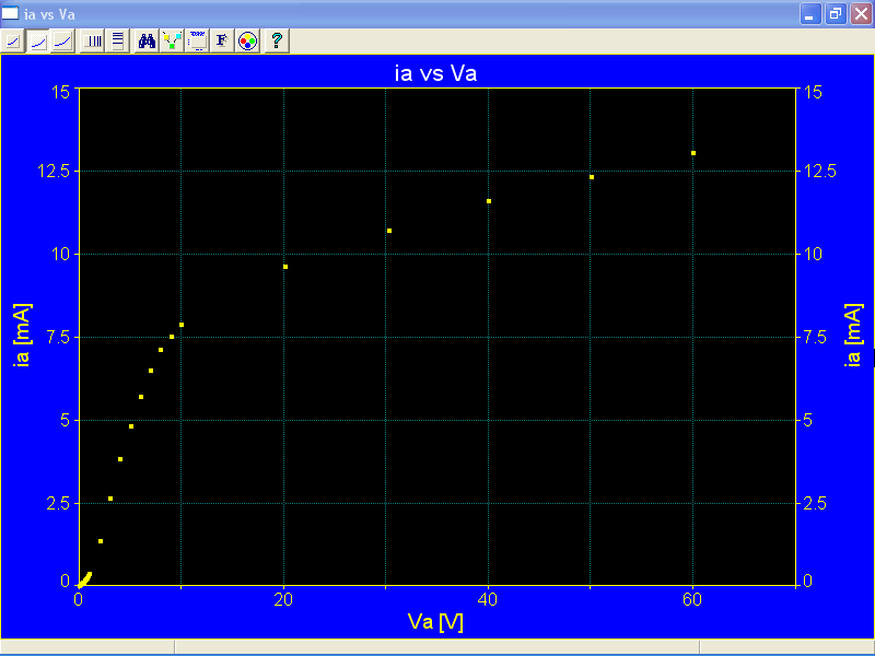

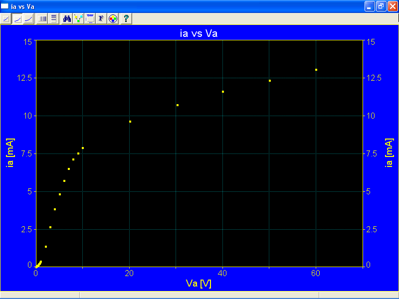

Popilin provide this polit in his post #242. He said in post#245 that it is for "my poor 5R4GY". So it appears he wants us to believe he measured it. In a later post he implied he did it with multimeters.
attachment.php
Popilin's plot is simpy too good, too close in shape to basic theory, to be true.
The 5R4GY is a large directly heated rectifier.
His plot below 60V should approximately match up with the plate charcteristic shown in the RCA datasheet (page 3), but there is no ressemblance whatsoever! The RCA plot shows no evidence of saturation at or below 60V, and a current of ~340 mA. Popilin's plot shows saturation at about 9V and a current at 60V of 13V!

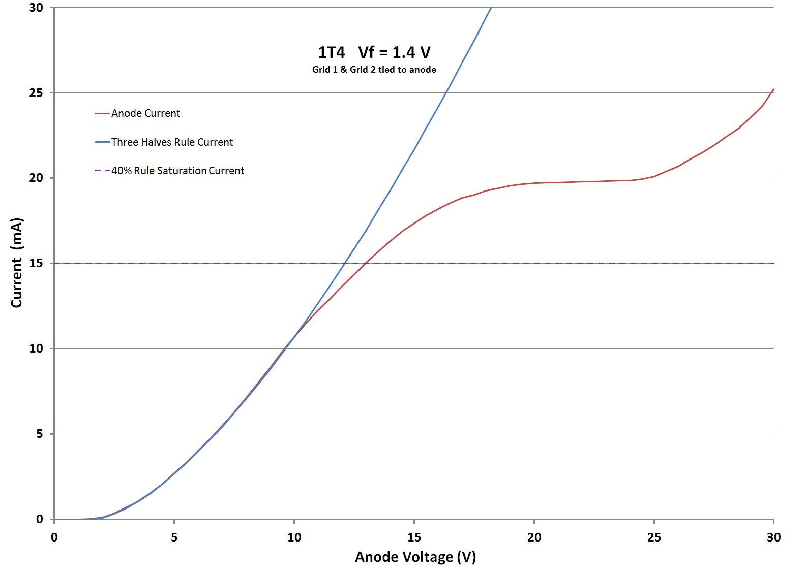

Measurment set up: Regulated power supplies were used to supply the heating voltage and the anode voltage. A Fluke 45 was used to set the filament energisation to exactly 1.40V. A second Fluke 45 (dual range - 2 multimeters in one) under computer control monitored the anode voltage and current. Each run was done in steps of 0.5 V, 5 seconds per step, 5 minutes in total. For each step, the computer software commanded another 0.48 V from the anode power supply, measured the anode voltage, computed a correction for a 0.5V step, and commanded the correction. This was done so that power supply DAC error and ammeter resistance in series with the tube were compensated for.
The run time is long enough to allow the filament temperature to stabilise at each point, but not too long as to evapoate too much Ba and ruin the tubes.
Since the filament is rated for 6 mA emission, then because of the Western tube industry standard of engineering cathodes and filaments for emission saturation of 2.5 times the maximum service rating, we may expect saturation at 15 mA.
Here is the plot, with linear axes (if you don't see the plot, click on the attachment tag):-
We see that the plot corresponds to the three-halves power rule up to about 10V. From 10V to about 14V, the plot veers to the right of the three-halves line. Can you say why, Popilin? I can, but I bet you cannot. If anyone wants to know, send me a private message. Otherwise, I post the answer here in a few days. It's quite simple.
At about 15V there is an apparent saturation. The plot is almost horizontal between about 20 and 25V. You might think this is a schottky line, but it is way too high, close to 20V. Was RCA that sloppy in their design? I don't think so, and my tubes are late production by non-RCA factories.
The plot curves increasing upward beyond 25V. Thisis due to the emsiion current flowing through the oxide coating, causing I^2.R heating, and in the filament, casing more heating. At 30V, the emission current has increased the current at the filament -ve pin from 50 mA to 62 mA, and reduced it to 38 mA at the +ve pin (approx). So one half of the filament runs cold and the other runs hot. The increase in emission at the hot end is larger than the drop in at the cold end.
For a 5R4GY with DC heating, the corresponding currents would be: static heating current 2.0 A, at saturation, an increase to greater than 2.5 A and drop to 1.5 A.
The region between about 20 and 25V looks like a schottky line but it is a false one. It comes about due to two a main opposing phenomena - schottky effect in the oxide layer, and depletion of surface barium over time (after all the tube is seriously overloaded during this test). The emission current is contributing extra filament heating, jacking the line upward.
If I had done runs returning from 30V back down to zero, the line would be below the upward going line, ie a loop woulkd be formed. This is because the free barium is depleted. I didn't do this because it would partially ruin the tubes.
Fortunately, with the runs I did, running the filaments at 1.8V for 10 to 15 minutes frees up more barium from BaO and restores emission. In use, the distribution of free barium in the oxide layer will further normalise.

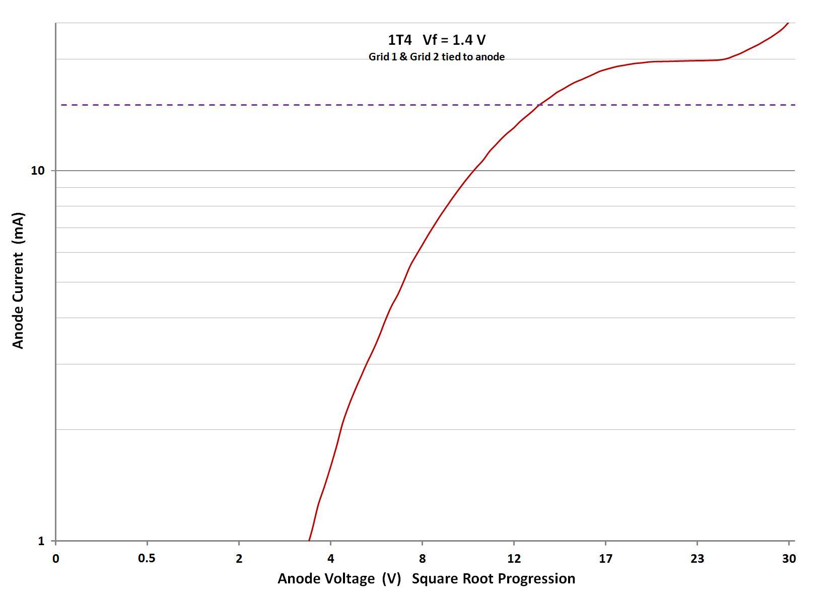

Here, to keep Popilin happy, is a plot with log vs root axes:-
Such a plot is just about useless. Even if the near horizontal part was a valid shottky line, it is way too short to apply a straight shottky line to and expect any accuracy, or confirm schottky effect. Schottky effect does of course occur in the oxide coating type tubes, but you can't tell its extent from these plots.
If I had programmed the computer to do the run over a longer time, the plot beyond 20V would slope downwards due to Ba depletion. If I had done it faster, the line slope upwards. If I had done it with short pulse techiques (curve tracer), the sharp increase beyond 25V would not have occurred, and the plot would be at a lower current and look much more like a schottky straight line.

In the 1T4 plots, I included a three-halves power line. I had to offset it 1.7 V to the right to get it to line up with the anode current line. The filament energisation (1.4 V end-to-end) is an effective bias of 0.7 V. The rest is due to oxide layer voltage drop and interface layer (if any)voltage drop.

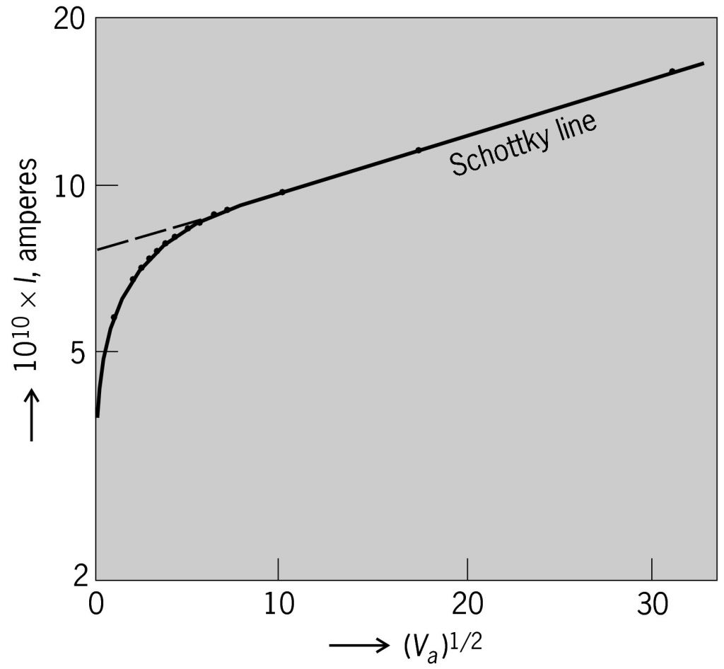

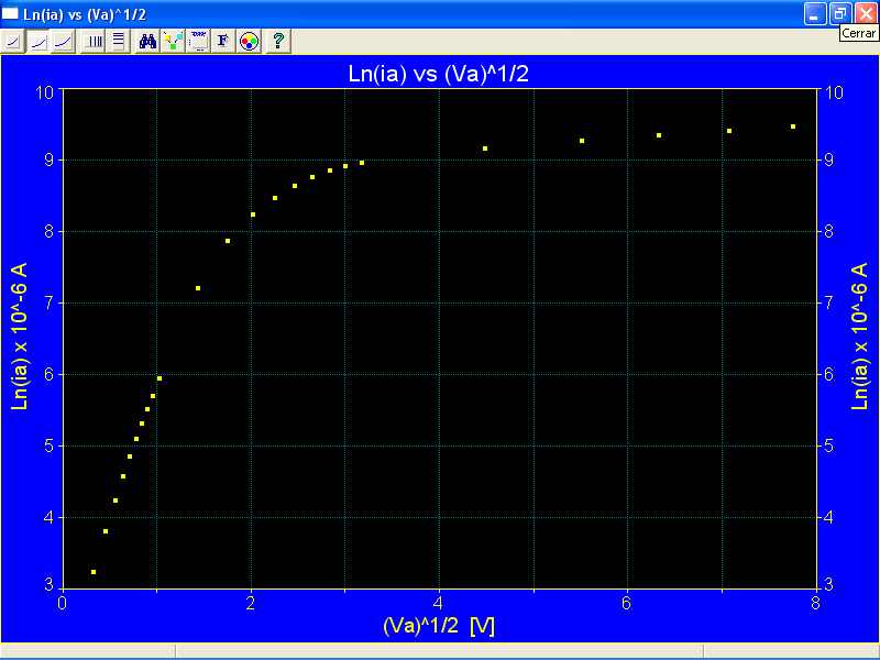

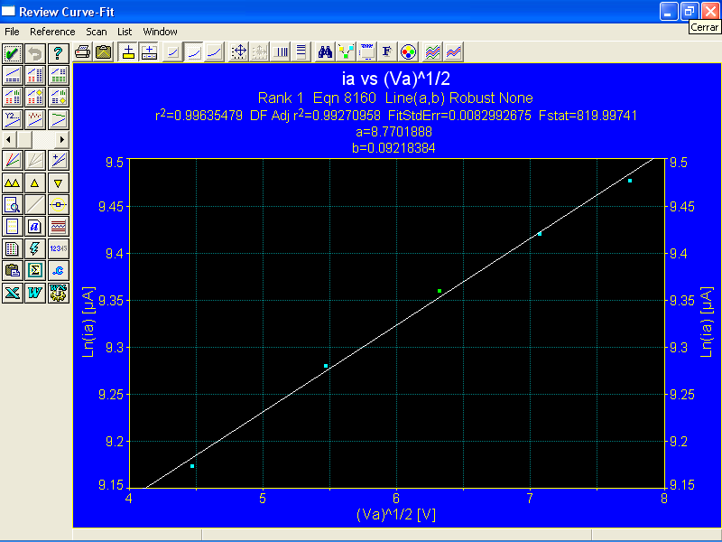

I digitised the anode current (Ia) vs anode voltage (Va) plot from the datasheet and used a curve follower macro in CAD software to produce a list of plot points, at each 0.5V Va increment. I then imported the list into MS-Excel so I could re-plot with both linear and log(Ia)-vs-root(Va) scales. I applied a sliding 5v-wide Hamming window to smooth out digitisation errors.
Here is the log(Ia) vs root(Va) plot:-
Besides this is the wrong plot with the wrong logarithmic function, datasheets are useless in order to search Schottky effect because cathode temperature is too high.
If you want to plot Ln(Ia) vs Va, you must take your valve and measure with lower filament voltages (lower temperatures) in order to obtain currents in the order of nanoamps for pure tungsten cathodes and microamps for oxide cathodes or little noise diodes as your mentioned A2087.
As you do not know how to make a lab measurement, I guess that I ask too much.

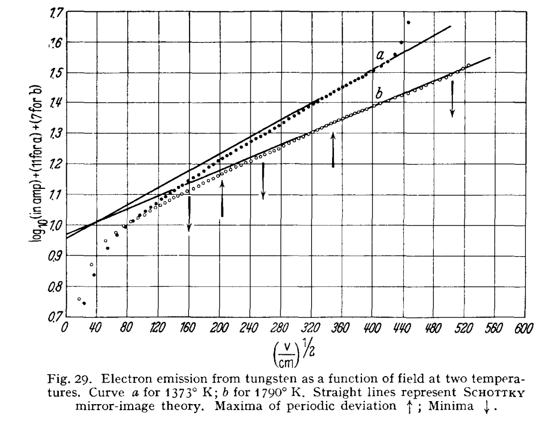

Here is a plot included by Popilin in several of his posts. He claimed it represents a pure tungsten vacuum tube.
As you are not able to understand even a plot, I will post it again, with the proper title; maybe you will realize that it is not my plot, but W. B. Nottingham's plot, from his paper
Phys. Rev. 58, 927 (1940) - Remarks on the Temperature Dependence of the Work Function of Tungsten
Logarithm of thermionic emission current I of tungsten as function of square root of anode voltage Va. (W. B. Nottingham, Phys. Rev., 58:927–928, 1940)
attachment.php
We see that Popilin's plot in no way resembles any real pure tungsten tube, and I'm not talking about it apparently taking 2,000,000 mega-amps at 1 kV - presumably a typo.
Not a typo, Physical Review does not ignore such things, and again, you are not able to understand a plot, as it says “10¹⁰ x I, amperes” it results more than evident that is
Ln(Ia) x 10⁻¹⁰ A vs Va [Volts]
The first thing we notice is that Popilin's plot has the "schottky line" way way too steep - unbelievably steep. All the pure tungsten types (noise diodes, regulators) I've seen data for have it just about horizontal. For a doubling of voltage, Popilin's schottky line inceases 24% whereas the AV44 line increases only 4%.

I must repeat that it is not my plot, but W. B. Nottingham's plot, even more; the paper was passed the peer review, so we must conclude that you are not able to understand a simple plot.
Thanks! Good job, right? 😎
As I said before, on post#138, heater voltages was
With the 5R4GY I used: 1 V, 1.25 V, 1.5 V, 1.75 V, and 2 V
Needless to say that at that heater voltages cathode temperature is low enough to reach saturation at low anode voltages.
BTW, the plot shown corresponds to a heater voltage of 2 V.
You have confirmed that, contary to your earlier posts, that schottky effect is too small to matter much in normal tube operation.
Maybe.
As I said the first time you cited it, I cannot access this. Kindly post the relavent portions of the paper.
Your graph looks way too neat & clean to have been scanned form a 1940 paper - scanned by the on-line publisher or scanned by you. Looks like you did it yourself in MS-Paint or something.
Post a genuine scan of the original page.
In any case, the plot you posted, whatever its origin, is not in the least realistic. It ought to show compliance with the Langmuir V^3/2 law near the origin and it doesn't. That's the sort of error that no person who really knows tubes would ever make.

1T4 plots reposted so poor Popilin doesn't have to do a mouse click on a text link.
My post #321 explains how thse plots were made.
The graph vertical axis is labelled "anode current". It actually includes grid current as well.
Popilin, can you explain why the plot diverges away from the langmuir law between about 10 V and 12 V? I bet you can't - it's quite simple but it requires a real understanding of tubes and their construction.
I can. If anyone wants to know, send me a PM. Otherwise I will post the reason in a few days.
Ok. Let's see if we have this right.
You said you measured Ia vs Va on a 5R4GY with 2 V (40% of the normal value) across the filament.
On your plot, we can extend the schottky line to Va = 0 V to get the saturation current at 0 V, i.e., the Richardson-Dushman saturation current. On your plot, its about 7.5 mA.
The RCA datasheet does not of course give the saturation current, but from the information that is included, we can infer for tube industry engineering rules of thumb that at Vf = 5 V it is probably no greater than 1.5 A, certainly no greater than 2 A. The 2 A value is 200 mA per watt heater power.
(By comparison, the 1T4 R-D saturation current @ nominal filament voltage is 15 mA, ie 214 mA per watt.)
Using the Richardson-Dushman equation, we can start with the upper estimate of saturation current (2 A) at Vf = 5 V and see what it would be at Vf = 2 V. It turns out to be about 1.3 mA, not 7.5 mA. More likely about 1 mA.
You have some explaining to do, Popilin.

Wrong plot…again!!!
I must repeat over and over that you must plot Ln(Ia) vs Va, not Ia vs Va :headbash:
I have no access to the paper; I just posted the first plot found around there.
I barely can remember where, but maybe here
Full Size Picture Logarithm-of-thermionic-emission-current-I-of-tungsten-as-function.jpg
But this is irrelevant; it is only an example of Schottky effect in metals.
Maybe the online publisher digitalized the original plot.
No, it does not looks like my own plots because I work with TableCurve 2D.

5R4GY, heater voltage 2 V
attachment.php
attachment.php
attachment.php
From the last plot
Ln(io) 8.77 µA
Then
io 6.44 mA

From the last plot
Ln(io) 8.77 µA
Then
io 6.44 mA
This appears to be your plot for Vf = 1 V.
Reading off your graph in your first post of it, I got ~6 uA too.
Trouble is, if you estimate it from by the method I explained in my post #332, it turns out it should be ~47 nA. You are out by 2 orders of magnitude. So, it appears something went wrong in your measurement.

Anyway, if you do not like the plot, I have another 😀😀
attachment.php
Thermionic Emission, Wayne B. Nottingham, 1956, page 102.
