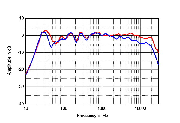

The speakers I'm so curious about though, the MoFi SourcePoint speakers.. they are supposed to go deep and they are Andrew Jones babies too.
At 91db/w they seem like they'd be Class A friendly... but I worry they recommend a minimum of 30W... why? And not that I care that much for The Julian Hirsh approach but the Stereophile graphs show a pretty smooth frequence response at the crossover. Red is the SourcePoint 10, blue is the Mission 770 speaker.
https://www.stereophile.com/content/mofi-electronics-sourcepoint-10-loudspeaker-measurements
