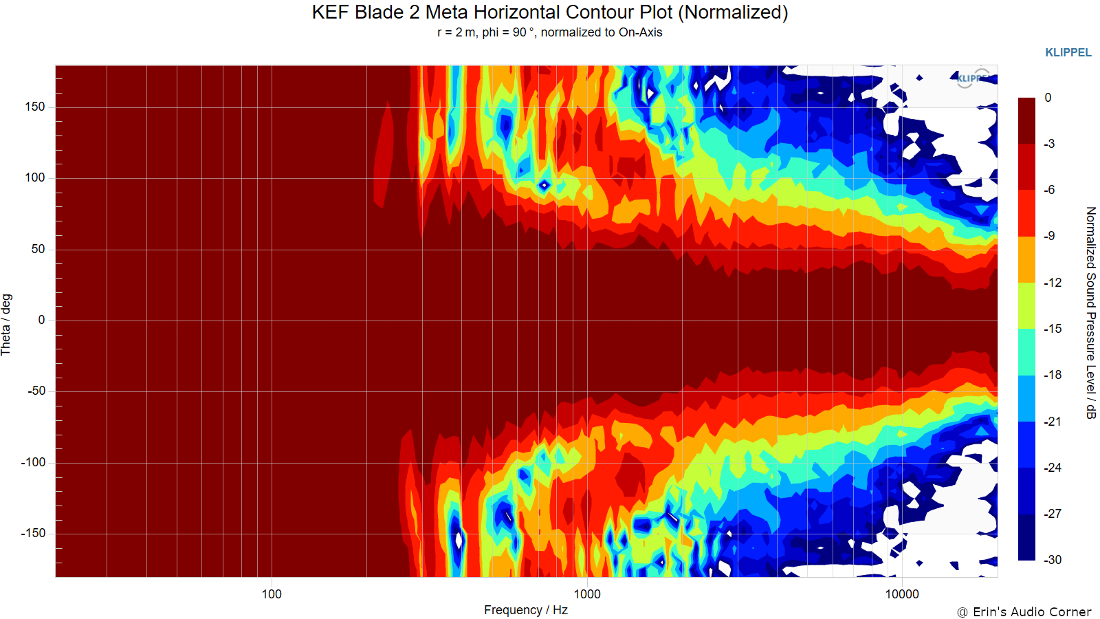

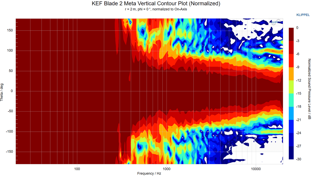

Coaxial speakers can provide the very BEST stereo image, creating a soundstage that has unreal depth. Best I ever heard was a pair of UREI 813s.
My view is that there aren’t any fantastic coaxial drivers for DIYers to work with.
By great I mean something with a nice smooth response past 2x Fc for the mid, good sensitivity (90+dB/2.83V) and a tweeter that’s well behaved on and off axis.
Like the UniQ. KEF have been refining that for over 20 years…
Here’s the 2022 model:
Reference:
https://www.erinsaudiocorner.com/loudspeakers/kef_blade2_meta/
This is what can be accomplished when you're vertically integrated, and have the resources of design talent and manufacturing capacity; and can build drivers, waveguides AND cabinets all in house.
So I would take the Blade 2 Meta, take out the standard woofers, load it with a quad of Purifi PTT6.5X drivers, take out the passive crossovers, give it the ol’ spinorama treatment, DSP + tri-amp it, add delays to the M/T section. You in @bikinpunk ?

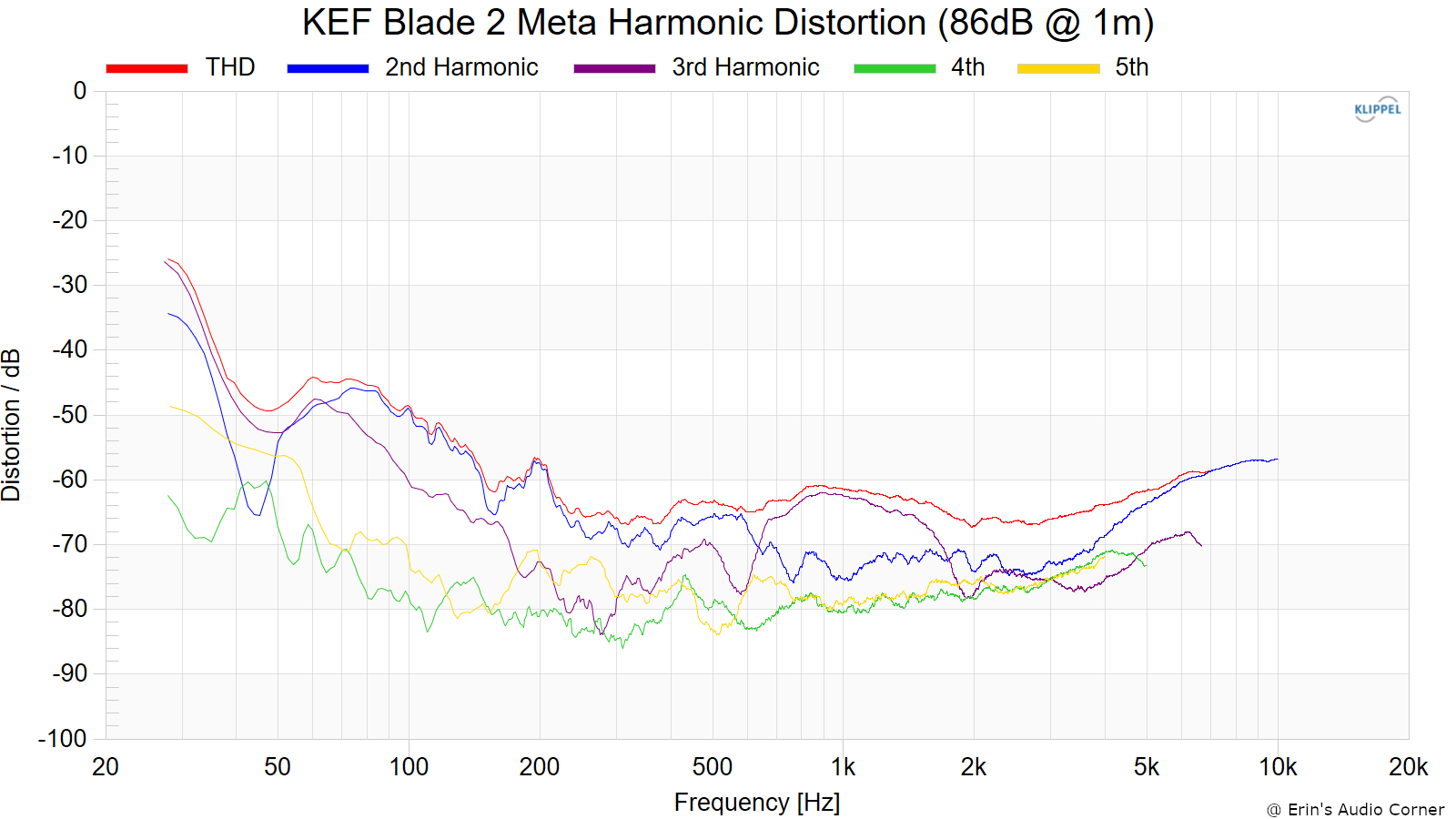

Btw - Like Earl Geddes , I don't care about distortion below 1% ... as long as the music is taking you into another dimension :
