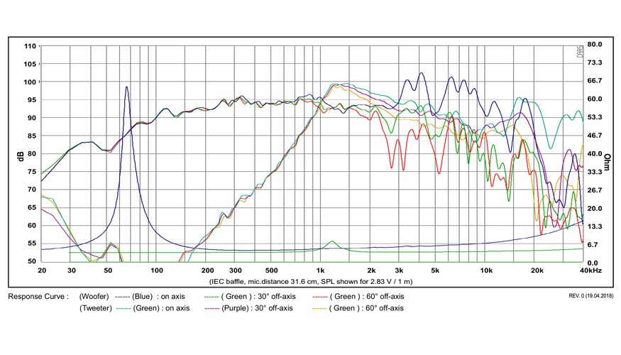

it looks like it could be decent with DSP to get a sharp enough crossover filter but I agree this is not competitive with KEF. Particularly the woofer going wild above 2k should be fixable with perhaps a different edge termination that's more lossy. The tweeter response looks pretty good though, probobly due to that plastic ring between the woofer and tweeter.$ 439 is a heck of a lot of money for such of middle of the road job..

Anyone notice that datasheet is 5 years old, from 2018? Surely the 2023 release is further improved/refined?!

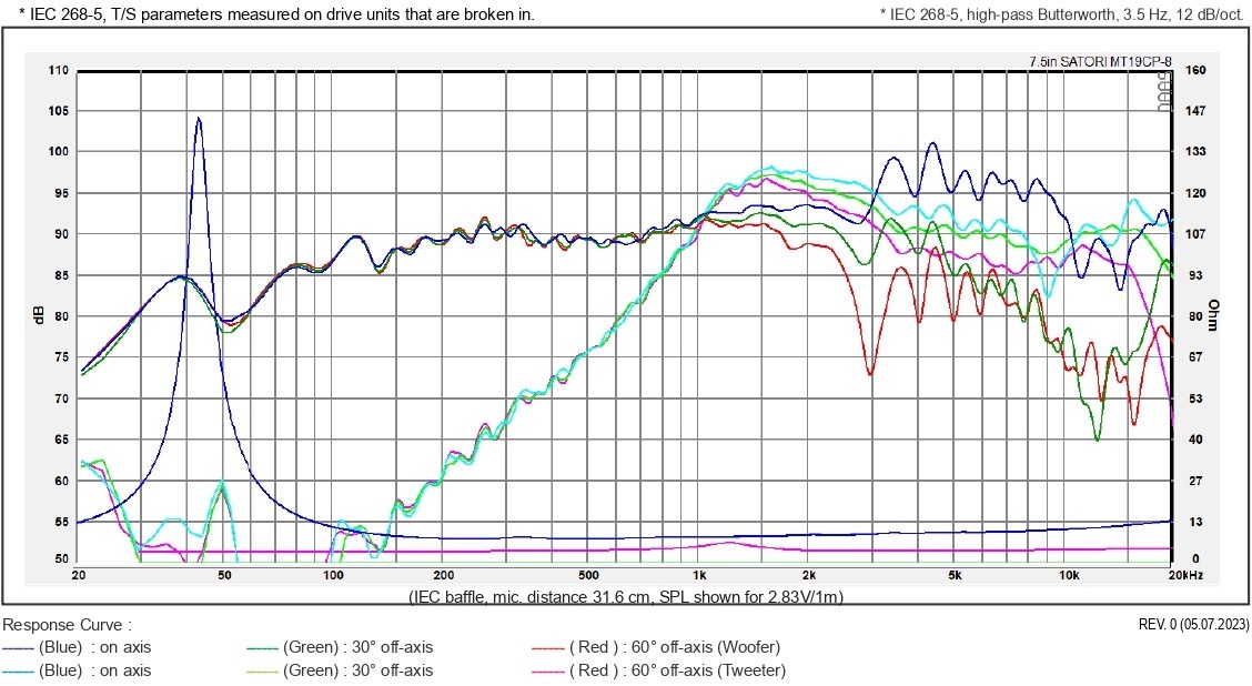

This one looks much better! Price still $439 a piece? (Update - australian dollar is 0.61 to the euro and 0.67 to USD)
Quite some improvement since the first version ... now need a Klippel Hero to confirm who's the leader of the pack 🙂 ..... (MWBSOAT or Erin's Rotten 5 .. lol)

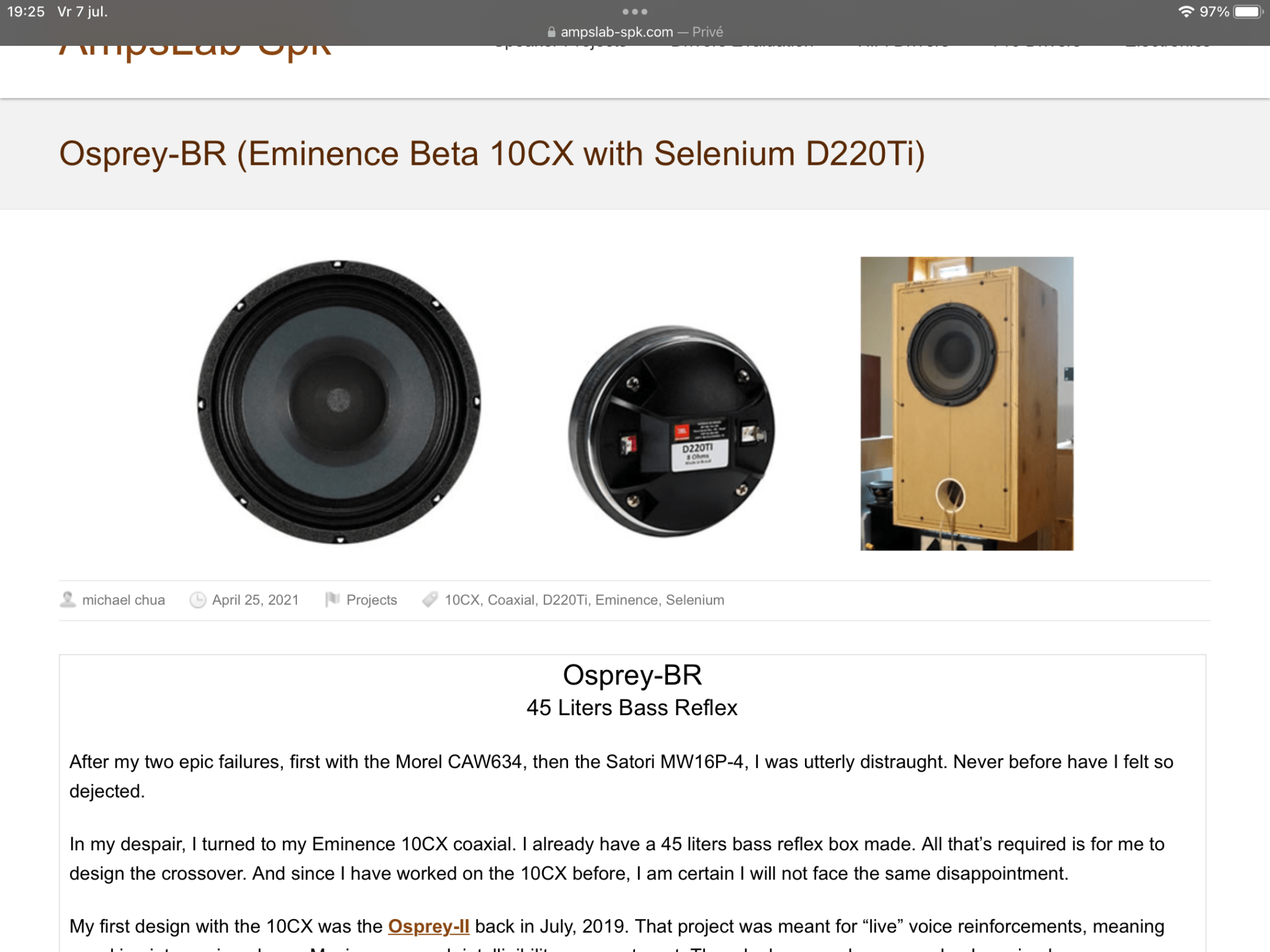

A lot of builds with eminence beta cx and selenium d220ti.

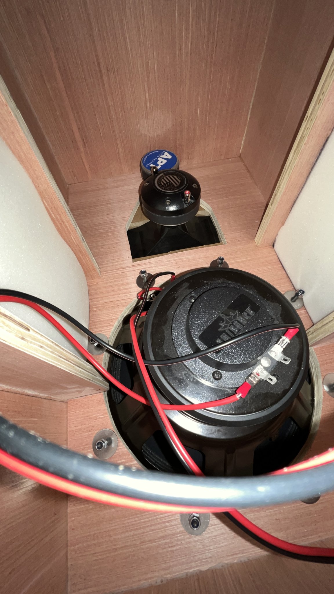

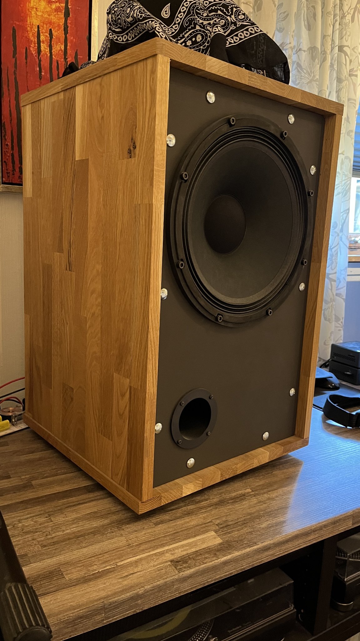

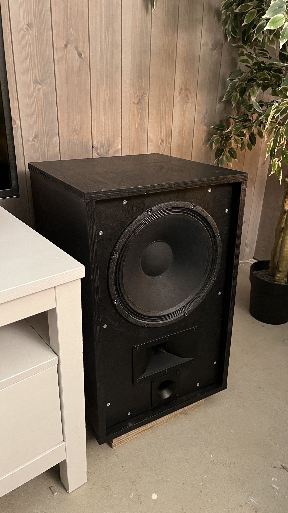

On the topic I just really love the sound of these PA coaxials in domestic use. So dynamic and with a large body, everything just sounds larger and louder even with a small amp at low levels, compared to using hifi speakers. I’ve build a few myself, one with a celestion 12” which I’m really happy with and another with the Eminence Beta 12cx which is a bit more struggle to get right but still fun for the money.
The beta cx now sits in a black painted ply cabinet with a few horns as well so I have some options to play around with HF using PSD2002 mounted in the coax and ASD1001 mounted in an APT150 flare, and finally the APT50 on top. At the moment only the coax is used which is why the speaker looks like it’s placed upside down. So far using only stock crossovers.
The celestion is in an oak cabinet that seems to work very good with the eminence Cx crossover. A bit bright in the HF but I can tame that on the amp.
