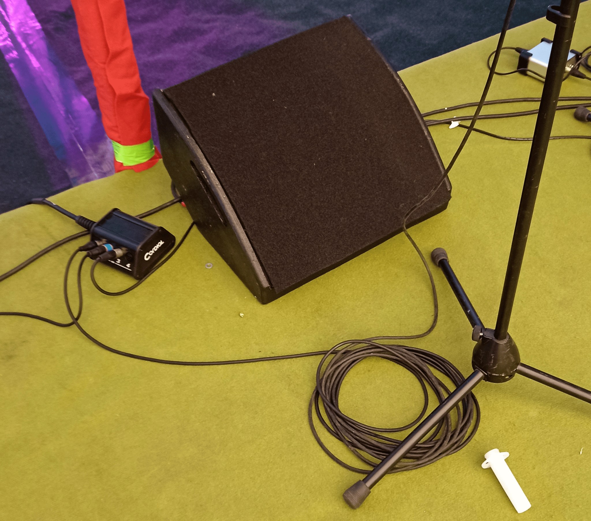

Happy with the results? How musicians react to them?
@krivium Had a few people trying to find the logo on them to work out what company made them. Pretty much universal aclaim for the sound. We made 4 and are now making a second batch with some cosmetic improvments. The dispersion pattern of the 12FCX76 is ideal for this monitor application, also the large compresion driver means massive HF output potential and the overall design of the driver makes the crossover easy. They have optimised flared ports which alow the response to be flattened to 60Hz with a big amp. They also work well as small scale PA tops with subs.
Yep they are as small as can physically fit the driver in the box so easy to move around the stage. I haven't measured the off axis response as building a turntable is on my to-do list but I don't notice any off axis anomalies and they have behaved well at gig WRT feedback.

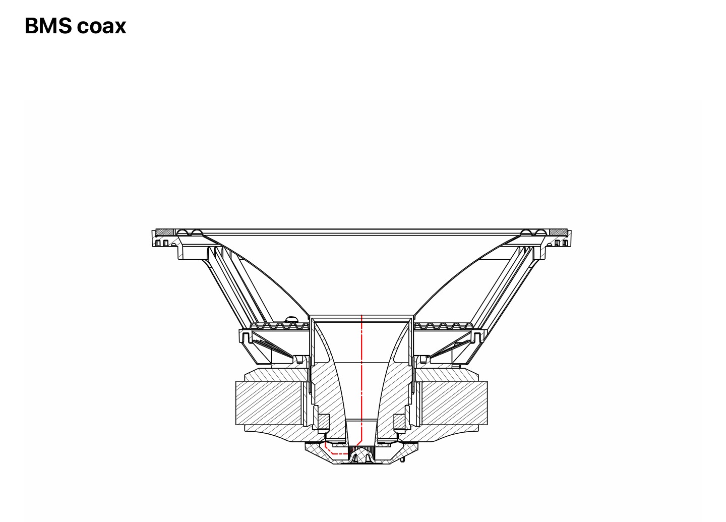

The issue is not so much mounting a (dome) tweeter that simply fits within the VC, but, as KEF has shown, the design of an optimized mini-waveguide to properly match the tweeter-cone transition. It is beyond my understanding how manufacturers of name and fame simply throw in a fitting tweeter and thats it. The result is an Alpine landscape from 6-12 Khz.
The question is can the manufacturer do it? Or they not care to spend the R&D on it?

@tktran: of course the cone acts as a waveguide. But that is only part of the story. As the waveguide-tweeter plus horn/waveguide-CD sims demonstrate, the first, say 5 mm, of the interface are crucially important for a smooth HF response. Not only KEF, but recently Malcolm Jones has also shown the way to go.

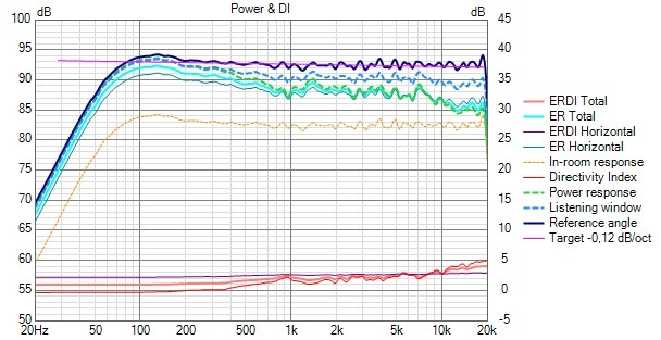

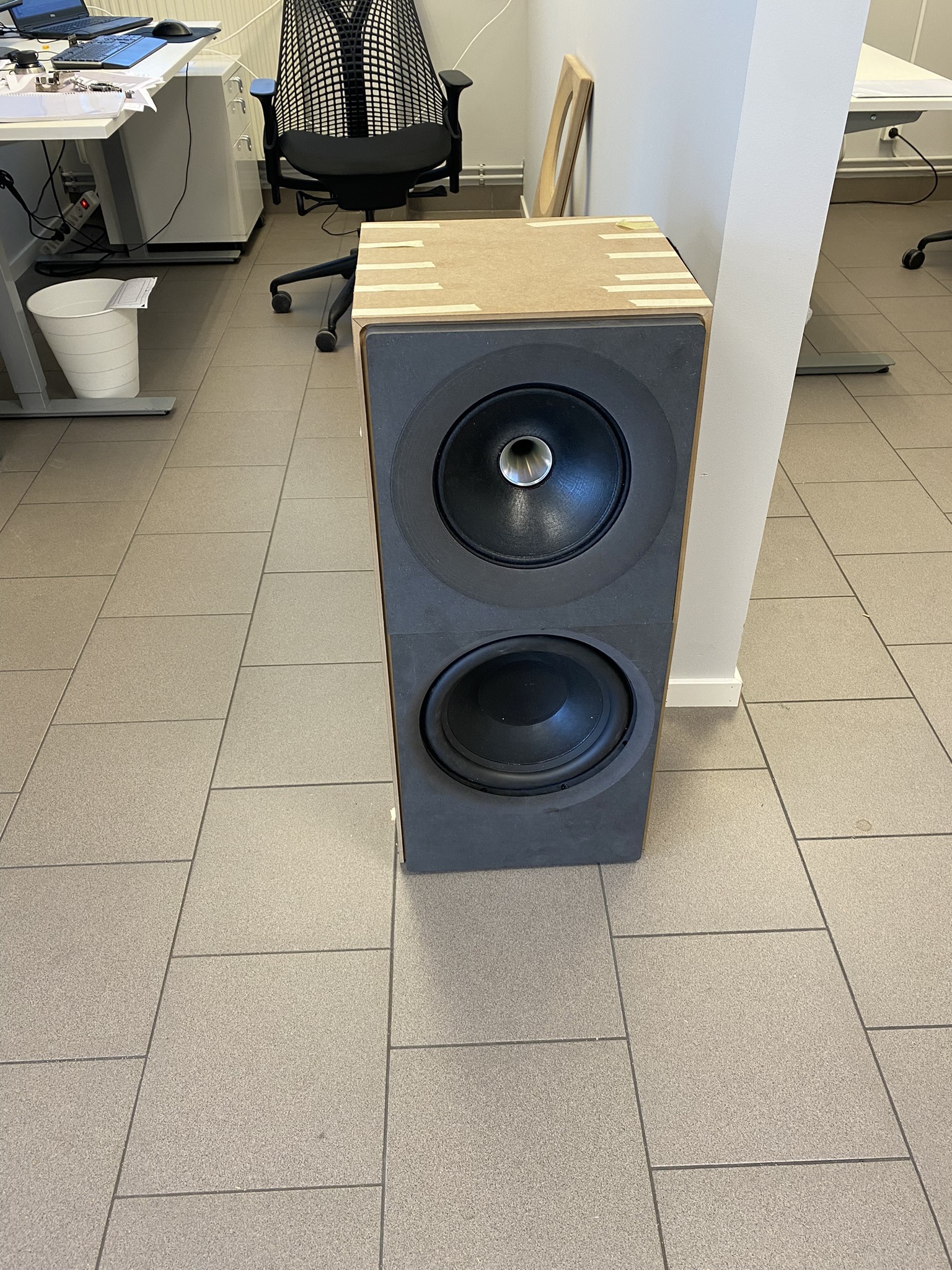

I use both the 10&12” - 12” to be preferred . Baffle of 10” prototype below is natural extension of profile of cone as in illustration above.
Measurements with B&K mike using Klippel in anechoic chamber imported into VCad.
Definitely don’t optimize or listen on axis!
I do however think that coax is best linearized (using FIR) and crossed <90Hz .
Cone is time delayed of course and handover is with 60dB L/R filters. Distortion of coax rises really fast below 1,1K and cone has pretty bad breakups close to passband. We use FourAudio PPA for filters and amps.
