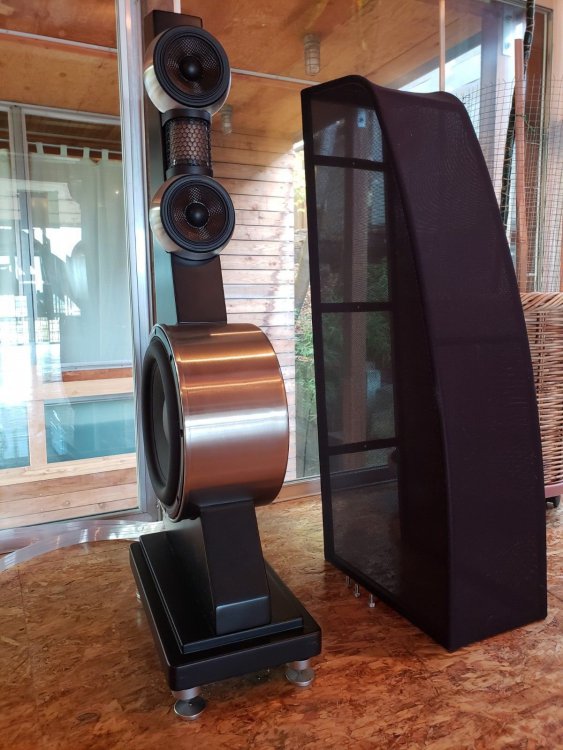

If i gave a link to ME-Gethain products it wasn't to suggest to buy a pair but to study them to understand how they did it: they use passive cardio for the sub and low mid.
For the low mid there is a small box full of absorbing material and large openings leading to the cardio pattern ( for more info on this search about member Keyser's post in here he is one of the brain behind D&D 8c and did his initial experiments open source in here).
By doing same way you could mitigate the first issue i listed.
Now the second one ( diffraction, reflections). If you have a box involved then it'll have a shape. By choice of shape it could help mitigate this second effect: a teardrop shaped enclosure would be my first choice (take a look at B&W 'Nautilus' mid and high enclosure), or at least something approaching.
I would use a bunch of absorbing material glued on it too ( Urei version of Altec coax used this on the protubering horn the Altec coax have).

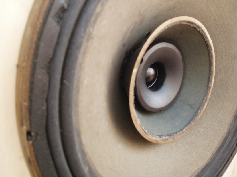

Altec is still availlable under a different name ( same tooling used as in 'good old days').
But it cost a HUGE amount of $! Even more if you are not located in USA.
15":
https://greatplainsaudio.com/wp-content/uploads/2016/06/604_8H_III.pdf
https://greatplainsaudio.com/products-2/604-8e-alnico-magnet-includes-n604-8a-crossover/
12"
https://greatplainsaudio.com/wp-content/uploads/2016/06/212_8A.pdf
