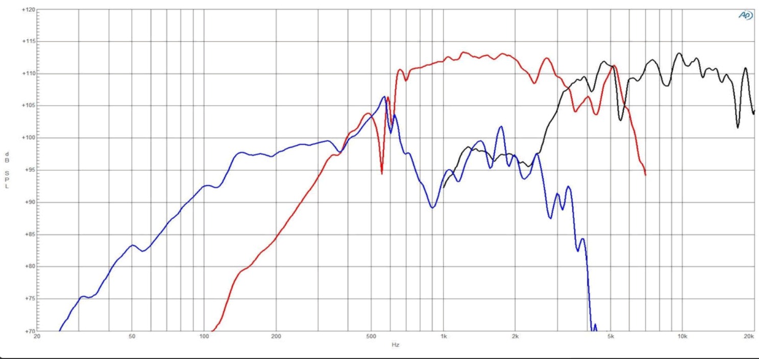

This type of mountainrange fq-response is typically a big turn-off for diy builders, especially for non DSP folks. Even a ‘normal’ plate amp like a Hypex with its limited PEQ:s won’t really make this palatable. The “flying squirrel” filter needed for a smooth handover from cone to cd, the drooping response of the 18”, the break up close to the passband of the cone drive, all are sort of the opposite of f.i. a Purify/Dome driver setup.

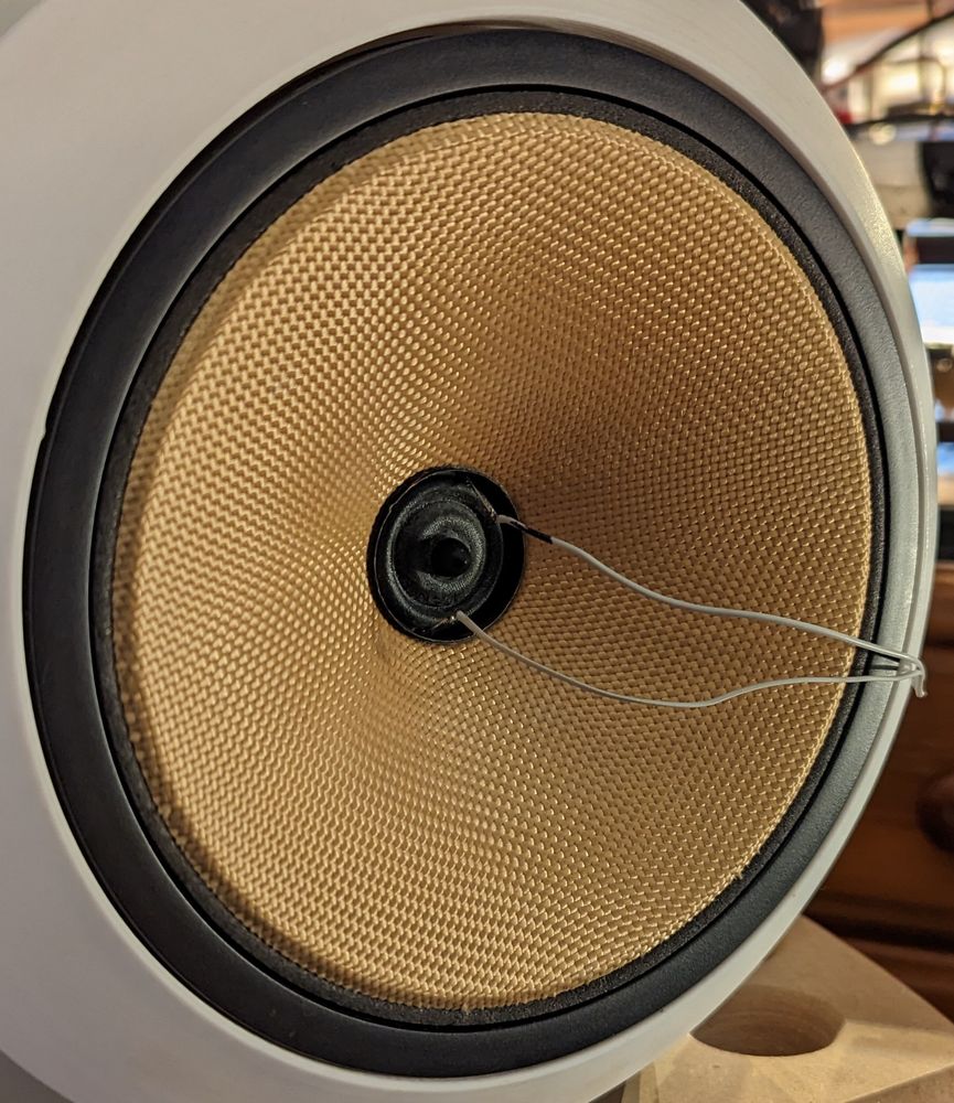

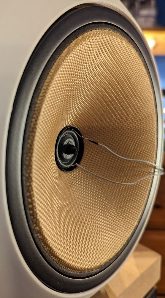

Mabats ATH4 and Augerpro's waveguide simulations have reached advanced levels. It might be an idea to focus on optimization of diy mini-waveguide+compact tweeter combo's that would be suitable to be built into existing (mid-)woofers. Member 5th Element did that with B&W mids.
Many years ago I did some crude attemps, but without optimizing the first section (a la KEF) , results around 8-10 kHz are far from optimal. Then the cone termination is next....

not just a Kevlar B&W, a paper cone 5” Satori, and a 6” metal cone SB Acoustics driver. He’s cracked the code for sure. @5th element
Good times ahead without needing a large MEH. (not that there’s anything wrong with that)
Watch this space!

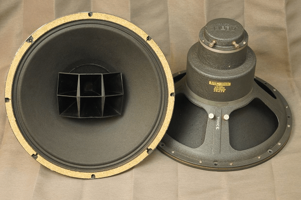

Yeah spendy. But the compression drivers alone are $$$. The P.Audo 18” coax was a relative bargain when they were made at $750 a pair. That would be $1000 today.
@WhiteDragon Yes, you've hit the nail on the head. It's visually impressive and makes you want one - and the 16" cone does work well with the 1.4" compression driver.

@5th element very cool. I think I recognize that tweeter. Is it back mounted to the magnet pole of the woofer?
