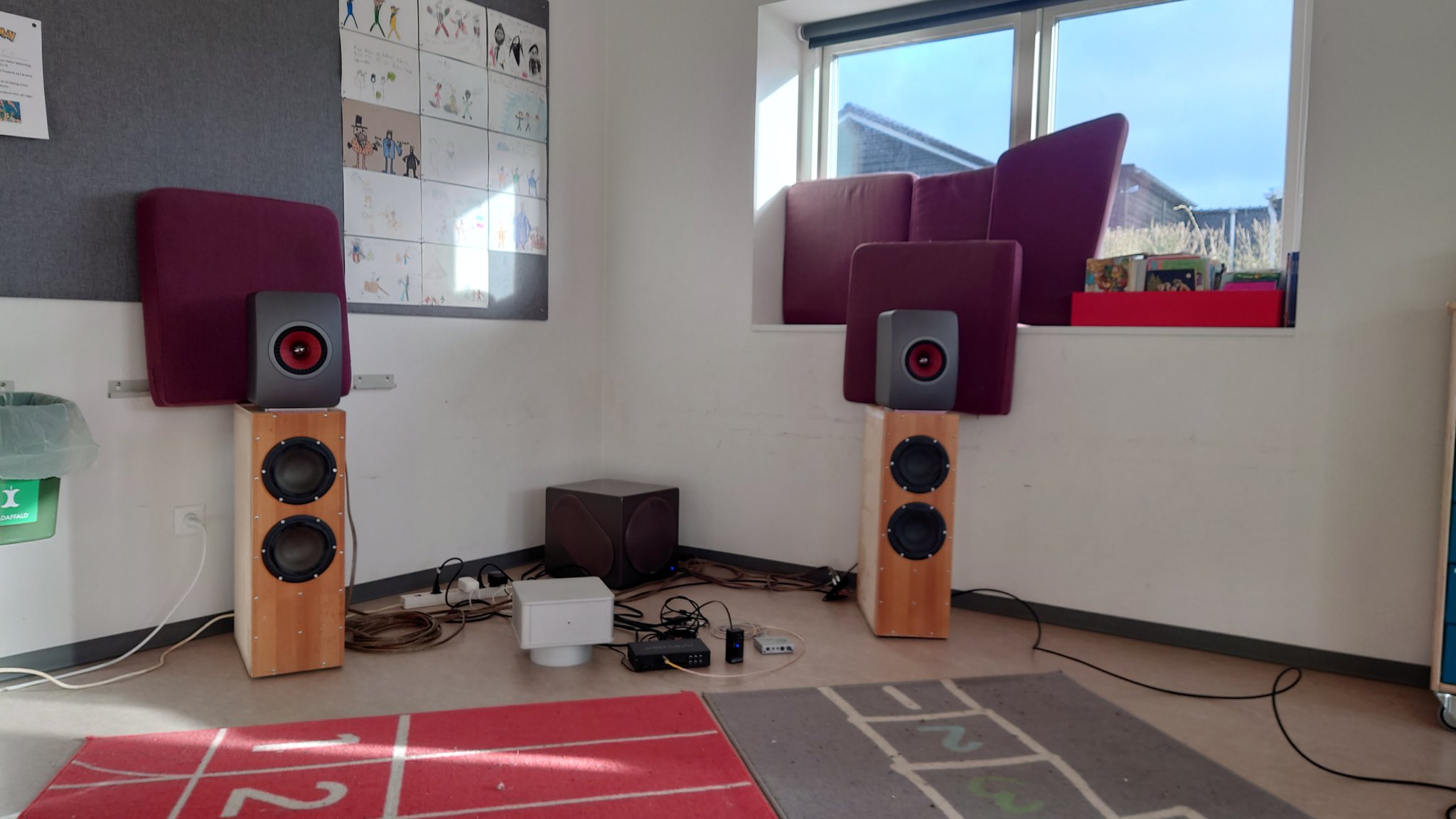

Supported in the lows by 2x12" Discovery and 2xRSS390HF Dayton, all closed. The Satori goes quite deep and powerful, but are mainly chosen to handle dynamics and voices/instruments, since the KEF won't do much below 400Hz. I would have done the same for the Sica. A 5" below around 500Hz would be way to small - IMO. We can't cheat physics. I bought the KEF LS Meta, and no matter what I did, it will never play bass.... It needs woofers/subwoofers! As a desktop speaker at 0,5m it might be ok at low level with some boost.... But... Just no.Looks like some serious bass! Very impressive
Paired with woofers and subwoofers... It suddenly shines..

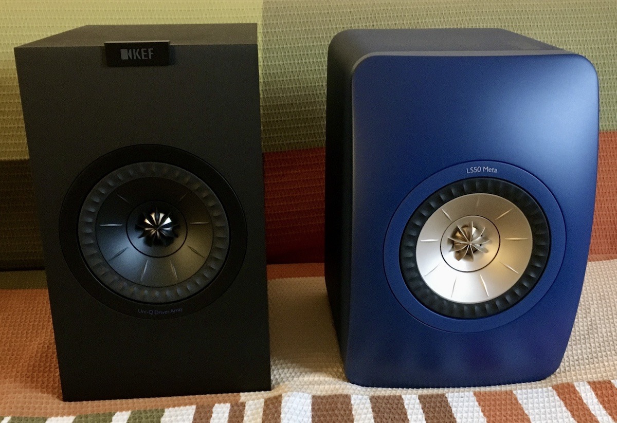

https://www.audiosciencereview.com/...f_q150_and_ls50_meta_side_by_side-jpg.326898/
https://www.audiosciencereview.com/forum/index.php?threads/kef-ls50-meta-review-speaker.25574/
https://www.audiosciencereview.com/...-q150-bookshelf-speaker-review-by-erin.31249/
https://www.audiosciencereview.com/forum/index.php?threads/making-a-kef-ls50-clone.49601/
