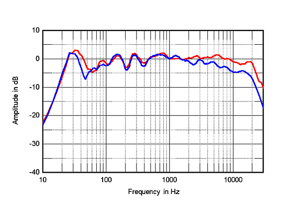

At 91db/w they seem like they'd be Class A friendly... but I worry they recommend a minimum of 30W... why? And not that I care that much for The Julian Hirsh approach but the Stereophile graphs show a pretty smooth frequence response at the crossover. Red is the SourcePoint 10, blue is the Mission 770 speaker.
https://www.stereophile.com/content/mofi-electronics-sourcepoint-10-loudspeaker-measurements

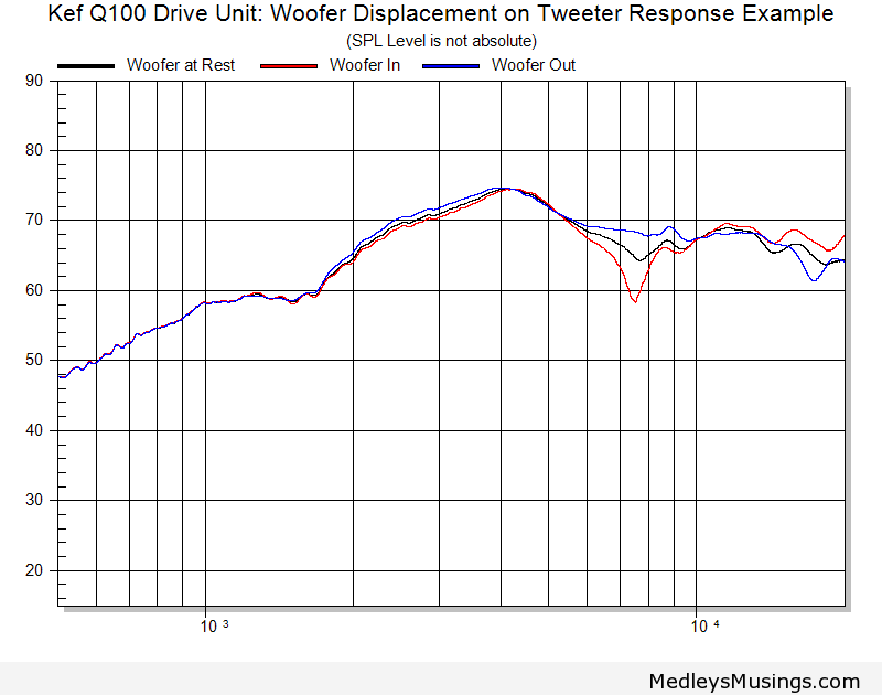

Erin (bikinpunk here) tested KEF coaxials, tweeter response with woofer cone steadily at +/-3mm tested with KEF Q100 driver
Scroll down...
https://web.archive.org/web/2018030...ker-driver-tests/other-speakeer-driver-tests/

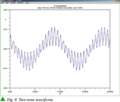

Sound is pulsating air pressure variations and usually we can visualize it as waveform display in oscilloscope or eg. Audacity if you zoom enough. Different frequencies always ride on each other and modulate, this applies to all sounds, also from "natural" sources. The question is if a loudspeaker system makes any changes to the original stimulus.
Doppler distortion is modulation of pitch (frequency) https://en.wikipedia.org/wiki/Doppler_effect
Intermodulation distortion is added harmonic distortion, we can see them in multi(sine) tone tests

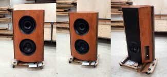

My latest diy project used a 12" coaxial and it was very difficult... the horn made problems.
Pics here https://photos.app.goo.gl/hGFkqajgoVwWrzL59
