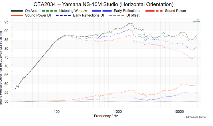

Really? The NS10 is being compared to KEF, when they clearly exhibit two very different philosophies, from two vastly different era's.
Maybe you just like a big 5dB boost in the middle of the sensitive area of our hearing, and then get tricked to hear that as 'clarity'. No offence, we all fall for this little 'detail' trick now and then, but a fair comparison it is not 😉
Exactly👍NS10 and KEFs are for 2 completely different purposes, it's pointless to compare them.
You can actually EQ most speakers to have a bit of extra emphasis in the upper midrange, which "tricks" you to hear more detail - when in fact it is just you "zooming" in on a given pass-band, wher most details in music are "hidden" and human ears are most sensitive.
As soon as you listen to a neutral speaker. You hearing - maybe loss of hearing - and the specific music, makes a ton of difference to whether it sounds detailed or not. Just a flat smooth/even bass response in the listening position, can clear up many details in the upper frequencies, which normally would be masked by the much more dominant bass.

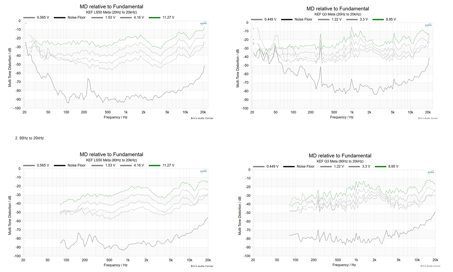

Out of curiosity, I went digging through Erin's Audio Corner website for data...
LS50 and Q Meta (basically Q150) show a slight decrease in multi tone distortion when high passed at 80hz. But both are still quite high compared to what comes next:

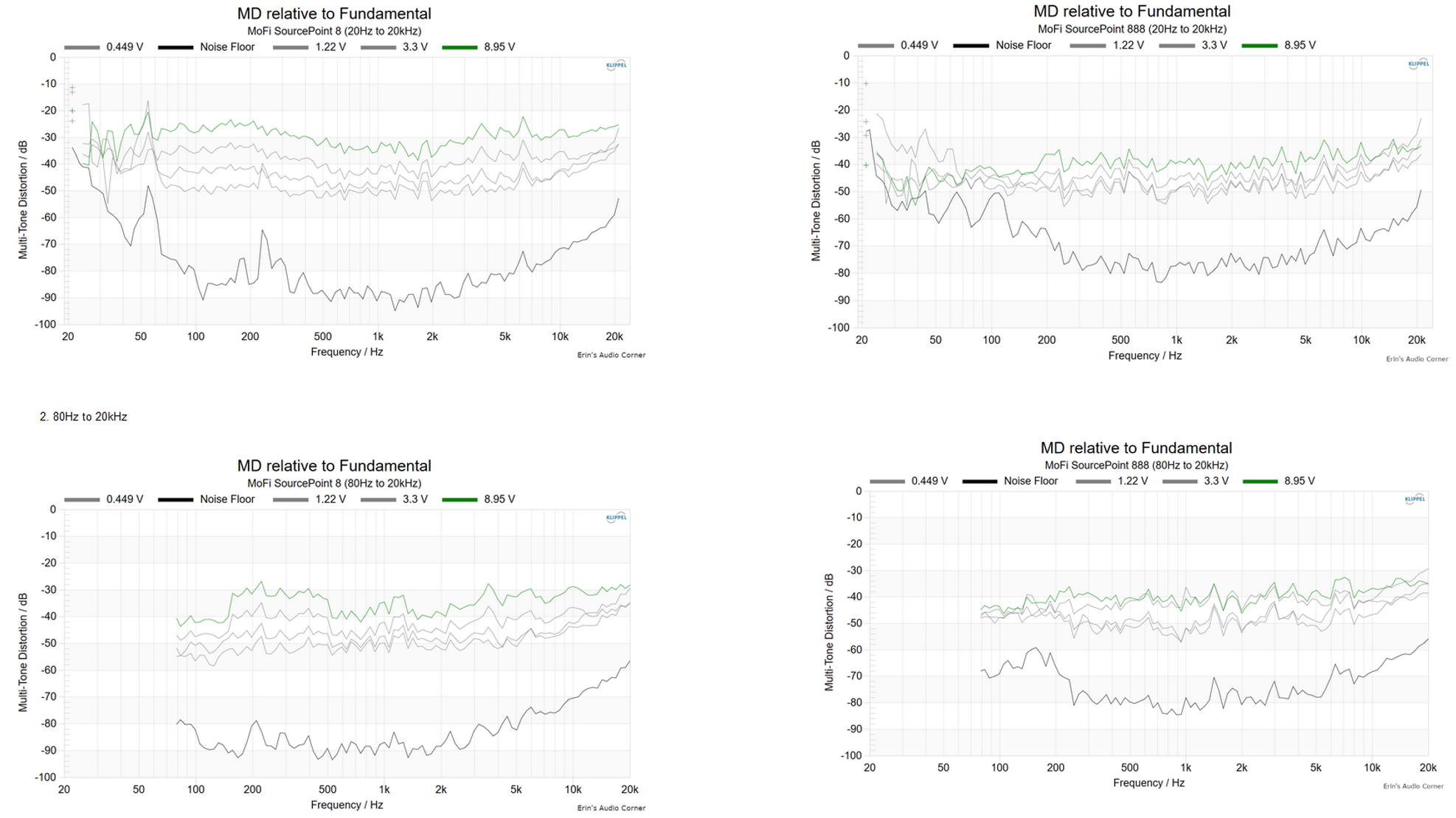

This next one is very interesting, Mofi Sourcepoint 8 and 888. First off is the overall lower MD even in the sourcepoint 8 running fullrange. I'd guess a better tweeter combined with a bigger cone (moves less). Then when high passed, a slight reduction in MD. Then when that same driver (assumption) is crossed at 130hz as in the 888, a even further drop in MD. It would seem that pure midrange use is the better idea. THe MD is similarly low for all the KEFs that use the coax purely in the midrange role.

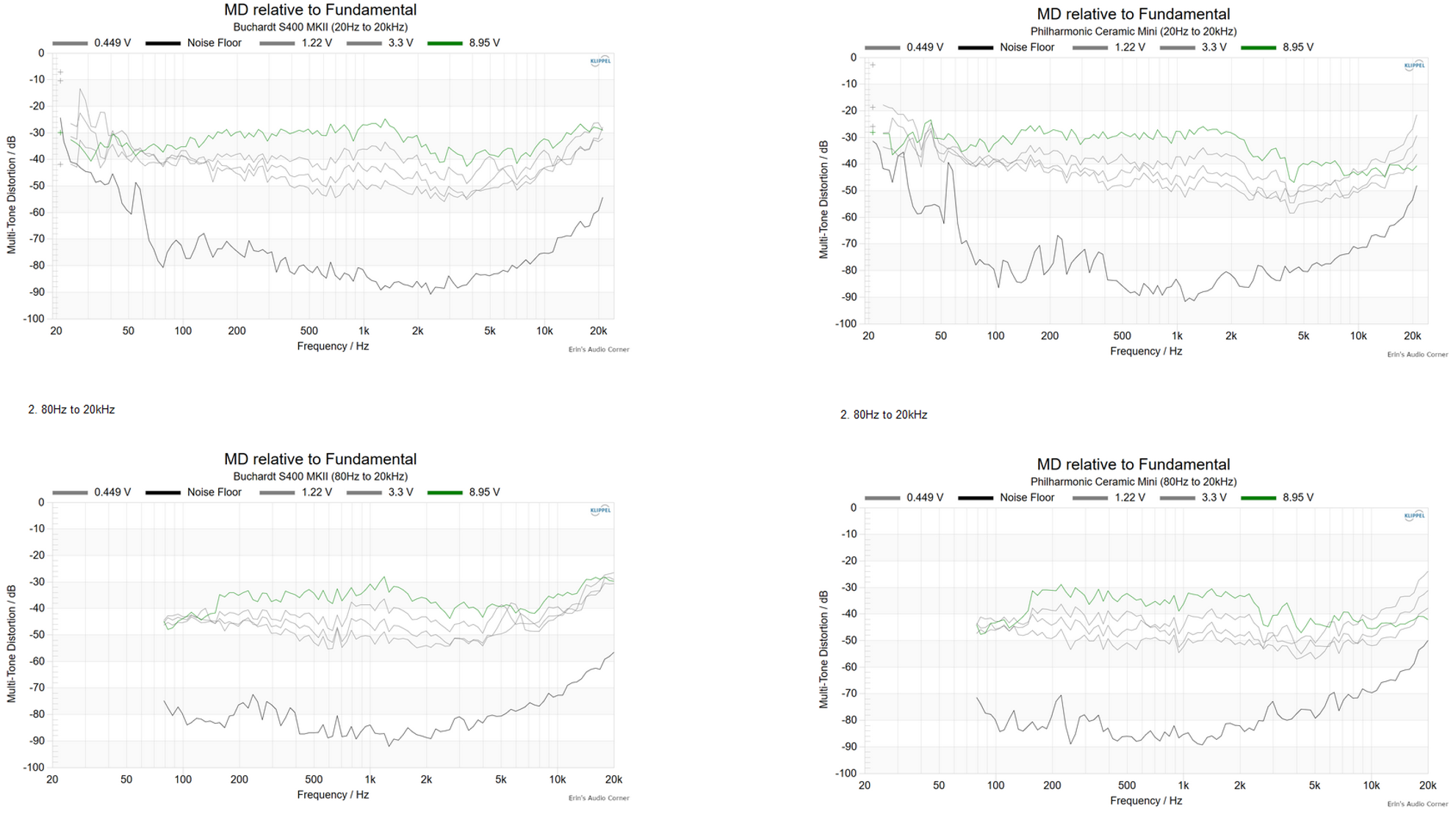

For reference, this is what a Buchardt S400ii and Philharmonic Ceramic Mini (SB26CDC) look like.
So for all use DIYers, if you want a coax, use it in a three way for best results....

I have an EQ plugin preset for the NS10's that's on the master buss which gets selected when i'm using them......mine are old and don't measure as wonky as those......and there wasn't much consistency in the NS 10's over the decades and models. Tissue paper over the tweeter?......lol
