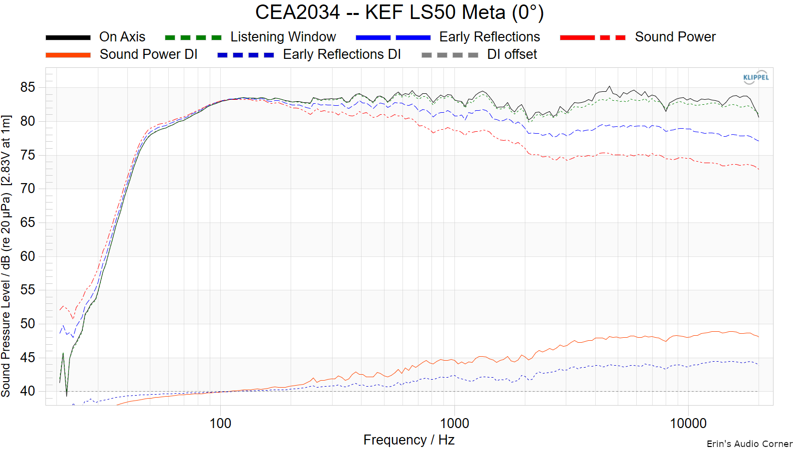

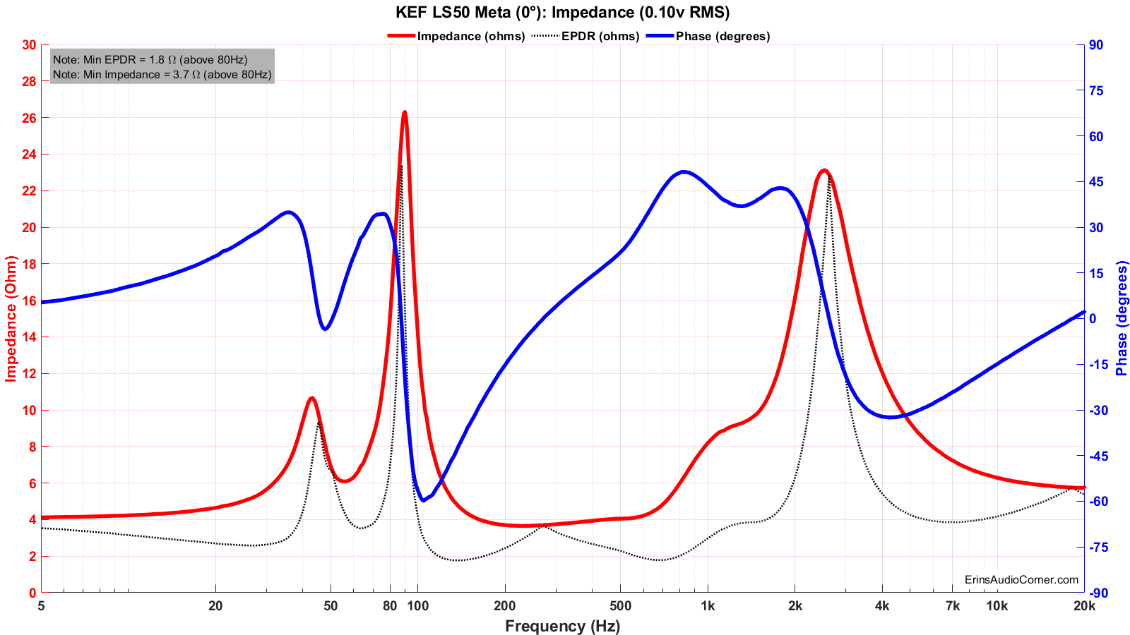

KEF Meta tweeters are nice in suppressing resonances and distortion, but refined xo is more important for sound. Direct comparison (DBLT) with eq'd responses would be conclusive. Eg. LS50 and LS50Meta have very different responses etc. measurements.
https://www.audiosciencereview.com/forum/index.php?threads/kef-ls50-bookshelf-speaker-review.11144/
https://www.erinsaudiocorner.com/loudspeakers/kef_ls50_meta/

I understood that the some of the pros with the KEF Meta tweeter, is that lower distortion allows for a lower cross over, which again makes a smoother and better power response. If I remember correctly, the Meta has around 5-600Hz lower cross over frequency. I cross my R3 none Meta coax at 2k with LR24... But I'm not sure how steep KEF cross?
Maybe mentioned before, but I guess one of the things with this Kef Meta Coax is a actual decent size back chamber for the tweeter. On top of that they can tune any way they want and then also lower peak around FS.

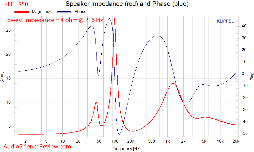

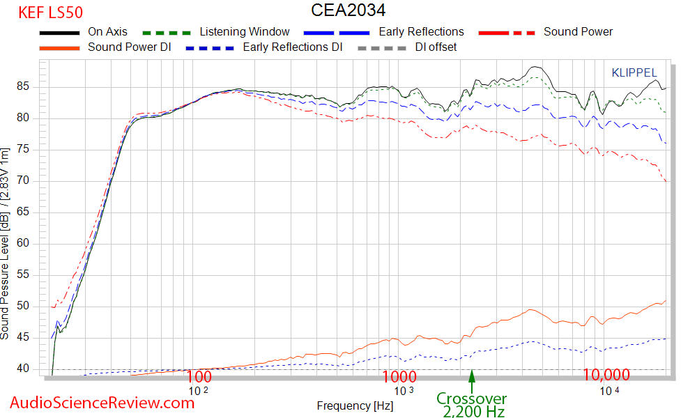

This is super interesting. I hadn't seen the original LS50 measurements before. This exhibits the peak-trough-peak tweeter response that is much more like a SEAS coax on axis, which then smooths out off axis. Which would mean KEF really only figured this part out more recently than I had thought. Afterall, the LS50 has the tangerine phase-shield / waveguide throat thing.Eg. LS50 and LS50Meta have very different responses etc. measurements.

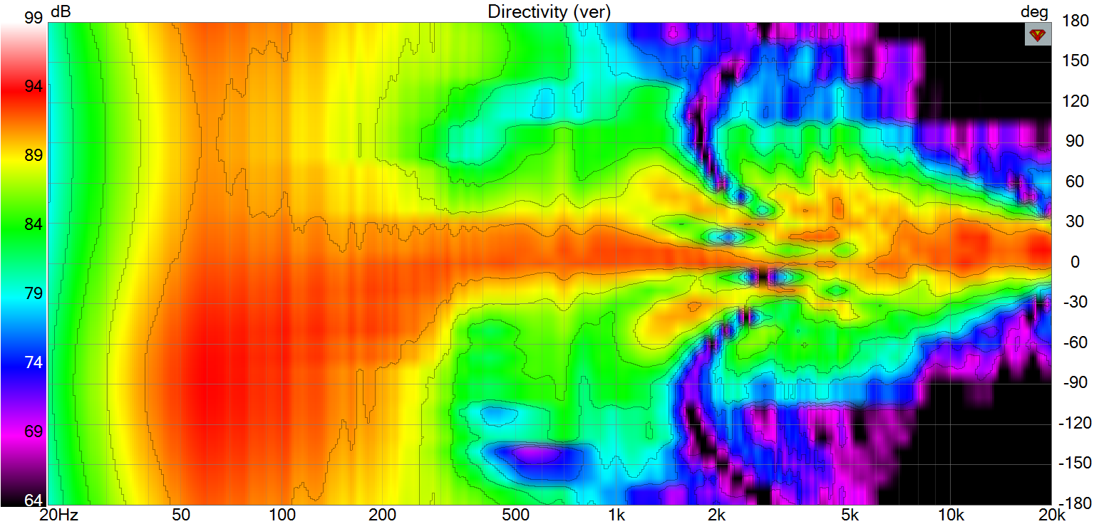

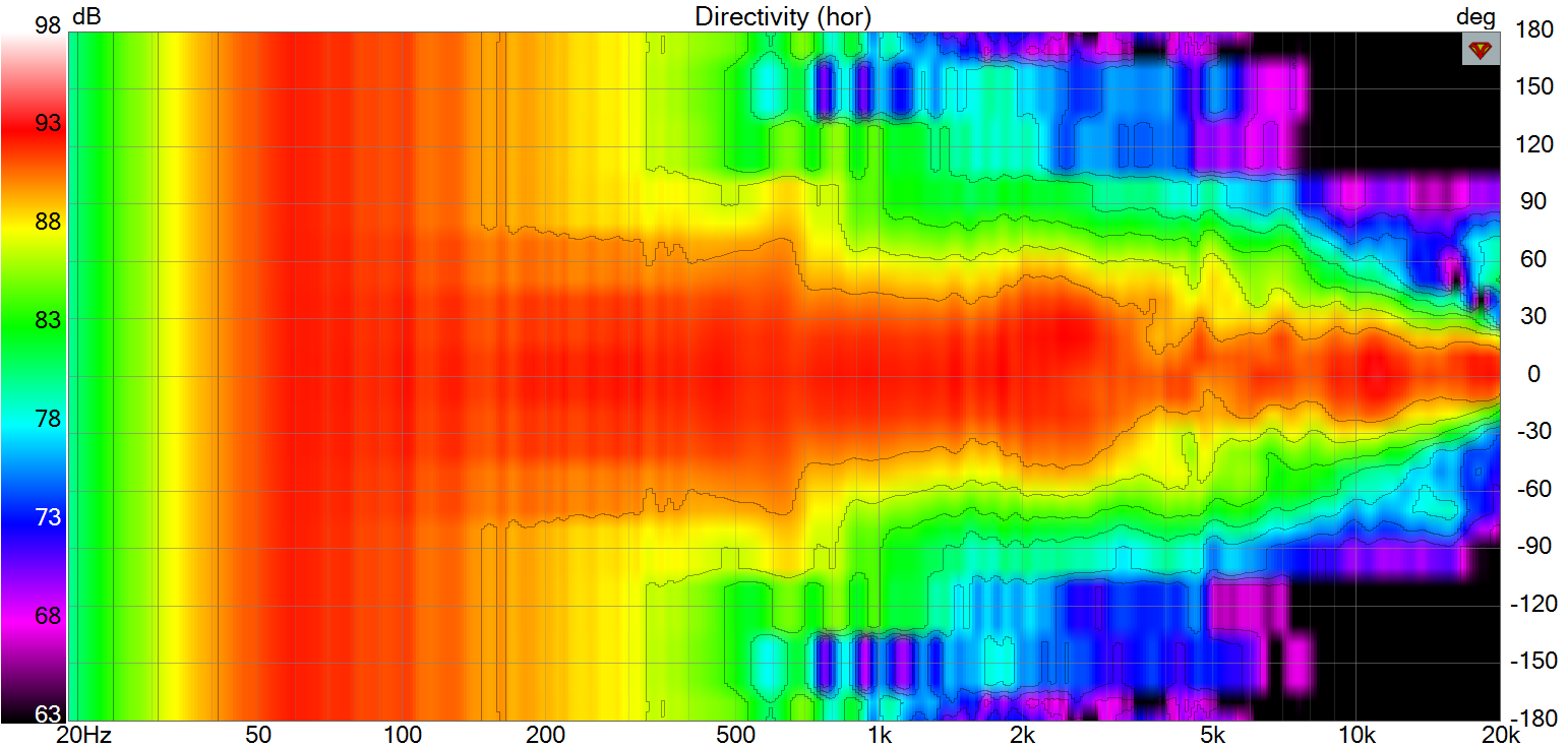

I've posted a small study comparing High, Medium and Low Frequency drivers in a variety of cabinets.
It's on another forum that allows me to edit/amend as more data becomes available.
First up, some pretty colors:
Edit: Feb 2025- Speaker colours explained;
SPEAKER 3...
Normalised:
SPEAKER 3:
3 way speaker with twin 12” woofers in 13.75" wide, MT cabinet 9.5" wide with 6” midrange + 1” ring radiator offset from centre, no roundovers,
2.83V input applied:
Reference...
