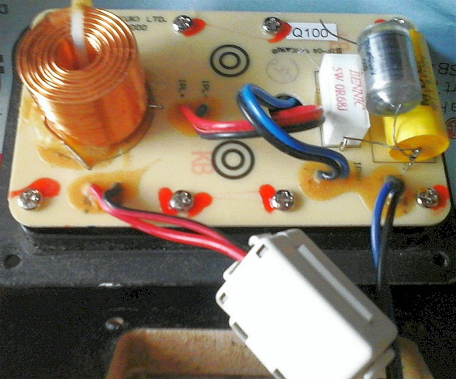

Why does it work? Crossover with RF ferrite (wires) and 10nF polystyrene (bypass)
I have a question to ALL.
Two years ago I had cheap tweaks with my KEF Q100 coaxial speaker. It was trial and error.
[comment]
[/comment]
attachment.php
1ª Why when I add a RF ferrite to the woofer wires I have more bass and faster?
2ª Why when I add a RF ferrite to the twitter wires I have more too much HF?
3ª Why do bypass with a small 10nF polystyrene the HF are less shrill and more pleasing despite being more detailed than before?
I have my hypothesis and I have read others but I still do not have it clear. Please, serious answers.

I did not even perform the capacitor as it can be seen in the photo, in case I had to desolder it! I had planned to change the original with a more expensive Jantzen Z-Cap because I did not think the bypass would have any effect. Being so cheap I did not hesitate to buy them and do the test and get out of doubt.

From the picture, I can see that the ferrite is a common-mode type, which means its effects on the differential frequency response amount to zilch, nix, zero, nada, and it would have the same effect if it was simply placed on the top of the cabinet.
Common-mode effect can be excluded too, because the drivers are completely passive and have a low capacitance/coupling wrt. their surroundings
Administrator
Joined 2007
Running a single speaker wire (the + lead for example) through an 'RF Ferrite' (do you mean a bead ?) can cause actually cause severe distortion, distortion that is easily visible on a scope. Once the ferrite saturates, the distortion sets in.
Just to clarify that a bit more, I suspect a lot also depends on the material of the conductor running through the bead. I speak from experience here... this has actually happened to me.
