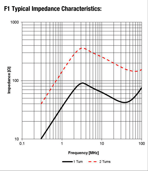

Thank you. The problem is the woofer only works few kHz, until 2.2 kHz. That ferrite begins to be effective from 150 kHz (unlike the usual cheap ones, 1 Mhz).
With the tweeter (first order filter) causes an unpleasant increase in treble.
Maybe I'm not reading it correctly but figure 10 in the paper shows an increase in distortion of almost 30db at 1KHz.
The ferrite bead works great at suppressing the switching frequency up at 150KHz but it also causes a lot of distortion down in the audio band.
True, ferrite beads are much smaller than what you are using but still......
Now the graph is different!

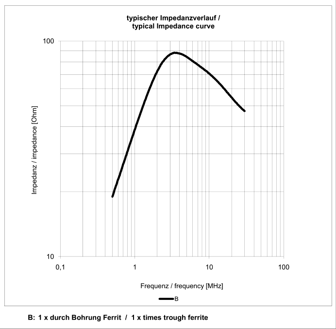

https://uk.farnell.com/wurth-elektronik/74272733/ferrite-core-split-8mm-30mhz/dp/1800423
[PDF] http://www.farnell.com/datasheets/1919956.pdf
Well, there are more info > 30 MHz.
