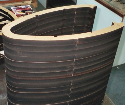

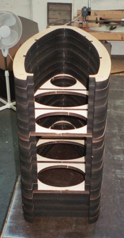

Hello all,
I thought I'd post a couple of pics of the cabinets so far. I've got to order another sheet of mdf to finish the top/bottom and baffle.
The mock up shows the front to back bracing in-situ but not the top to bottom (side-side) ones which locate through the other braces, and in the slots in the sides.
To fill in all progress:
1 cyrus 1 amp on its way, second is bidding on e-bay at the moment.
Still looking for the bass amps.
About to start buying the components for the active x/o - will be esp linkwitz reilly boards (already bought 'em)
I'll probably use these untill Mr Pass releases his discrete x/o's
Am going to start gluing cabinets this coming week - back to work on Monday.
Cheers
Rob
Pic 1:

fantastic photos. you are layering the MDf differently than me. you are using horzontal layers i am using vertical layers. you need more cut and joints I need ot bend MDF and so can only use 4mm MDF. to make the box stronger I am alternating 4mm MDF with 4mm ply 3 layers of each total 24mm. i will post pictures when there is progress. i got delayed due to a bout of typhoid.
