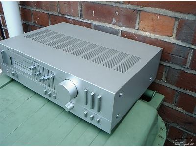

I've got an old jvc ax-2 intergrated sitting under my table here, but I'm pretty sure it is way too bad to use with these speakers!
Some of these are sleepers. Try it. Even if it isn't state of the art it gets you going. (i will admit that over here JVC is considered a TLA for Junk Very Cheap even thou they do build some good stuff -- pro video in particular)

""Some of these are sleepers. Try it. Even if it isn't state of the art it gets you going.""
No, I used this after my cyrus 2 died on, and even my wife who does'nt care about hifi noticed the drop in quality.

Check out this amp::D
Did you use it just as a power-amp or with all that junk in the pre-amp in the path? Can you easily get at just the power-amp?

Dave - the jvc does'nt look too hard to "mod"- looks like all the "junk"stuff sits before the volume pot, so I can rip it all out (the pot is noisy anyway) and just have 1 input -> pot-> input on pcb for it. There are 2 big caps which are leaking, so I'll need to replace them aswell.(56V 8700uF)
the transistors are toshiba - 2 x 2SB755 2x2SD845
That should work. The big caps are the PS filter caps.

""The big caps are the PS filter caps.""
Any brand names I should look out for when replacing?
There are a few elna caps in there, but most don't seem branded....
I'm not an expert in these things, but the heatsink is huge compared to the transistors - the amp is meant to be "super A" but I cant believe it could be class A. However the back plate says it draws 400watts,and the peak output (according to the flashing led's ) says 80 watts. Is that like 20 RMS? If so this could be worth a tweak or two.
Before I owned it my brother in law had it running a massive pair of wharfdales - 'bout 5 drivers per cab (same size as under the counter fridges!) and I always remember the bass being really tight....maybe it was dying before I got it?
Probably biased heavily in AB.
the back plate says it draws 400watts, and the peak output (according to the flashing led's ) says 80 watts. Is that like 20 RMS?
What color is the 80 w LED? 56V on the PS caps would tend to allow a guesstimate of 45-50V rails. Could be rated at 80W RMS
If you can see them leaking now, Yes. Start by just finding some computer grade PS caps of the appropriate voltage & about the same size & value - maybe a bit bigger. If you find it has some worth then you can invest in better parts later.

""What color is the 80 w LED? 56V on the PS caps would tend to allow a guesstimate of 45-50V rails. Could be rated at 80W RMS""
the led's are all green.... The meter thing says peak power above it, and has a Db dcale from infinity to +4Db, with 0 - 80 watts/8 ohm ..... pretty sure its less than 80w rms....
I'll have a look for caps tomorrow - d'ya reckon I'll have to re-bias the amp (its got a pair of plastic pots which I'm assuming are the bias pots.....)
