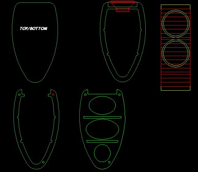

RobWells said:Heres a couple of grabs from my cad at work: [/B]
WOW! What a gorgeous shape!
Can't wait to see real world pics. Is the top going to be flat or have a sensuous shape to match?
dave
Not very exciting really
the bottom left is the sections behind where the speakers will be, the other unfinished layer - the one with speaker drawn on - will be joined across the front behind the baffle. to stiffen the front. The other bit is the brace - the 2 rectangles are where the side to side bracing slides down - it fits in the notches on all layers.
The front view is just to show where the drivers will be with regard to the layers...
I hope this makes some sense...
Cheers
Rob

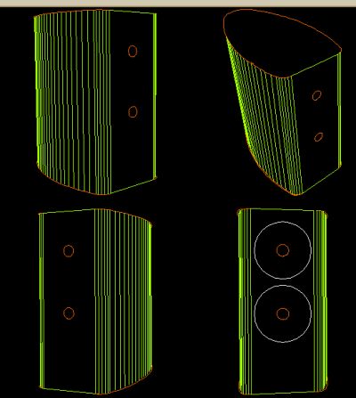

Thanx to Nick at work for knocking up this 3d image in his lunch break for me - and putting up with me arsing up his settings on his workstation when he's not looking😱
Cheers
Rob
Cheers
Rob
Thanx for the support, Navin / Dave !
Of course you can steal them, Navin....
The mid enclosure will be a long (4-500mm) cylinder going from 6.5 inches to 8.5 inches to 6.5 again - The driver will have no baffle as such, just a chamfer from the edge of the driver backwards.
The tweeter will be above in a small ball type (if I can get it machined right) enclosure, again with no baffle as such..
I've got black american walnut veneer for the main cabs, and am piano laquering (black) the mid/tweets and the top and bottom slice.
The front baffle on the main cab is going top to bottom, and I'm going for mottled black leather to cover this...
I think this covers most bits...
Rob
Rob

Navin - the easiest way to get that curve is:
draw a line the width of you front baffle(300ish)
offset another line the depth of your speaker(700ish)
shorten the second line to the diameter of the back curve (200ish)
link each end to make a parrallelogram (sp?)
use a "bow" command to drag the sides to your preferred shape.
Thats how I done it!
To measure the volume , Nick suggested drawing a crosshatch of 1cm squares and dropping a "symbol" into each whole square.Then using the system to give a total of the symbols.( any part squares were ignored, allowing a bit of leeway with the size)
counted volume is 115L + all them little bits. As no port is being used I dont need an exact figure as such...Also ignored the holes cut into the bracing....
Rob
