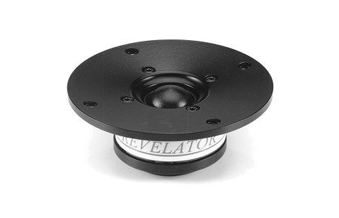

Still keeping this thread alive! Dave, I downloaded the baffle spreadsheet, but it seems to only do triange, quadrangle etc, no circular stuff. I think I'm going to make the enclosures for the big tweeter (sorry, but I cant bring myself to hack nearly £300 worth of tweeters up!) into some sort of teardrop or elipsoid shaped thing ie the front plate will look egg like from the front, with the baffle curving away and outwards from the front back. I'll post a shaky mouse drawn pic in a moment..(tried to draw this freehand, but so terrible that I'll wait till tomorrow and do it on cad at work....)
This will make all baffle edges different distance from tweeter, and give a big radius edge aswell..
btw, the tweeter dome is inset into a 'horn' or radius edged hole, and the face plate is concave. - Surely this must have been designed to help?😕 - wouldnt the baffle edge be the outside of the hole its set into?, followed by a series of other reflections on the "real" baffle?
Am I babbling?😀
Cheers
Rob

RobWells said:but it seems to only do triange, quadrangle etc, no circular stuff. I think I'm going to make the enclosures for the big tweeter
Can you approximate it with a many-sided polygon. Just keep in mind that the circle with the radiator in the middle is worst case.
Can you point me to a picture. It might be possible to rear mount the tweeter and have the enclosure/pod "flow" out from the recessed part.
dave
RobWells said:That sounds good - heres a pic:
Weird shape, looks like flush mount into your baffle-let, with perhaps a little woolfelt star.
btw: posted a small package of BAF yesterday..
the mystery will be over soon :^)
dave

RobWells said:perhaps a little woolfelt star
Any objections to mottled leather rather than woolfelt? - I'm pretty into aesthetics (I hope I spelled that right😀 )
The purpose of the woolfelt is to absorb any surface waves before they get to the edge to diffract. This can be stiffened on the back and used as a grill frame.

RobWells said:'fraid not, how thick is the felt? - I'm pretty sure I can sort something out...
It is kind of hard to make out but the cut edges of the star are beveled back ~ 45 degrees so that there are no fixed distances anywhere. The felt is a 1/2" thick. Odd number of points -- 13 in this case (its primeness may or may not be important).
