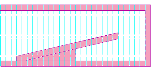

like this,
dave
Ok!,Thanks Dave
I'll keep the 4:1 ratio of the start/end.

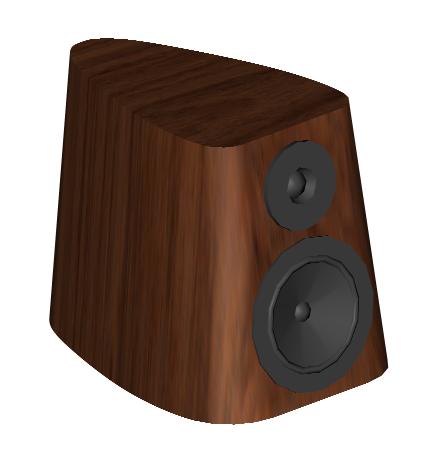

Alternative mid/tweeter cabinet
Hi Rob
It sounds like you're fairly sold on the idea of a TL mid enclosure, but here is another alternative. Its a design I may use for the next part of my project, depending on the type of mid driver I go for.
This design could be made using MDF profiles like you have been using, but cut on a 6 degree angle all the way around. This would be done with a jig saw or alternatively you could laser cut oversize and then put the angle on with a router.
The drawing is done using Acad V14, which has limited 3D capabilities. The mid driver is drawn as a 150mm unit, with the cabinet being 250 high, x 220 wide and 330 Deep. The approximate internal volume is 6-7 litres, however you could easily scale the thing up for greater volume.
BTW The nice finish is teak - easy to do on a CAD system, but probably too difficult for a shape like this. Maybe the front panel could be veneered only.
Mick

Well with those tools it might be difficult Navin. You wouldn't need a hammer, but it you could trade in for a jig saw you'd almost have everything you'd need. Whatever design you build you'd need a jig saw or router to cut the driver holes in the front baffle. If you were really on a budget you might do it all with a coping saw, but that would be a great labour of love. Smoothing of the outside shape would be easiest with a belt sander, but with a bit more effort a sanding block could be used. Of course you'd also need some clamps to hold the layers together during glueing.
Something that I didn't mention above, is that this construction technique would allow you to build in a shelf type brace, driver support, or what ever other internal features that you wanted without extra joinery. Just cut them out of what ever horizontal layer you choose. In many ways this construction technique would be easier than building a box, as the joinery is just gluing flat surfaces together.
Mick

Kanga, the mid you.ve drawn is similar to the watt/puppy speaker, and I did consider using the tilted baffle. The only prob is ensuring the time alignment. With seperate enclosures you can move them individually, and bolt in place when bang on (hopefully:) )
Navin, I'm sure you could achieve a layered enclosure using a jigsaw or router. Some jigsaws you can adjust the angle of the cut I believe. Very useful..
