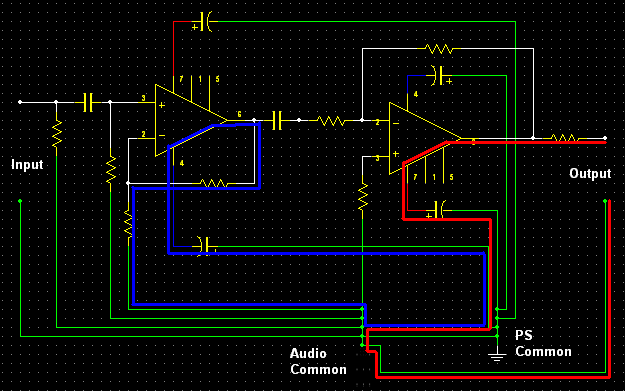

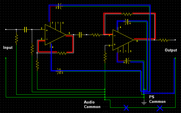

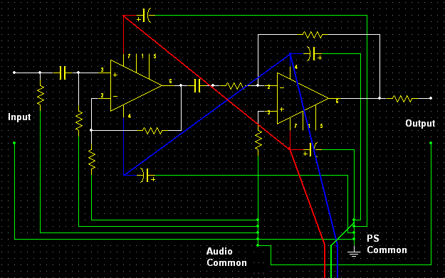

Loop area and Power routing are not the only problems. Inductance is also a problem that should be identified. Feedback loops and bypass capacitors must have short traces to the opamps and ground. The datasheets give plenty of info on this. This part of the layout is critical for stability and low distortion of the circuit.
Schematic 1: Loops
Schematic 2: Power connections
Schematic 3: parasitics/inductance

My screenies that are being used are from here in Post # 28 http://www.diyaudio.com/forums/anal...anding-source-return-current-flow-pcbs-3.html
That's what i showed in the above screenie !

. . . Now you know why I put a 22 Ohm resistor in series with the decoupling cap in each opamp supply rail in my preamps. The resistors and decouple caps are located right at the opamps, and I use a dedicated 'dirty' ground return.
