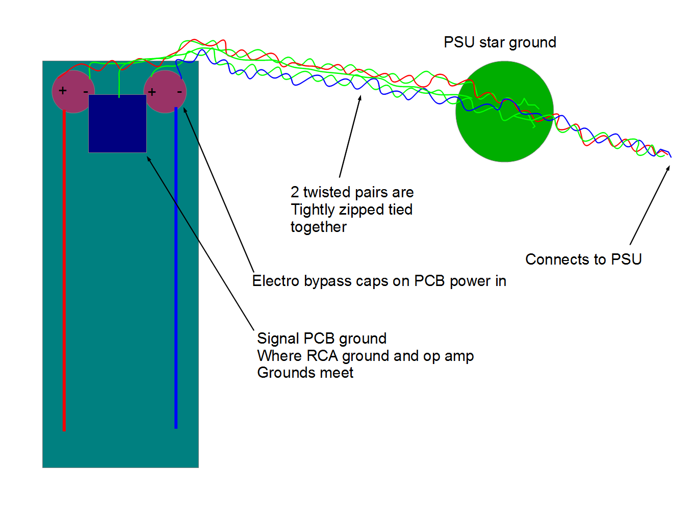

I don't know what you have described.The op amps power pin's bypass caps are traveling back to the star ground near the PSU and away from the signal ground point.
Can you post a drawing and/or a pic?
I used a kind of power buss to jump off of to feed the op amps. This shows how I wired the electrolytic bypass caps for the power coming into the board. The ground connection to each capacitor goes back to the higher current PSU ground point instead of the signal ground on the PCB. I didn't show the ceramics on the op amps because this program I use to draw things makes me want to kick a hole in the wall.
I don't think that is an effective way to couple the local decoupling.
The Ceramics are the High Frequency (HF) decoupling they supply current for typically 1us transient demand. They must be connected to the opamp supply pins as close to the package as physically possible.
They then need to be connected together to create a local HF Decoupling Ground. These last two connections must be just as short as the pin connections. It's the LOOP length and LOOP AREA that must be kept very small.
The small electrolytics are the Medium Frequency (MF) decoupling. These should be fairly close to the package pins but because they supply the MF they will tolerate longer Loops than the HF. BUT !!!!! the cap to cap length MUST be just as short as the power side connections. NOT back to a remote star ground.
Connect the two electrolytics together to create an MF local decoupling ground.
Connect the MF Decoupling Ground to the HF Decoupling Ground using a short direct wire/trace. This wire trace is the PCB Power Ground. Any Fast (HF) current returning from the load or from the Zobel should be brought back to this low impedance trace/wire.

Consider the Zobel. It is a load on the output and any current flowing through it must return to the Power Ground. Which Power Ground?
The Zobel ONLY passes HF signals, the ~100nF ensures this is so. It does not pass Audio Signals.
HF signals must return to a low impedance ground. They will not tolerate a long open loop (high impedance due to inductance). I see the only place to return the Zobel currents is to the low impedance local Decoupling Ground. The short wire between the HF and MF decoupling grounds is in my view the ideal location. The returning current arrives at the short HF to MF wire/trace and has a choice of routes, either the to HF side, or to the MF side. The two routes are effectively in parallel.
As I see it, the chipamp/opamp/poweramp must have a local decoupling ground.

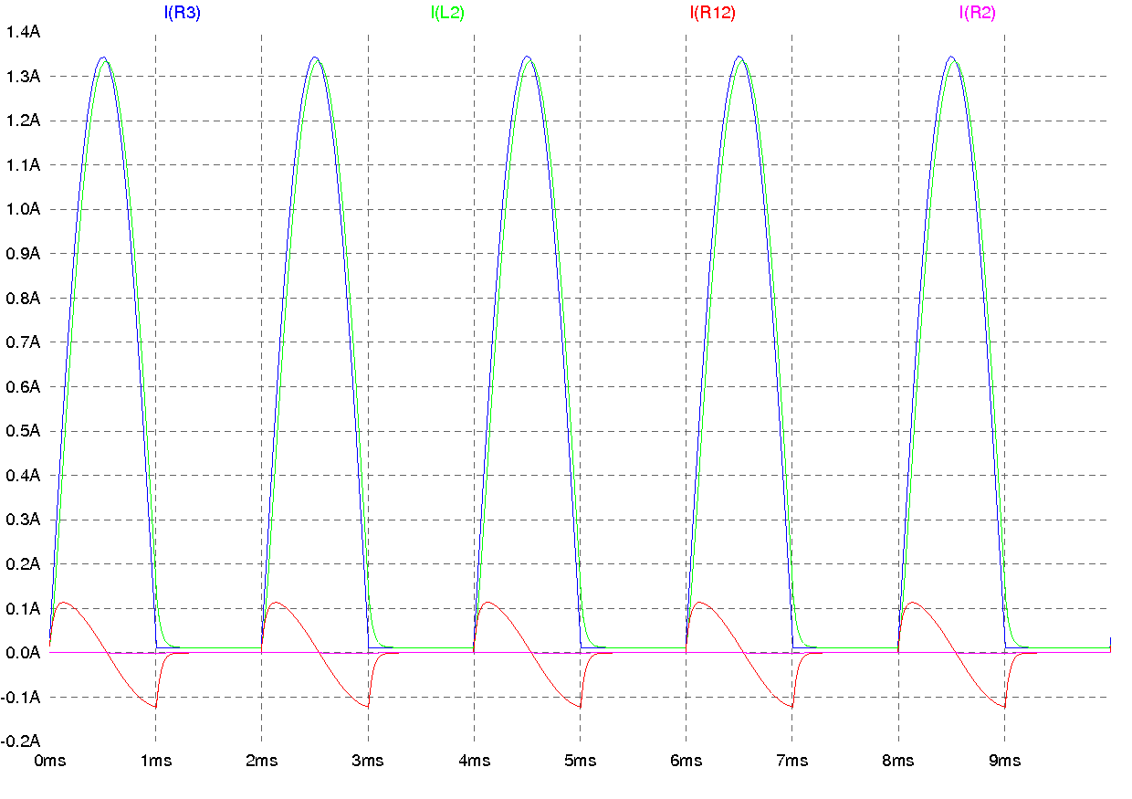

During the recharge of the HF caps the HF and MF caps form a current loop. The sum of the inductance of the loop is what is important. The inductance of one HF cap, one MF cap and the two traces connecting them.
Here you can see the positive opamp, PSU, MF and HF currents.

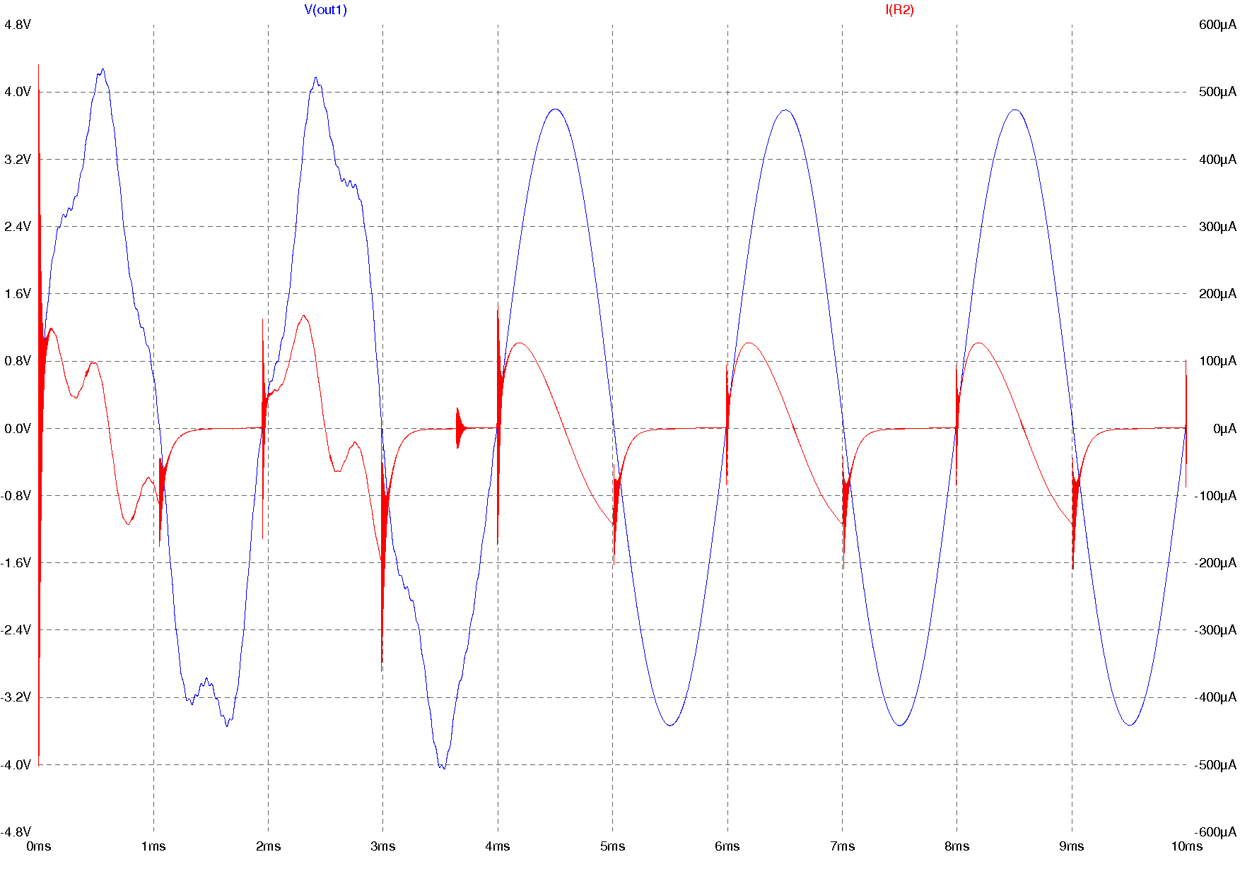

I can't see where my logic is flawed nor where your question is directing my thoughts/tests/simulations/modeling.what you have not considered is the current flow from the MF caps to the HF caps and the current flow from the PSU to the MF caps.
There are more loops than you may expect.
The two pairs of capacitors already have the shortest route lengths and PCBs only have multi-layering to help with the non twisted technique of lowering impedance.
One cannot twist the traces and one cannot bring the routes any closer together.
What this does bring out is that small components can be much closer together and that this has a direct effect on impedance.
I don't see the advantage of connecting the two HF caps together forming a separate ground.
It is +CLC- with AC current flowing +CL GND and GND LC-, there is almost no current flowing +CC-
I(R3) is the current entering the chip from the positive rail.
I(L2) is the current from the PSU.
I(R1) is the current though MF cap to the positive rial.
I(R2) is the current though HF cap to the positive rail, relatively small.

I don't agree with this. In simulations I have increased the inductance at the PSU to see the amp's HF caps oscillate.
Here a plot of the output voltage and the current of the positive HF cap with a slightly high inductance in the supply and ground rails from the PSU.
The small decoupling caps next to the ICs form a small loop for the instantaneous power requirements, then as Andrew points out there is another loop where any reservoir caps (MF decoupling) supply the HF (local decoupling) caps, and so on back to the main power supply....having the local decouplers (HF) caps ground connection go all the way back to the main PSU minimises their effectiveness as the added inductance (the killer for local caps). What I am saying is look at the local small loops, staring everything back to some distant point just adds inductance.
As I said all low level (and higher current) analogue I see uses a ground plane (high power currents get there own, and often there is a separate input ground to form an EMC moat connected at a star point) with generally a power connector for external power of a PSU on board.
So we concentrate on keeping the various inter circuitry loops as small and neat as possible, using placement and routing to minimise any interference between areas of circuitry........
