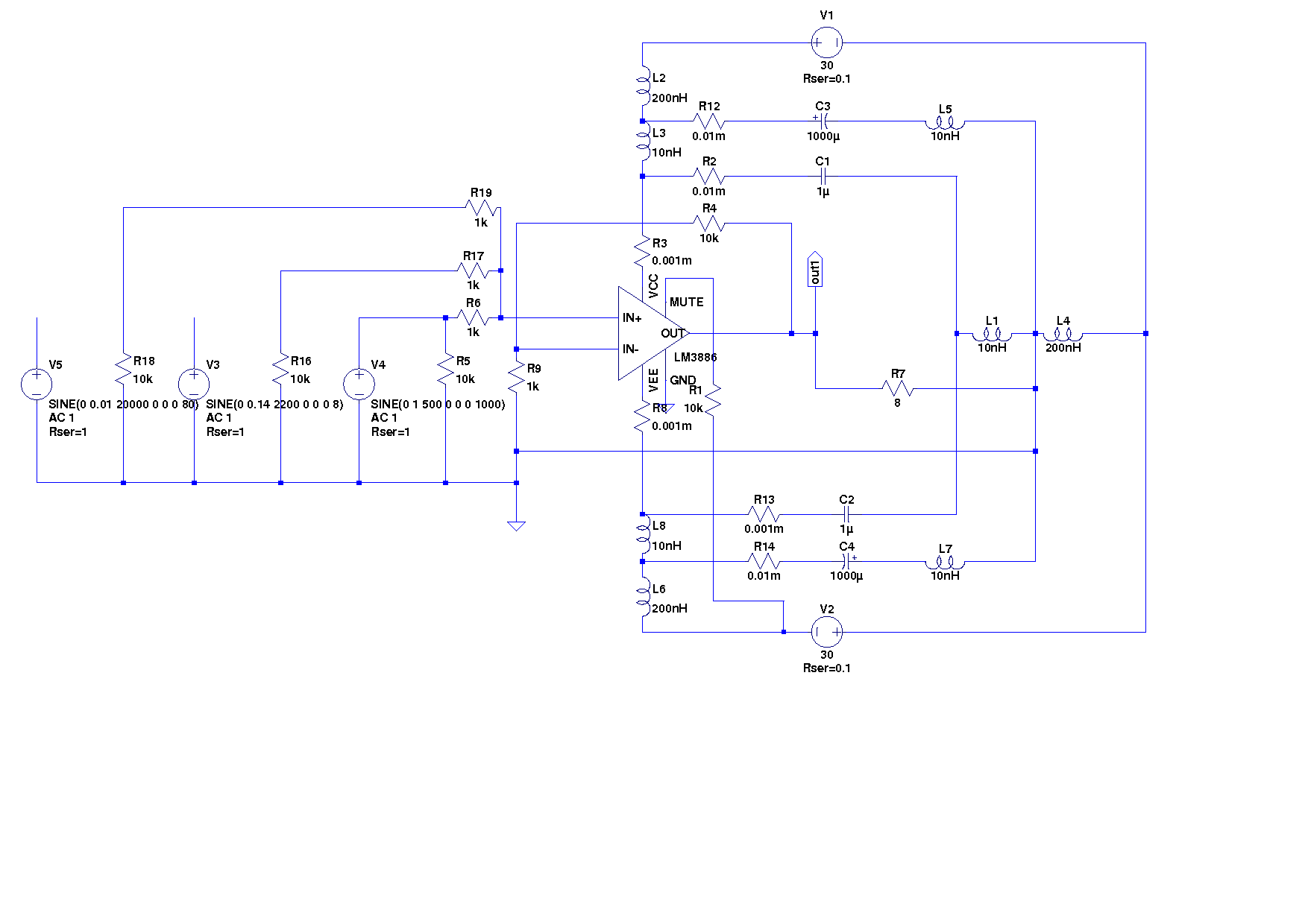

I sketched out the HF to HF (very short loops) with the longer loops for MF to MF and added in the Zobel.
Compared this to what I think you are describing for HF to MF and HF to MF then both to a common ground and added the same Zobel.
In the second sketch it is very clear that the loops for the HF must be longer than in the HF to HF case.
I still think the priority should be to minimise the loop length of the two HF routes.

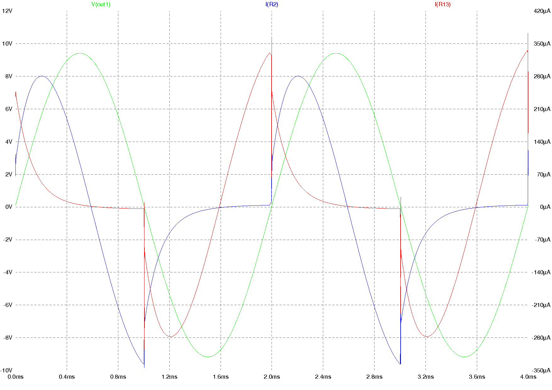

You posted a sim plot. Could you post the diagram that you used for this and explain what the various traces show.
I would like to compare the HF to HF version to the HF to MF version to see if the sim can differentiate between them.
For HF to HF current, there must be a positive and a negative current at the same time. (The blue above 0 and the red below 0.) as you can see this never happens.
You can also see a 90 degree phase shift of the total HF current relative to the output signal.

I note in your sim sch that HF decoupling has been omitted.
100nF is commonly used.
1mm leads are possible.
That results in 1nH of inductance on both sides of the HF capacitor
MF decoupling typically has leads of the order of 10mm to 30mm length. That would result in a typical inductance on BOTH sides of the MF decoupling of ~20nH.
Could you post the asc so that I can insert these?

I have been working with Mark's asc for the past few hours trying to understand how the decoupling behaves with very fast signals.
I did see a strong second harmonic on the HF cap current. I suspect this is ringing due to insufficient damping with the very low resistances in there. I increased them by a few decades to reduce the 2nd harmonic.
I will post my modified version of the HF to HF version as soon as I discover how to get it into an attachment.
How do I replace the sinewave test signals with fast pulses of one or two pulses duration?
I would like to see the sim modeling for that?
I have converted the sim to HF to MF and will start analysing that to see if it gives different results.

I have disconnected the 500Hz signal and connected the 20kHz signal
Changed that to 500kHz or 800kHz or 1Mhz
added in parasitic inductances around every capacitor.
added main smoothing capacitors.
Changed the 3886 to lt1037 since I knew that was fairly fast and was not unity gain stable (similar to 3886 but faster)
added a Zobel and increased the speaker load to 1k.
added L25, 26 & 27 to simulate internal lead in wiring inside the chipamp package.
After seeing the strong 2nd harmonic on the HF decoupling cap I have increased substantially the parasitic resistances.
I did a lot of zooming in to see details of the voltage and current waveforms.

I have relabeled many of the resistors/inductors to indicate their function when looking at the plots after "run".
I+hf = the +ve polarity current through the resistor leading from the HF decoupling capacitor. It reverses into a -ve current when recharging.
I+opamp = the +ve polarity current into the opamp +ve lead.
I+supply = current from the voltage source that simulates the rectified AC from the transformer.
I-mf = the -ve polarity current from the MF decoupling.
One important lesson.
Even though the voltage source is the main current source for the amplifier, I can see the VERY small variation in current from here. It operates as almost a perfect DC constant current supply.
The Main Smoothing capacitors have small current variation that is in phase with the MF decoupling cap current, but again the variation is very small. There is not much AC demand on the Main Smoothing.
I.e. the PSU is a DC supply with very little transient requirement when the decoupling can cope with the demand from very fast transients.
If one puts back in the 500Hz signal and looks again at the Main Smoothing current, one sees the "slow" demand being met by the "slow" capacitors. The decoupling exhausts itself too quickly to have any significant effect on maintaining near constant voltage on the supply pins when the currents CHANGE SLOWLY.
AndrewT, Did you have fun?
The parts used are real parts and not tweaked to remove ringing. I want to simulate an actual PSU with real AC current demand to see what is happening. The three AC supplies are an attempt at simulating an audio signal.
I had previously used AC supplies and diodes as a supply but they prevented AC analysis (loop gain e.t.c).
I don't think you can call it "Exhausts". it is a small local lowering of the voltage at the HF capacitors which later forces the other caps to take over. This also explains the recharge.
The zobel is causing a much lower impedance at HF. This increases the HF current demand compared to the LF demand.
